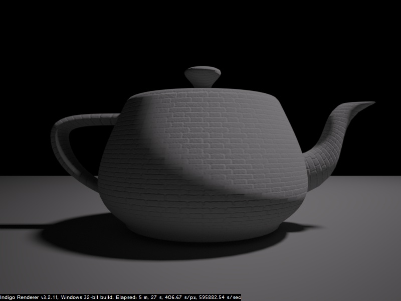

Post by OnoSendai » Fri Apr 20, 2012 10:44 am
Here you go dcm, just for you :)
Preliminary normal map support has been implemented (see image)
Etienne:
The standard basis for normal mapping seems to be something like:
* Take dp/ds (where p is the surface position, and s is the first texture coordinate)
* remove components in the direction of the shading normal N_s
* normalise. This forms the i vector of the basis.
Likewise for dp/dt to form j
N_s is used for k.
Note that this is not necessarily an orthogonal basis, if dp/ds and dp/dt are not orthogonal.
