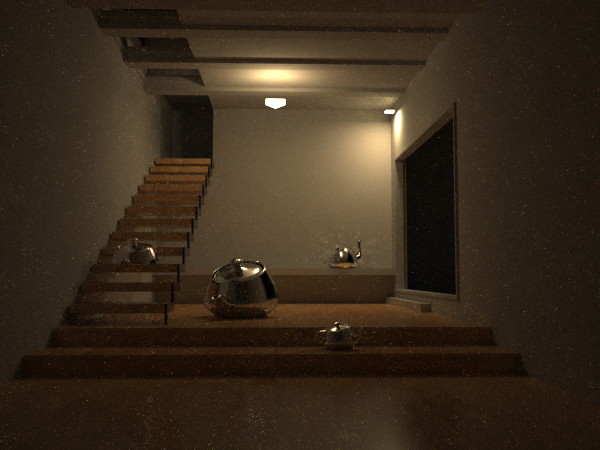

OK, so today I have managed to implement (erm, copy from c++ ;) ) XYZ->RGB conversion with whitepoint settings, Linear tonemapping (buggy) and Reinhard tonemapping.
There's something wrong with my Lienar tonemapping though because my image is brighter than it should be.
jViolet Linear tonemapping
jV - linear(-0.5, 1.2).png (509.09 KiB) Viewed 3718 times
C++ Violet Reinhard tonemapping
cV - reinh(-1.0,1.0,4.5).png (412.9 KiB) Viewed 3718 times
jViolet Reinhard tonemapping
jV - reinh(-1.0,1.0,4.5).png (545.17 KiB) Viewed 3718 times
C++ Violet, Linear tonemapping
cV - linear(-0.5, 1.2).png (338.27 KiB) Viewed 3719 times
