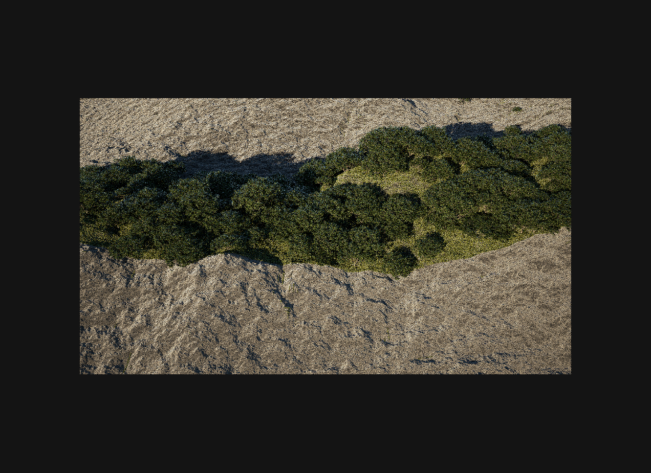

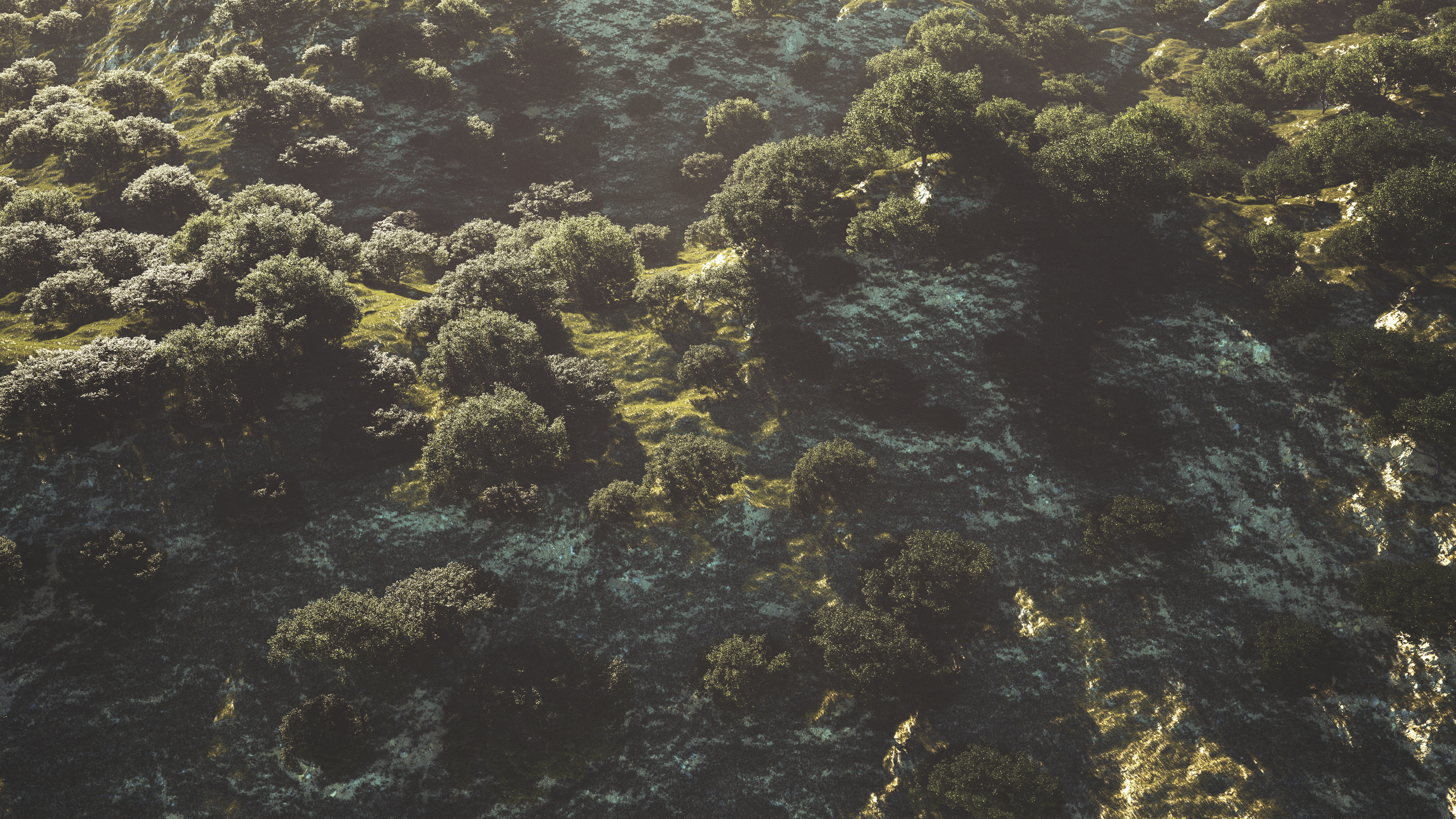

8.25 millions of instances.
Works well, thank you Ono!
Hello wob.
Here is an old example pigs by Ono that contains the scatter function.
Actually there is no possibbility of use inside Cinema. ATM only Skindigo has implemented the scatter function.
You must setup the scatters in XML. Noticed that the meshes to be scattered requires the "mesh UID" and the target object requires the "object UID".
scatter_material_test.pigs
(983.88 KiB) Downloaded 522 times
If Cindigo must write 8.25 millions of instances in the igs... you need hours of exportation. Indigo´s scatter put the instances directly in scene...
Hope that it will be implemented inside Cindigo someday.

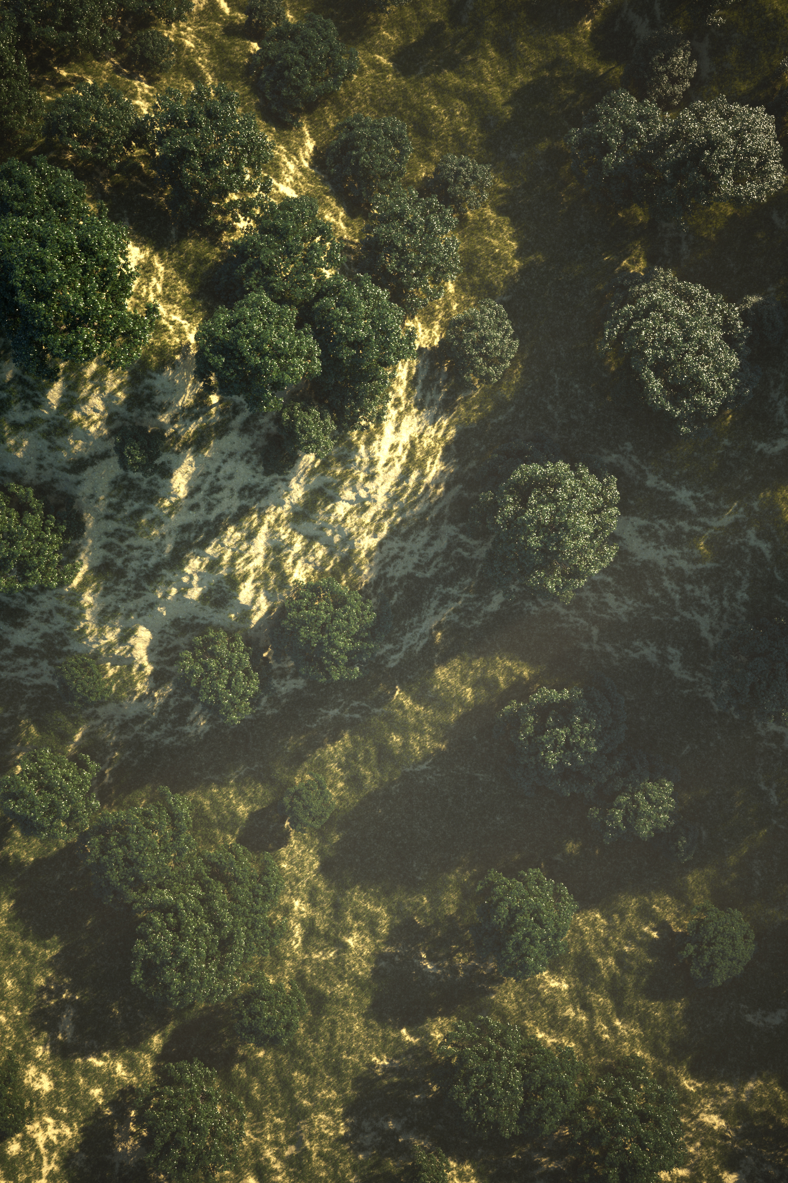

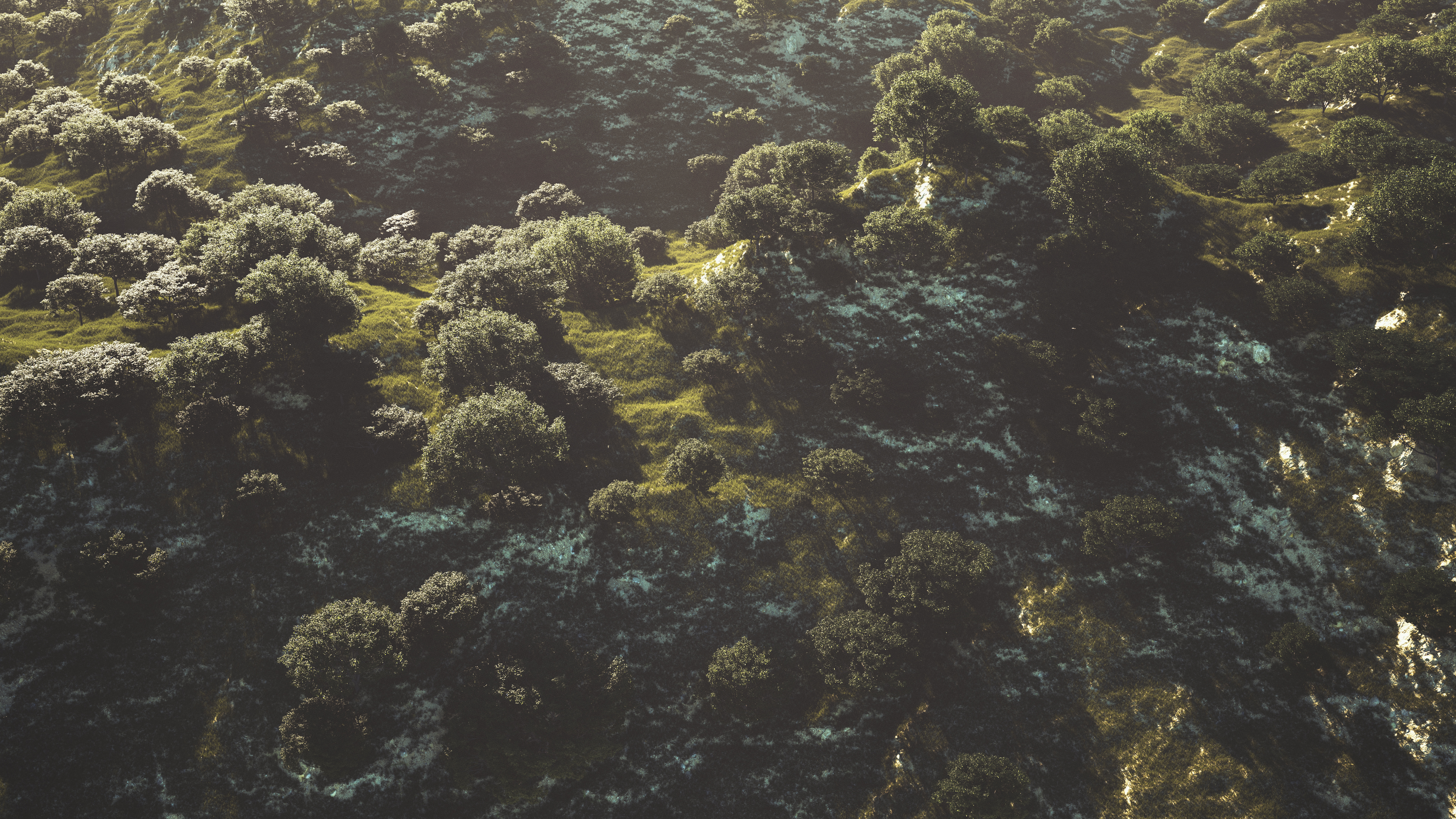

20 million. Scale of grass X2.
Corrections in 16 bit, without LUTs.
wob, wait for the update in the exporters for animations, it has been announced.
Ono, a bug with subdivision and scatters; more than 3 subdivisions produces this...

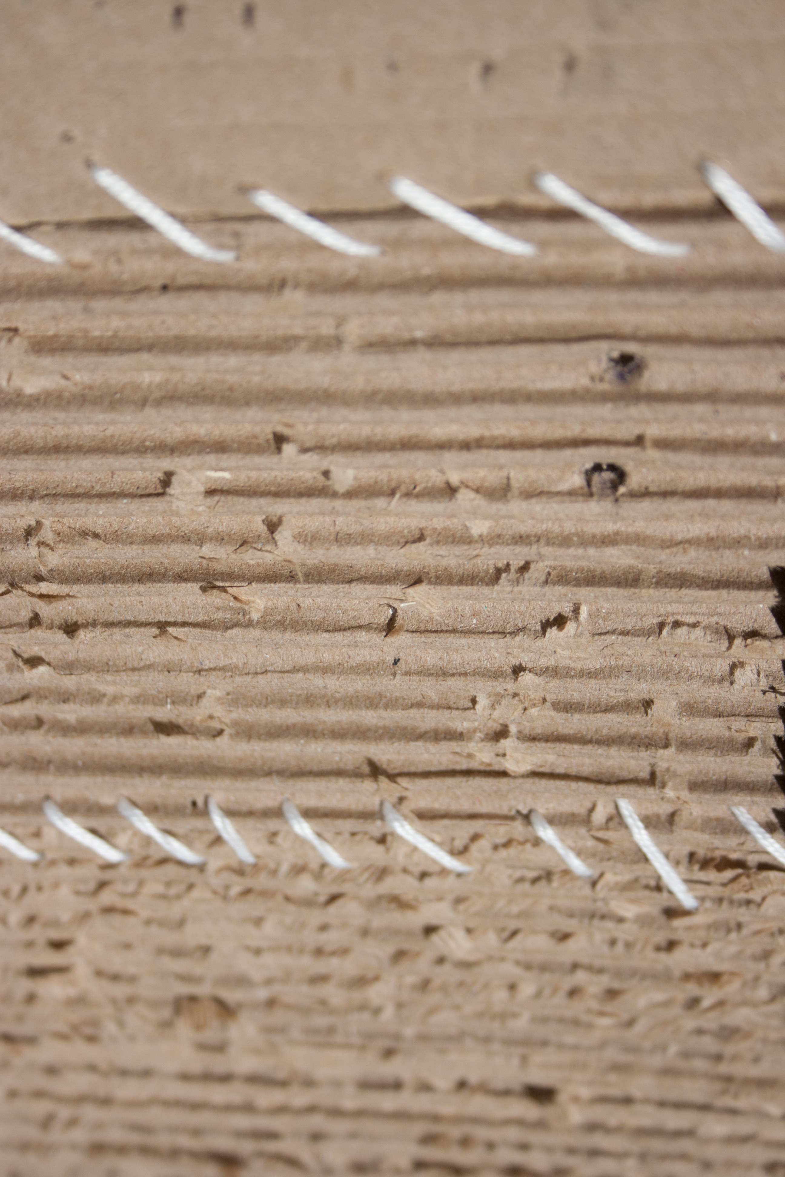

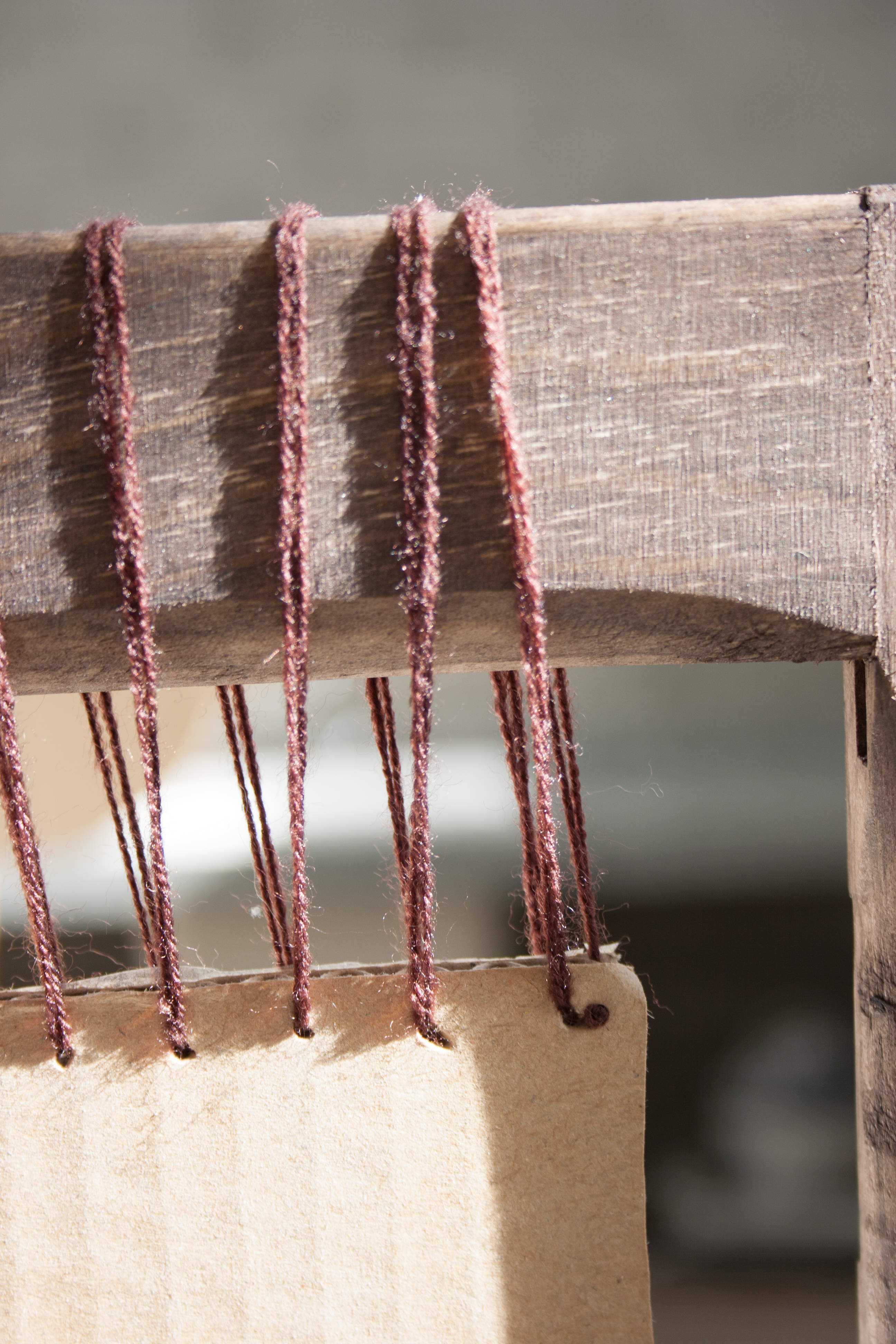

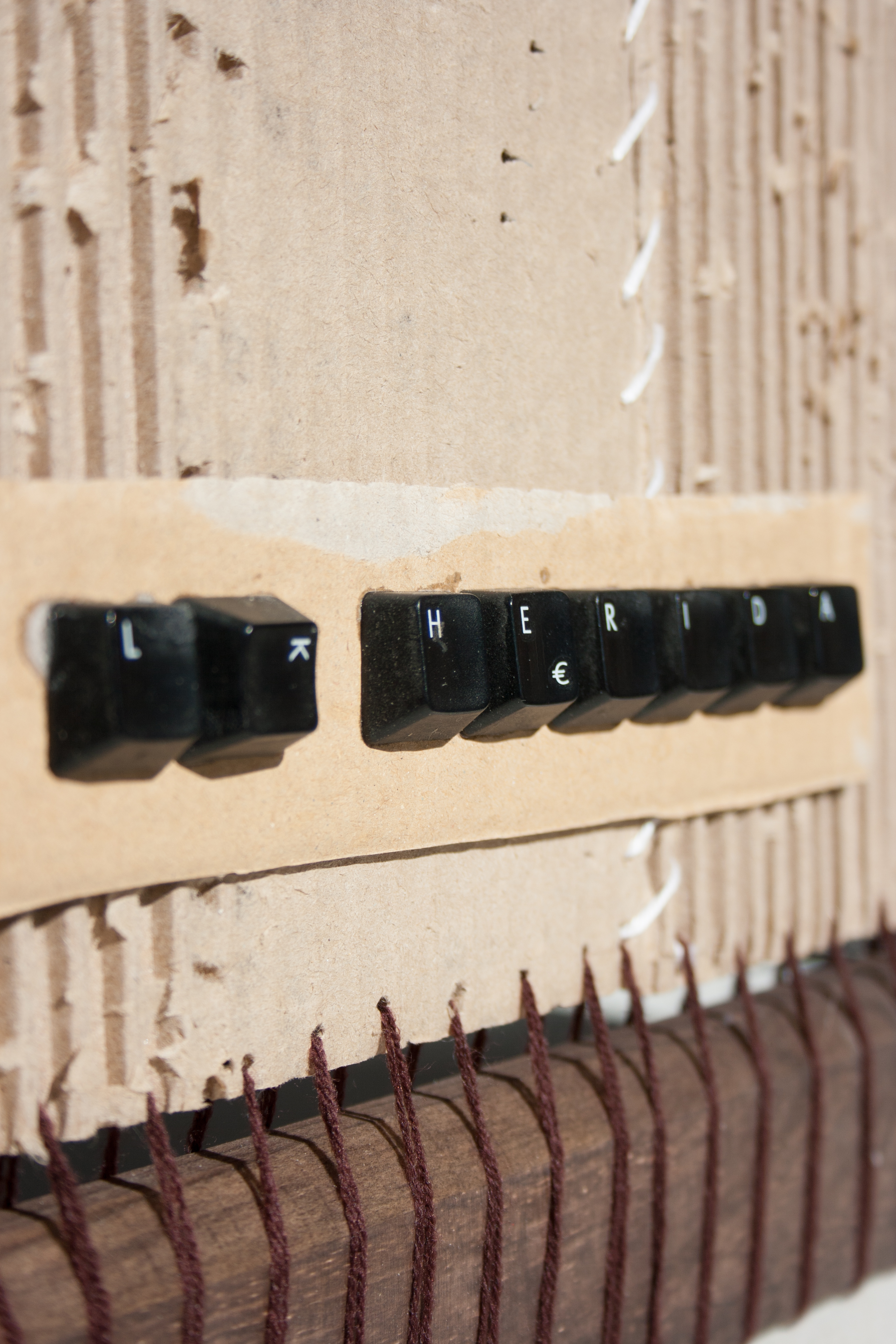

La herida (The wound). 2016.
