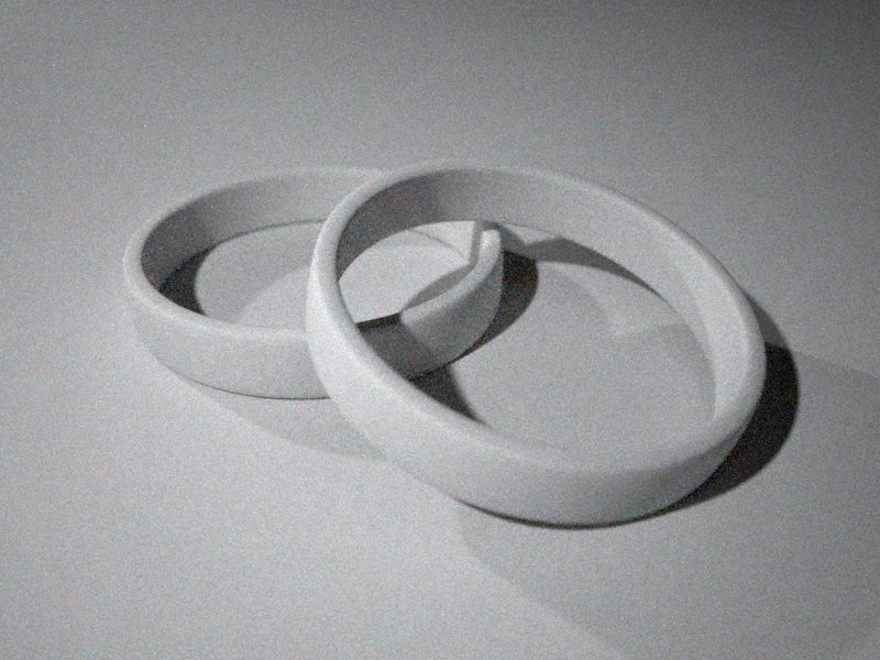

Investigations: lights strenght had to be augmented by a factor 100 000 in order to get an balanced image using default camera tone-mapping, you want to check that when dealing with lighting... but that didn't fix the issue anyways :).
Avoid using mn_cubic as splat filter if I may, even more if supersample is set to 1 ! Downsizing is still an admitted fix for nuked pixels (I prefer this expression, "fireflies" is suggesting a bug too much).
Also I replaced the rings geometry with a few spheres primitives to see if unwelded surfaces could allow nuking despite ray nudge distance, no chance with that (rings innocented :lol:). See attached.
An interesting fact is that these fireflies are not killing reinhard's tonemapping, meaning they are not exactly out of range ? If that's because they are clamped already one could process them, at the cost of unbiasedness, precisely (unwanted!=incorrect). If that's the case then we are facing a developer's choice I believe (hence he is aware already).
I hope I didn't lost logic that time :)
emittance x100000, daylight wb, default camera tm, gaussian as splat. 2000 spp.
