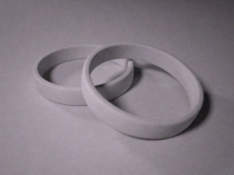

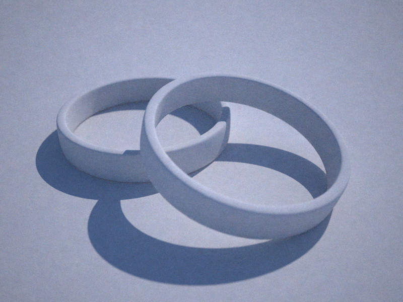

Post by fused » Sun Mar 29, 2009 9:07 am
with version 1.1.18 x64.
BVH is ok, kd tree misses lots of intersections :)
(also, there are quite a few fireflies and the longer i render the more fireflies turn up. weird, because i only used diffuse materials. pathtracing without bidir)
scene.zip
scene
(1.65 MiB) Downloaded 237 times
KD
BVH

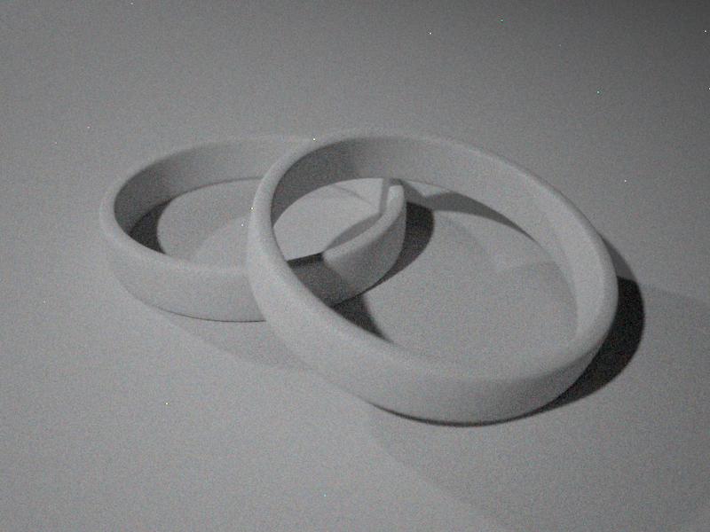

Post by fused » Tue Mar 31, 2009 8:52 am
Did some testing on the firefly issue.
All renders are with linear tonemapping.
Blackbody emitters, PT.
Blackbody emitters, bidir PT.
Blackbody emitters, MLT.
Blackbody emitters, bidir MLT. note how different it looks compared to the other blackbody versions.
Sun, MLT.
Sun, PT.
RGB emitters, PT.
RGB emitters, MLT.
Emitters are scalted by the factor 5 this time. Fireflies disappear.
RGB emitters, PT.

Post by fused » Wed Apr 01, 2009 3:07 am
all with bhv, kd is still borked.

sorry ctz, but this doesnt sound logical for me. also, you know ono and how he is having and eye on staying as physically correct as possible. i guess if this was a usual limitation of PT he wouldn't have said that i can and will be fixed?
regarding plain MLT: take a closer look, it has fireflies, too!

Post by fused » Wed Apr 01, 2009 9:21 am
download the scene and try it :)
the longer you render the more fireflies turn up and won't go away. this is definitely an issue ;)
