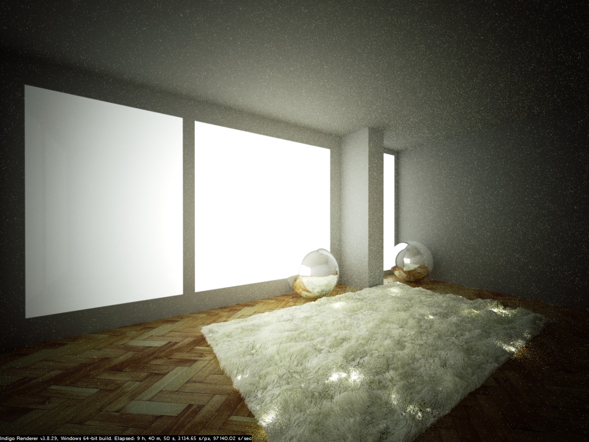

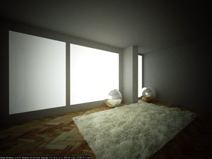

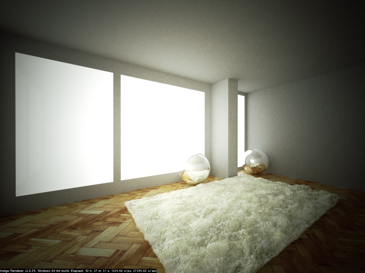

Post by Zalevskiy » Sun Dec 13, 2015 3:22 am

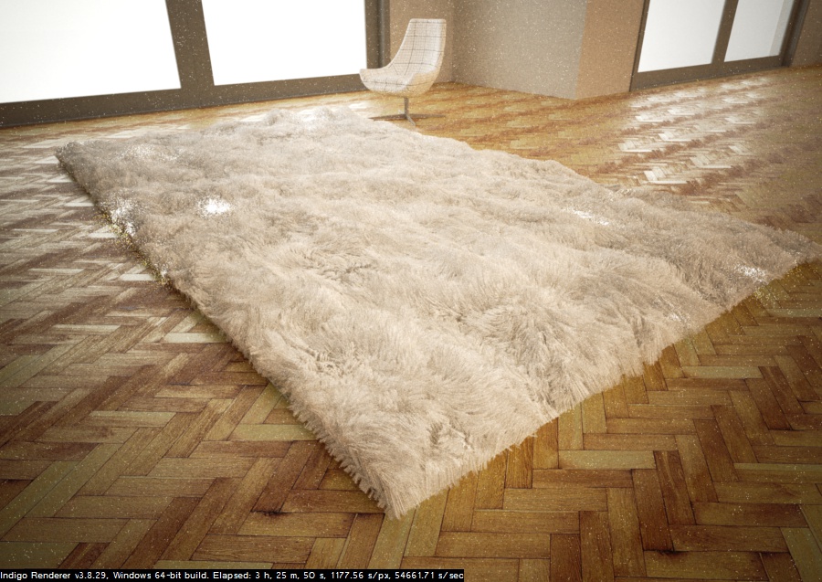

1. supersampling factor 3 ✔
2. bidirectional with MTL ✔
3. exit portals ✔
4. arch glass ✔
white noise? why??? :|
only layer 2 on
layer 1|2 on
layer 1|2 off

Is this something that is specifically related to the 3.8.29? Did you try it with earlier releases?
As far as I read on the forum, exit portals do not go well with BiDirMLT at all, especially when you have glossy materials, and specular ones, like your floor, for example. They will converge quite slow. Exit portals should be used with BiDir pathtracing, as it works the best in that mode.

I'd blame it on the portals, too.

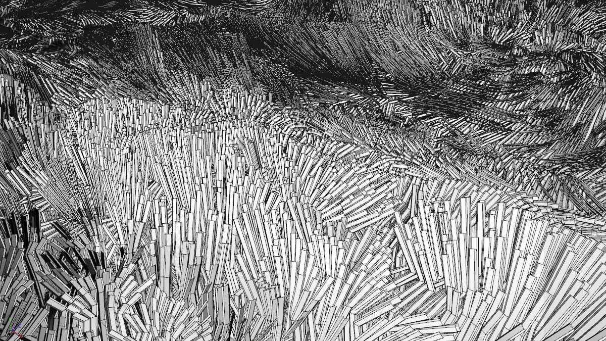

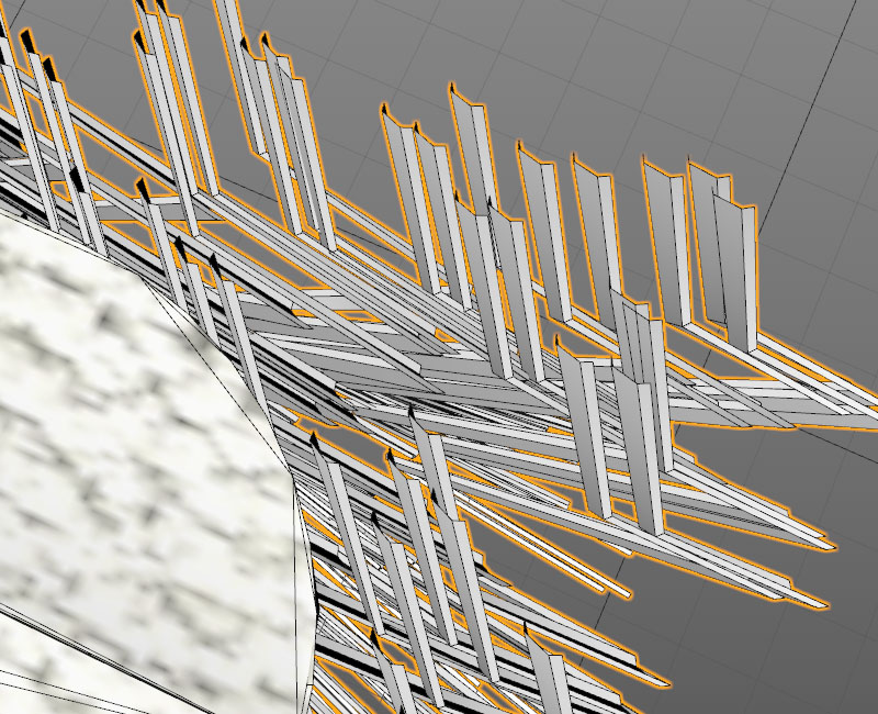

unfortunately .с4d model size 167mb! i have a very slow outgoing internet traffic(( I can only show the structure image:
BiDir pathtracing((

Interesting model! Thank you for the info!

I try to disable displacement material, result: (wait when the 3000 s/px)

Post by thesquirell » Mon Dec 14, 2015 1:06 pm
Looking at the polygons of the floor mat, I can tell you that there is no need for that displacement. The fibers are just to small, and unreliable in the terms of continuity, to use that displacement.Comparing the two renders, it doesn't add anything to the scene, except that funky glow, so, off with it! We have found our culprit, товарищ мой! Now, the question remains, why does it glow?! xD For this to be uncovered, you should definitely upload your scene, so we can take a closer look at it, and perhaps devs could also inspect it.
Пожалуйста!
P.S

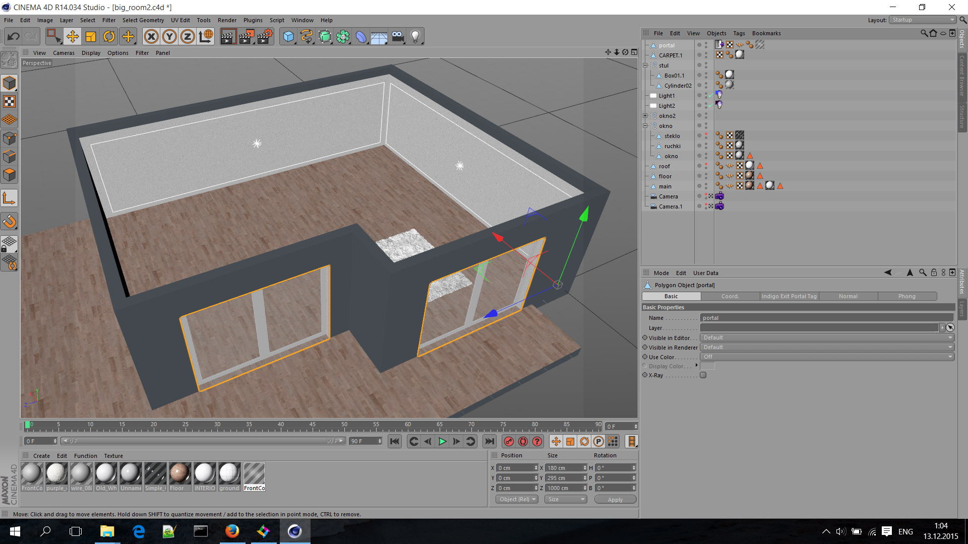

Woooah, wait, wait. Your first screenshot shows that you have light layers 1, and 2, in addition to the Sun and Sky. May I ask, what is your plan with them? What are you trying to achieve with them? Maybe you enabled "Emission" by mistake, perhaps? Are they the reason for that glow? I may suspect that by enabling displacement map, you actually move the fibers so that light shines through, and by disabling the displacement, the light just gets eaten up by them? So many possibilities! :D
Also, there is a known behavior of Indigo to actually favor the higher powered lights, and sample them faster then the weaker ones. Sometimes you will want to up the power of a small light source in your scene, to clear it up faster. For example, crank up that light causing the fireflies by x100, and lower it's power in light layers. Maybe by giving them more sampling, it will clear up faster. Also, do not use C4D's light with light tags, it is far better to use an actual mesh (convert primitives). Hope something of this helps, I wrote a lot of junk back there. :D

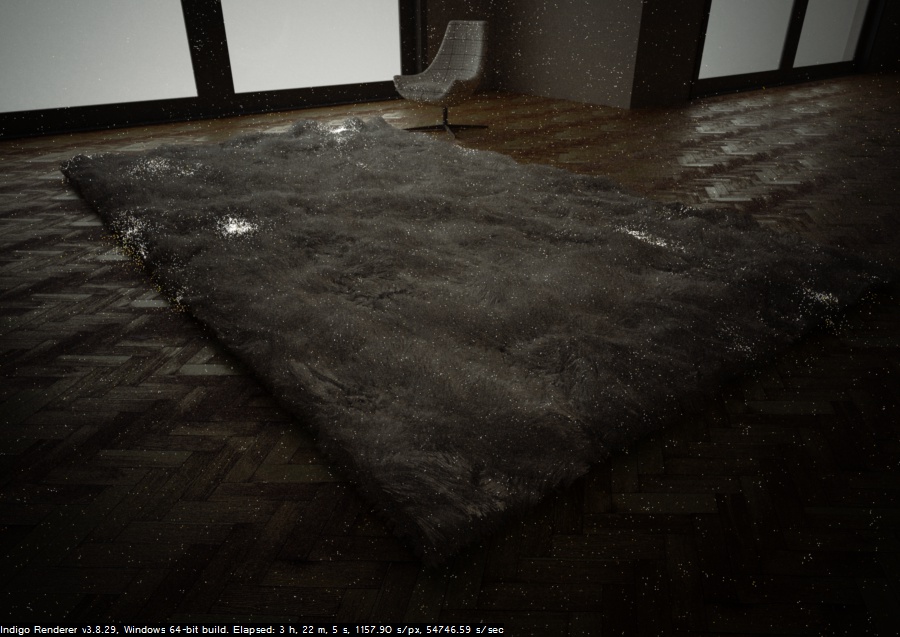

d_off 1294s/px

Ok, got to admit that those fireflies could come from those shiny spheres. But that does not explain the first scene. Give us your sceeenees! :D

In short I want to do this:
Interior scene with good light and fluffy carpet +hdr map (alternative — create fake photoshop background) the problem of white spots, like get rid of them? exit portal? probably too complicated structure of the carpet ... I'm not very good at it, all intuitively :|
It takes about such a result
