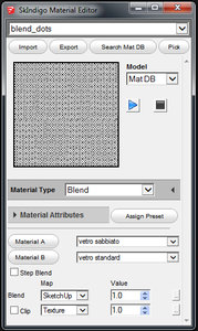

I have a plain black-white image I use as blend map to blend a glass and a frosted glass
I preview the material
I want to make the dots frosted, so I Invert the assignment of A and B materials

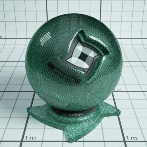

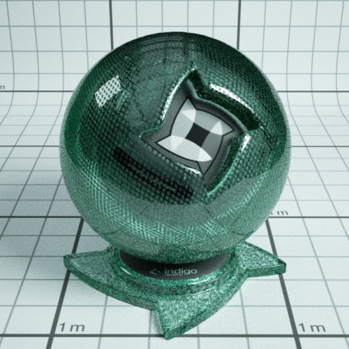

I preview the material and I get this

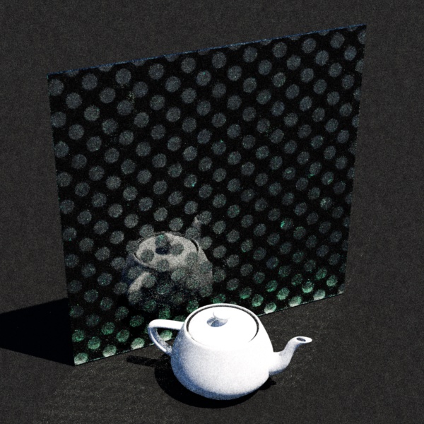

But if I render the SCENE I get this

To me the second preview and the example rendering look like the same material mate!

No they don't: in fact, in the mat preview the glass comes out transparent (except the dots), while in the rendering the glass comes out black, even if reflective. I posted a fast render, but waiting for a bit more of calculation doesn't solve the image correctly.
