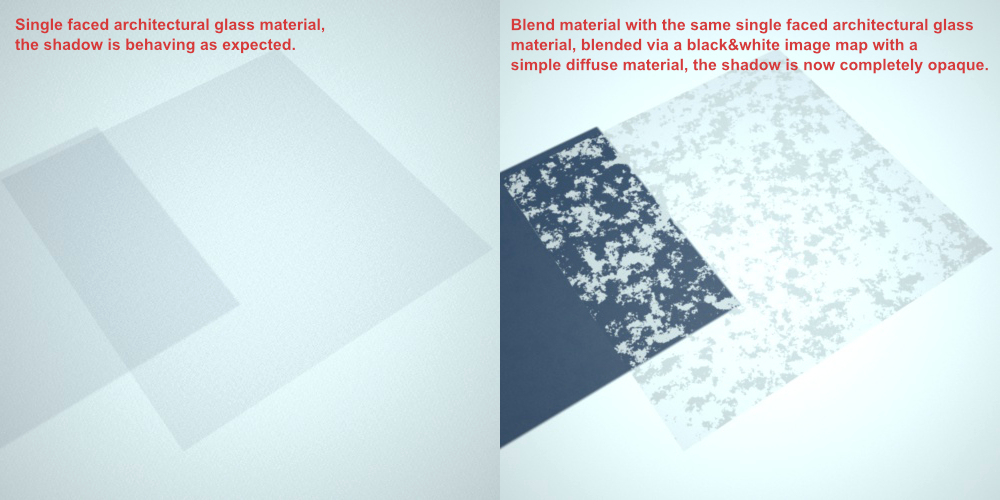

I don't know if it's a known issue or even a know limitation as of now but as i was trying to do a believable dirty glass shader i thought i would try to blend an architectural, single faced glass material with a simple diffuse material.
But it seems that, although i have no problem mixing those 2 together, there is no transparent shadow anymore, making this combination a "no-go", unfortunately. :(
So perhaps am i late to the plate (more than probably) but if it wasn't discovered already i hope this little explanation, as well as an image demonstrating the problem and the scene file to go with it, will help squash this annoying behavior, if it's possible of course. :)

Post by Oscar J » Mon Aug 17, 2015 6:53 pm
Very strange. Should work fine with normal arch glass though.

Hey there Laurent, and welcome!
I was having the same problems when I was trying to create an irregular glass, exactly with this type of material, the blended one. Tried everything, actually, but the only solution was the one I did in this topic (double mesh system). Read it up, and ask whatever comes to your mind:
http://www.indigorenderer.com/forum/vie ... =7&t=13591
Take care!

thesquirell wrote:Hey there Laurent, and welcome!
Take care!
Wow, thanks a lot, that will do the trick ! 8)
And you're right in your thread, it's "only" mimicking what happens in real life, finally.
We should always be confident in Indigo to mimic as much as possible the real life behavior, that's a lesson to learn ! :mrgreen:

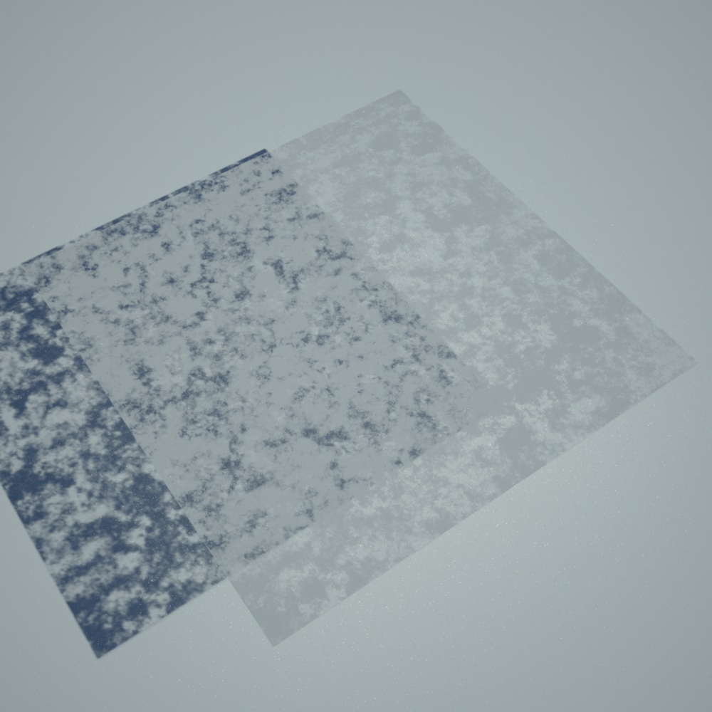

And, by the way, your trick worked perfectly, now i will be able to show the "real" image behind my question.
Waiting for it, here is the new test with your trick !
Cheers,
Laurent aka Tartiflette. :)
