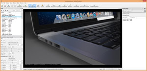

Hehe, nice render!
An user-defined interval would help getting the best out of speed and merging.
Cheers, zeiti
Cheers, zeiti
Re: [REQ] frame upload interval
All credits here go to Mor4us, its his scenezeitmeister wrote:Hehe, nice render!
If I'm right, the user-defined interval was removed due to the possibility to f**k Indigo up by having a to low interval, so the slaves are sending their output all the time, not keeping up with the interval...zeitmeister wrote:An user-defined interval would help getting the best out of speed and merging.
In the example image above you have a speed of roughly 950s/sec per slave machine so 3 such machines should go for ~2850s/sec! I loose 287s/sec or 1/4 of CPU time of the master by that
This is way to much and it gets even more the more slaves are connected!
Keep the auto network interval, but please please with sugar on top, bring back the slave command -frame_upload_period, so advanced users who want can use it!
