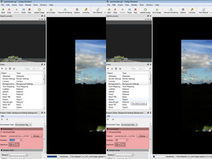

I'm using Indigo for C4D 3.8.6 with Indigo 3.8.9 It exports well from C4D, but I can't rotate the background in Indigo.

Hey Dude! Don't dude me! :/ :P I know how to rotate the sky from C4D, but this way I have to export the sceene each time I want it with a given rotation since whenever that scene gets exported I'm not able to do it in Indigo anymore.

I don't understand the issue here, and I say that because I really don't (I am a complete noob in c4D and Indigo), but if you check the "Advanced mode"->click on the image in the emission tab, and under the "Rotation type" select "Axis" you could adjust it inside Indigo easily. I can only hope that that helps, since I can't understand what are you going after... :D

I have a scene that take me an all lot to export, have to close the scene in C4D so I can get most of the RAM, altough I have 16Gb. So my plans are to cram the $#!t out of it and afterwards to do the thing inside indigo, like setting cameras and background ilumination... having said that, the thing isn't working as supposed to, so I'm reporting it, as you can check by the picture that I posted. :)
