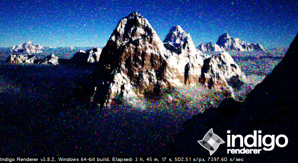

Hi Oscar, maybe now the question is understanded ...
Is about a bad expression (from our side); all the samples are correct, but only do a litle numbers of they in the time ( the performance is really low in this moments, jumping from stop (most of the time) to a very good count; and this modality of process is not possible until the 3.8 serie).
Actually a test with the last heavy scene at SS 1 is running with incredible results. If a stable count of samples is achieved the speed for this setups could be highly improved (is again a feeling, is the first serious test).
In the try to almost give to this test 1000 spp to observe the noise (with 440 is surprisingly good !) .
Update: Remember SS 1. Lefting the run in the most stable machinne to 2-3 K if possible.

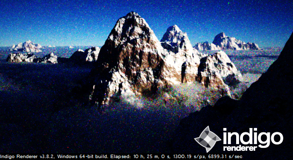

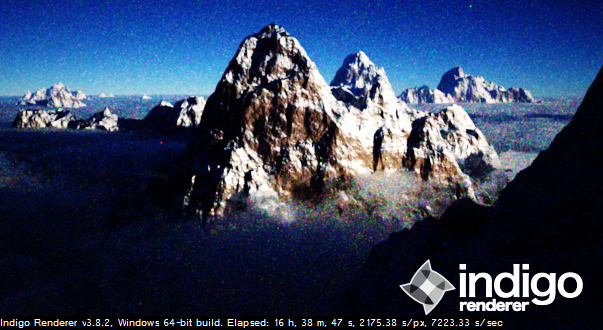

Re: Atmospheric simulation and GPU
16 h for that small image? That doesn't seem very promising to me.
Two GPU in this test. Only performs samples in a very low ratio and better for SS 1.
Just believing that was a good new.
Thank you and sorry for the dissapoint.

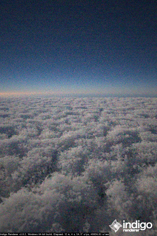

And the bells rings from far away... with a atmosphere_mesh: Something happens with the perfect spheres beyond a size: In this case GPU isn´t able to process well with a perfect sphere like atmosphere shell. With a mesh, performs satisfactory but please, sure that could process more rounded !!! Still doing accused jumps... (little GPU)....because my scenes use sphere primitives !
The test is with henyey-greenstein phase function, 12 minutes test.
CPU : 23.36 s/px
GPU: 54.17 s/px
CTZn, thanks fir the tip! The terrestrial atmospheric medium starts at 6378135 m and ends at 6458135 (yes 80 Km.). The inclusion of the ozone maybe changes the distribution and the specific real tabulated medium mixture of gases but don´t modify the range of expression, though.
