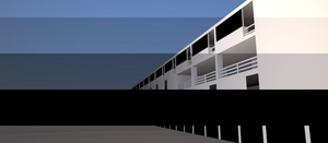

I've been getting black rectangles across my renders blocking bits of them out, if anyone can help me it'll be much appreciated. I have attached the screen shots below
There's also a problem where slightly lighter rectangles are above it

that looks very odd!
From the past I know that there could be some issues if your scene scale is REALLY out of relation, so check you internal scene scale and the export scale modifier if your house doesn't get exported as big as a planet ^^
Re: Black rectangles across my renders
Post by lycium » Wed Oct 23, 2013 4:12 am
+1, probably a scene scale issue.
If you launch Indigo and render the scene, in the render settings it reports the scene size in metres. If you're seeing astronomically large or microscopically small numbers, you should model your scene with units of metres.
This also matters when using media (incl. glass, water) since the amount of light absorption depends on the distance travelled in the medium, and the parameters are all defined in terms of metres. So if a pane of glass is 2m thick, it can appear black instead of a dark green for example.

Yeah the scale was the problem, it turns out my building was something like 10,000m long. Thank you for your help.

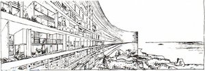

Post by Pibuz » Fri Oct 25, 2013 8:50 pm
StompinTom wrote:Although in an ideal world we should be able to render 10 000 km long buildings without a hitch ;)
..something like this?
(dedicated to all the fellow architects)

To be fair, Indigo could render that just fine if the near-field geometry is near to the world (0,0,0) origin :)
Post by CTZn » Sun Oct 27, 2013 1:40 am
lycium wrote:To be fair, Indigo could render that just fine if the near-field geometry is near to the world (0,0,0) origin :)
so if exporters were to shift the world origin at the camera, the issue would pretty much never happen ?
Post by lycium » Tue Oct 29, 2013 3:38 am
Errors in large scenes would be less perceptible, sure.
