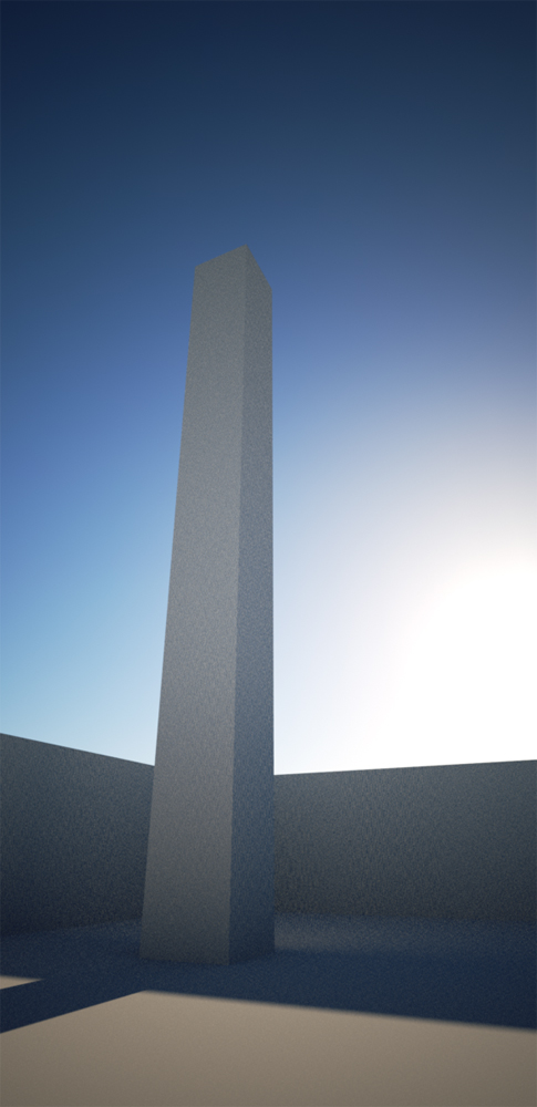

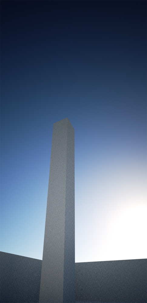

Post by Pibuz » Sat Jun 29, 2013 3:27 am
Ok, here's what I mean. Note that english is not my native language so I might be wrong about the correct technical name. :wink:
The first image is what I think Indigo should be able to do, that is making perspective converging lines to be rendered vertical; the second and third image is what Indigo actually does at the moment: it keeps the perspective point and "tilts" the image up, down, left or right, but the converging lines keep on..converging :lol:

Re: Zoom/BlowUp Region?
Post by Bosseye » Sat Jun 29, 2013 4:00 am
Ha, last time I dabbled with the lens shift feature in Indigo I was expecting Indigo to do what Pibuz has shown in his first image, ie get the converging perspective lines to straighten up to vertical rather than converge, but I got exactly what Pibuz got in his images - it just seems to tilt the camera up or down and makes no difference to the perspective.
I just assumed I was using it wrong or I had my terminology confused and lens shifting was something else.
So, I am also interested in this feature.

Post by OnoSendai » Sat Jun 29, 2013 4:39 am
Just point the camera forwards, then put the shift to a positive value.
Post by Pibuz » Sat Jun 29, 2013 4:42 am
Sorry Ono: what do you mean?
Post by OnoSendai » Sat Jun 29, 2013 4:46 am
To get an image like on the left side of 'how its supposed to work.jpg',
Point the camera directly forwards at eye level (e.g. no up component in forwards vector),
then set the shift to a positive value.
Post by Pibuz » Sat Jun 29, 2013 4:57 am
That is exactly what I usually do :lol: :lol:
Post by OnoSendai » Sat Jun 29, 2013 5:01 am
Pibuz wrote:That is exactly what I usually do :lol: :lol:
And it works, right?
Post by Pibuz » Sat Jun 29, 2013 5:04 am
Well, it does, but basically I do the work, by setting z-aligned POV and vanishing point.
I'm no photography expert but I kinda have the feeling it's not exactly the same thing. But I may absolutely be wrong!
