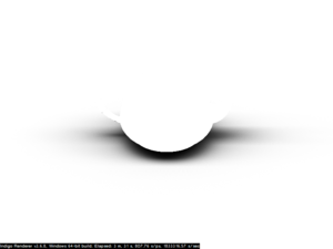

Re: [REQ] Shadow Catcher material...
Post by OnoSendai » Thu Feb 28, 2013 6:50 am
teapot under Uffizi probe
