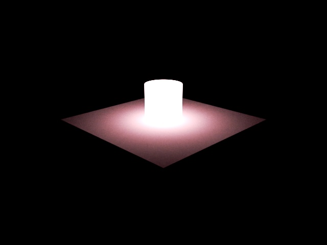

Here's the scene I did to test the same ramp than you, pixie. The issue with the resulting color is that one must determine the right spectrum range, that's beyond me. I think these pictures are starting below 500nm (according to some comments found in the page). plus, they do not seem to be of a linear scale.
By the way Yves, what is that greyscale image you attached ? Could it be the result of the corrections I'm mentioning ?
So yes it's pinkish... I changed emission gain, and also matched light temperature with camera's. Tweaked layers. Linear TM in order to preserve original tones.

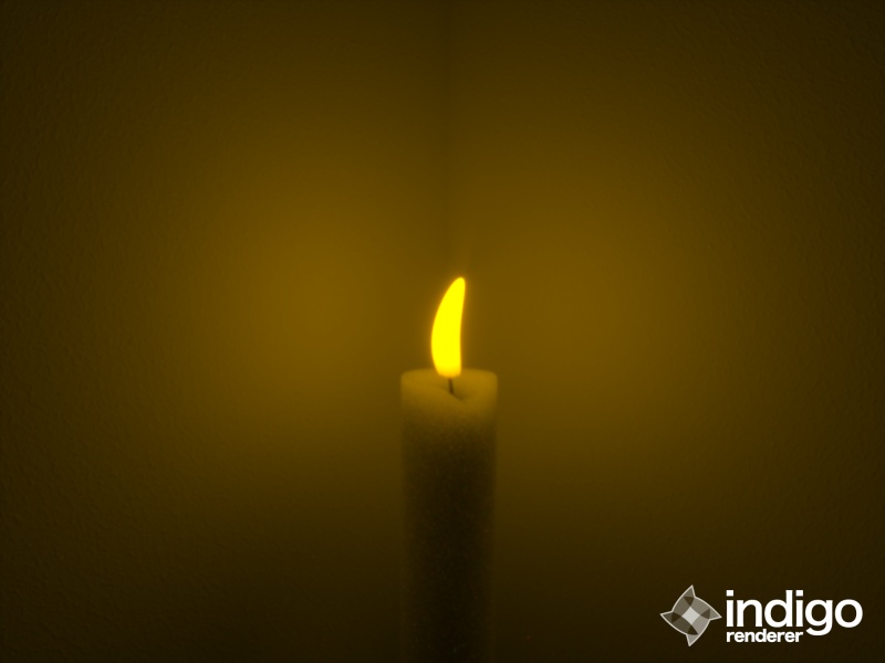

Another white point question:
I made a candle and applied the data from the reference page. But the temperature in K of a candle is so low that I can`t find the "right" white point. The "neutral" point E gives a slightly greenish result on my monitor at least. I expected a more yellow or red look. Can anybody verify that?
Attached are images with whitebalance settings 9300 and E, and one with quick and dirty post-pro to illustrate the look I was after. Sorry the the pics are still noisy, but I don't want to wait another 20hours... damn sss!

galinette
Posts: 923
Location: Nantes, France
Re: Reqiest║Metal temperature
Post by galinette » Mon Jan 25, 2010 7:00 am
Just one thing you need to take care of : these spectra pictures does not correspond really to intensity, as there were recorded with a coloured sensor which has a sensitivity dependant on wavelength.
Use the textfiles from this website instead:
http://astro.u-strasbg.fr/~koppen/disch ... drogen.txt
The .txt give position of peaks and the relative peak intensity, which will be much more accurate than the jpeg spectra.
Etienne
Eclat-Digital Research
http://www.eclat-digital.com
