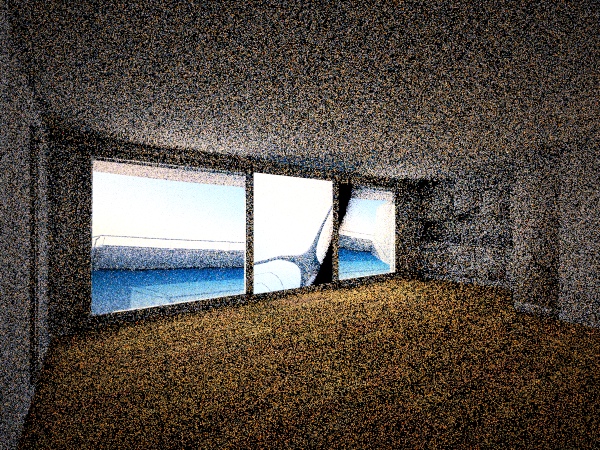

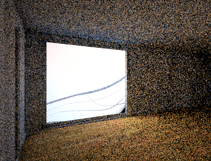

As you can see in the file "how_it_should_be.png" there is a balcony outside.
I just removed the glass geometry to let the sun in.
But if I add the glass geometry and add the glass material it looks like in picture "how_it_is.png"
whats wrong with the glass material ?
Post by Kram1032 » Sun Aug 26, 2007 3:59 am
your glass looks bended and as if it has slight colour... ;)

has your glass some volume or it is a single plane.. should be volume. also check if normals are pointing outside

the has glass has a volume and its not bendet ;-) normals are pointing outside on the left glass and inside on the other 2 glasses. If I turn the other 2 outside the glass gets just black.
what else could be wrong ?
Post by suvakas » Sun Aug 26, 2007 5:22 am
Do you have a bump map applied?
Too high ior ?

try to render only all glasses, maybe there is another unclosed medium somewhere in the scene, i remember that i experienced once something like this, i had to remove all objects one by one until i found the bad one

Looks like you have normal smoothing turned on for the "glass", which causes that effect.
Post by Kram1032 » Sun Aug 26, 2007 7:51 am
hey, yeah, that could be it!
Turn of normal smoothing ;)

Post by Alain » Sun Aug 26, 2007 9:29 am
thank you guys, that was it ! :-)
