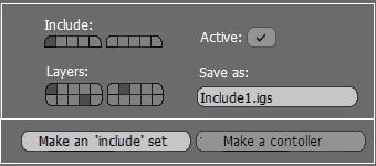

perhaps its easier to have a button matrix on another UI page to set up things like ( bit messy hope it makes sense)
X####X#### save these layers as: include1.igs
#########X use this include X
##X####X## save these layers as: include2.igs
###X###### use this include X
#########X save these layers as: include3.igs
X######### use this include #
make includes set # | make a controller X
possibly you only need say 5 or maybe 10 includes max for practical purposes?
this way some layers could be grouped together for convenience or you just might have 1 per include
:idea: it would be clever of course to only have one set of layer buttons referenced by a further set of 10 include buttons to switch through to set up the appropriate data and name for each
:roll: I think having all these includes set up and saved together will cause memory use problems if there are a large number of faces ie. I dont think you will be able to export all the includes in one hit..
hmm still with 64 bit or perhaps some guidance notes for 32 bit limitations in the manual/wiki it could be ok
also it occurs to me that making layers visible/active is what sucks up the memory among other things and ruins exporting of large no of faces so it might be advantageous to actually export from hidden layers in the worst case... if its possible?
I think you might still want to have the option of separating the materials from the meshes available though perhaps that makes things too complex...
and it would be convenient to use the above matrix and names to make the controller set of include tags :wink: or remake it as required
beware though you want to disable autorun for making the includes
the controller could be saved and autorun an existing include set or parts of it though
dont let me dictate though I am sure there are plenty of ways to do this
Indigo readers here please speak up with your own ideas.. 8)
EDIT: add pic -something like this perhaps

Post by Wedge » Mon Aug 13, 2007 4:19 pm
Hi Big Fan, just wanted to say thanks for all of your help with this request. Your testing was very helpful and I'm sure you know, testing is half of the battle when adding new features. Fixed the last bug with layers (I hope) that came up in certain situations. It was a little bit tricky to code this feature, since objects can be in multiple layers and you can render multiple layers. The bug caused cube located in layer 3 and 5, to export to layer 3 when exporting of only layer 5 was selected. It is fixed now though. :)
Thanks again for your help. Soon I hope to do a big scene test with this feature to see how it works. (all of my tests were less than 250,000 faces/verts)
