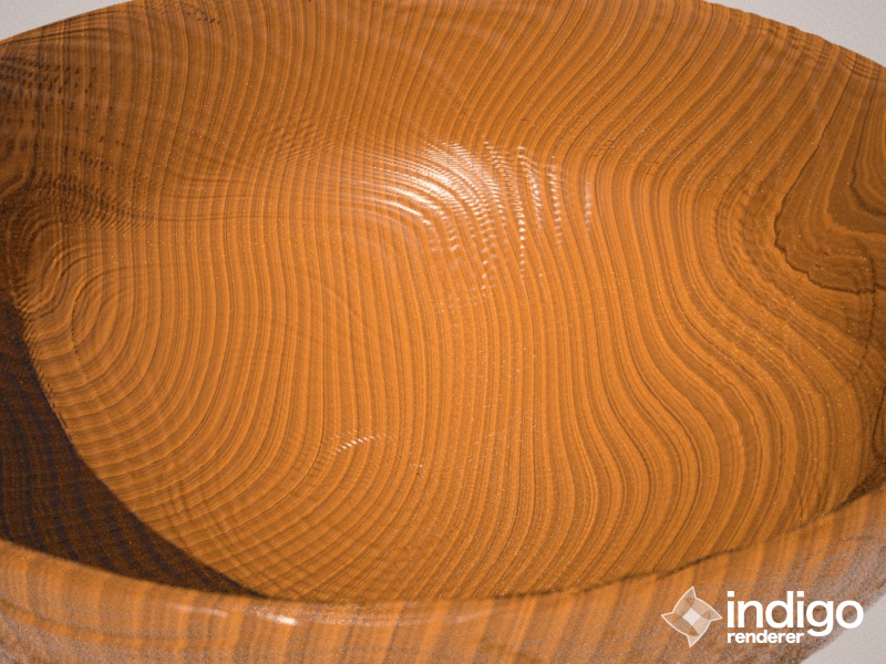

juan_irender
Posts: 251
Joined: Tue Jun 23, 2009 12:37 pm
Location: Spain
Re: Requests with ISL!
Post by juan_irender » Thu May 30, 2013 11:34 pm
Hi.
I think I´ve found the same problema CTZn is talking about.
Please, check the pic. I´m trying to slightly displace the surface following the rings of the wood, using the same code programmed to generate the color (albedo).
You can see how the displaced rings are not the same...
Ciao.
Post by CTZn » Fri May 31, 2013 1:22 am
Juan refreshed my memory, the issue involves the use of posOS() indeed, it's not returning the same coordinates once used for displacement.
That's why the issue shouldn't relate with your terracotta shader Etienne, any awesome :)
Post by OnoSendai » Wed Jun 05, 2013 3:30 am
juan_irender wrote:Hi.
Ciao.
Can you post the material?
