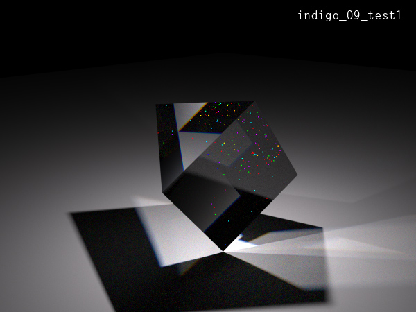

Try run the dispersion test scene and see for yourself. Every time I try it I get loads of multicoloured fireflies. (try with aperture diffraction disabled)
Next edit the igs file and change the cauchy to 0 then run it. The fireflies are still there but only in 2 colours.

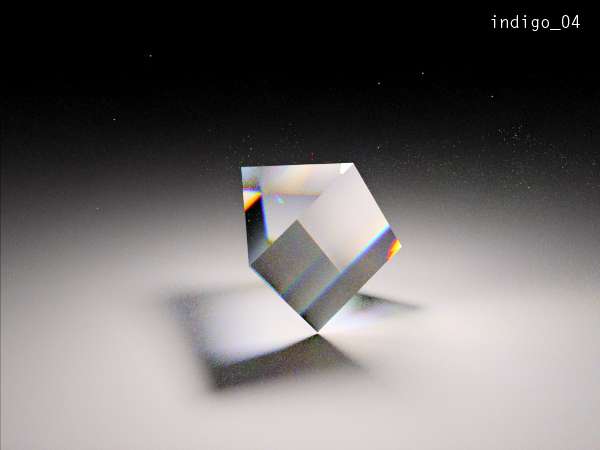

Post by neepneep » Tue Jan 06, 2009 11:28 am
It seems that each indigo version previous to 0.9_test1 will render the scene slightly different but looks correct - , while versions 0.9_test1 and onwards renders with those dots - and it gets more intense it later versions.
So which version is correct? Or is there still a bug here? (or just operator error?)
Post by Zom-B » Tue Jan 06, 2009 12:41 pm
very nice testrange neepneep, even with indigo 0.4 ^^
Now lets wait for some words from the master :)
Post by CTZn » Tue Jan 06, 2009 3:15 pm
I'm betting on a bidir effect, early Indigo versions were mlt based if I am correct. Switch to mlt only and you will have similar results, or I'm a fool (huh, I'm taking some risks here).

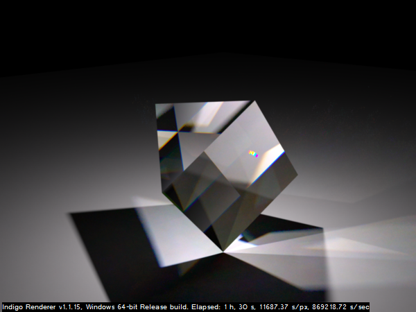

Post by suvakas » Tue Jan 06, 2009 8:18 pm
Yep, CTZn is correct.
Here's the MLT version renered with 1.1.15

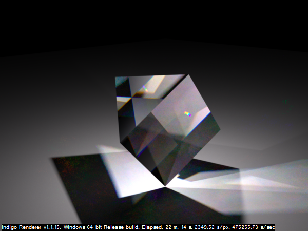

Post by Sinister » Fri Jan 09, 2009 3:37 am
Bi Dir = on, Adv Opt = on,3100spp (best result, but color dust in shadow)
Bi Dir = on, Adv Opt = off , 3500spp
Bi Dir = off, Adv Opt = on, 2900spp (Disco :D )
Bi Dir = off, Adv Opt = off, 3500 spp
(looks just the same as second picture (BiDir is a part of Adv Opt?) )
Post by CTZn » Fri Jan 09, 2009 4:37 am
It's nice to have done these tests Sinister, but maybe you did not understand exactly how advanced options works in MtI.
Whenever Mti Use Adv Opt is off, bidir and mlt settings from the UI are discarded. The following only are then written to igs,
<renderer_settings>
	<width>
	<height>
	<super_sample_factor>
	<logging>
	<image_save_period>
	<display_period>
	<save_igi>
	<save_tonemapped_exr>
	<save_untonemapped_exr>
</renderer_settings>
output truncated horizontally for readability
... and Indigo will use the default renderer values defined in inifile.txt (Idigo app dir, metropolis off, bidir on), every time advanced options are off.
So if you really want to test rendering combinations, leave advanced options ON in MtI and tick/untick mlt/bidir in ui.
I can explain again, or further if you need.
By the way the third shot is a rare thing o.O It's mlt only.
