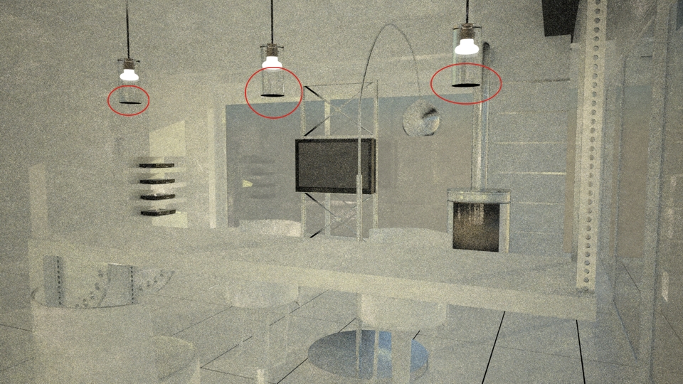

When the emiter is inside glass-mesh on the end (whole) I've got some black color... why? What I'm doing wrong?

Check weather the normals of the black rendered polygons are correctly.

Post by ozzie » Thu Nov 13, 2008 12:49 am
there are no normals... there's whole on the bottom
Post by pixie » Thu Nov 13, 2008 2:12 am
Check if the glass volume is closed
Post by CTZn » Thu Nov 13, 2008 2:21 am
Whole = hole I suppose ?
Assigning a medium to an open shape is a mistake, ozzie. Give the cylinders some thickness to make them closed volumes, or use diffuse emitter for single layer meshes like the actual ones (open surfaces).

Post by Kram1032 » Thu Nov 13, 2008 5:51 am
seen as a cut-through, it would look like this:
|_|   |_|
where |_| is a glass wall.
