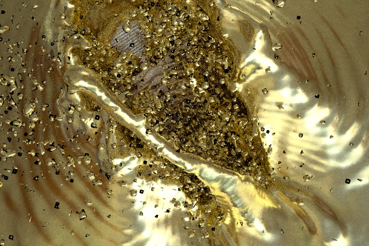

I hope someone knows. I'm getting it too. It seems to choke on the mesh. My model is a fluid simulation. :cry:

It renders in Indigo 1.0.4 but with black blotches. Seems to be bad triangles generated by the particles in Blender fluid simulation. Blotches also show up in Luxrender.

It's normals, dude.
And it's normal for a fluid sim, as well :/
Some of the individual droplets are smaller than ray_nudge_distance across, it acts just like a reversed normal.
Post by Kram1032 » Thu Aug 07, 2008 4:33 am
look at the blackish drops and you'll notice that many of them look pretty cubic...
Post-bake-subdividing might help ;)

Thanks for the observations and suggestions. As I expected, the blotches were associated with "particles." Running the fluid simulation again with particles = 0 produced a clean image. I had included particles because I thought drops of liquid would look nice.
I tried post bake sub division and it crashed Blender. It ran out of RAM I guess, due to Windows limitations (using Vista 32bit with 4GB).
So the lesson learned is that if you plan to render a Blender fluid sim in Indigo, turn off the particles. :)

zsouthboy wrote:It's normals, dude.
Would that explain the error message about "Vec3" in Indigo 1.1.7? I think it might be that the Blender particles are not fully formed meshes.
Or they are just made of too few triangles, with the usual shading :)

zsouthboy is right. It isn't just particles. The much improved image after setting particles to zero in the Blender fluid simulation still has some black blotches. Must be the reversed normals problem. Unfortunately Blender crashes when I try to post-bake subdivide.
