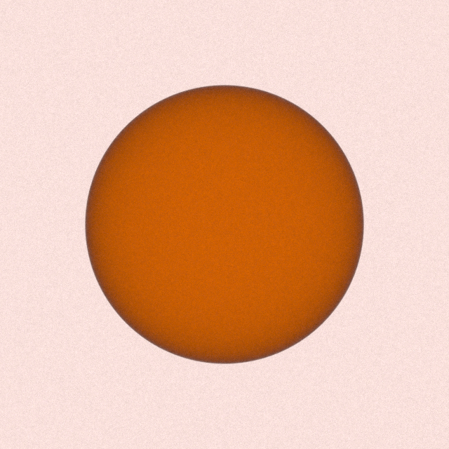

Post by Zom-B » Tue Jan 15, 2008 11:55 pm
Phong material having a IOR of 1 shows a darkening on the edges, it seems Energy Loss Compensation isn't applied (correctly).
Its maybe not serious, because why using a Phong mat with IOR = 1 and not a Diffuse mat, but maybe this Bug has some deeper roots...
Phont with IOR = 1, Exponent = 1000

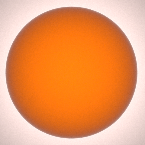

Post by Zom-B » Wed Jan 16, 2008 1:08 am
I'm just testing further and it seems, an IOR of higher than 1 results also in this "Black Outline Issue", the higher the IOR the less its visible! IOR of 1.01 locks same as 1.00!
I Attached an pic with IOR = 1.1, Exponent = 1000

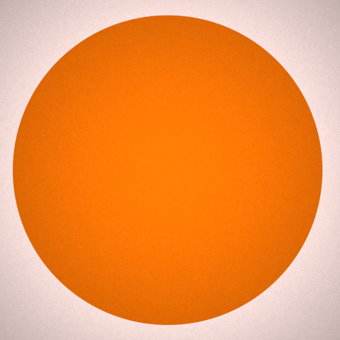

Post by Zom-B » Wed Jan 16, 2008 2:14 am
Hmmm... I rendered the same uniform lightened scene by the same colored diffuse material.
The Diffuse material shows some darkening to the "edges" of the sphere (lol, I hope you understand what I mean).
Shouldn't be an uniform lightened diffuse material in an vacuum be totally uniform colored???
can this be an Reinhard issue...?
diffuse material, uniform lightened.
Post by OnoSendai » Wed Jan 16, 2008 2:27 am
You may be seeing vignetting, use a longer lens.
Post by Zom-B » Wed Jan 16, 2008 9:10 am
OnoSendai wrote:You may be seeing vignetting, use a longer lens.
Yes Ono, you are totally right, Vignetting was the bad boy here...

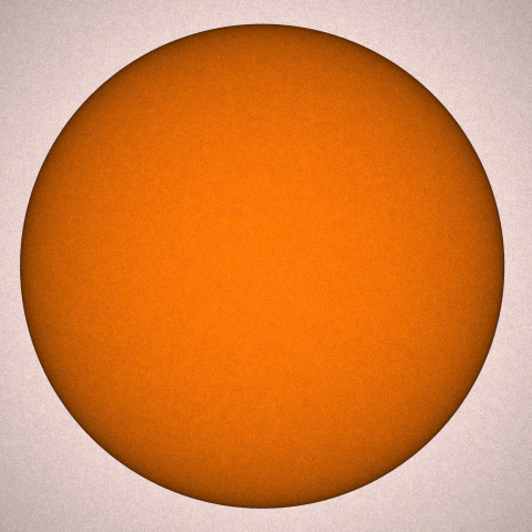

But returning to the Phong & low IOR problem, I can confirm, that there seems to be an issue with low IOR's like 1.025 in the attached image (Indigo 1.0.5).
IOR = 1.025, exponent = 10000000
Post by OnoSendai » Thu Feb 28, 2008 10:47 pm
IOR of 1.025 is still too low to be realistic.
Post by Zom-B » Thu Feb 28, 2008 11:30 pm
I have no Idea where reality starts, so here an IOR of 1.1, exp 1000000
IOR = 1.1, EXP = 1000000

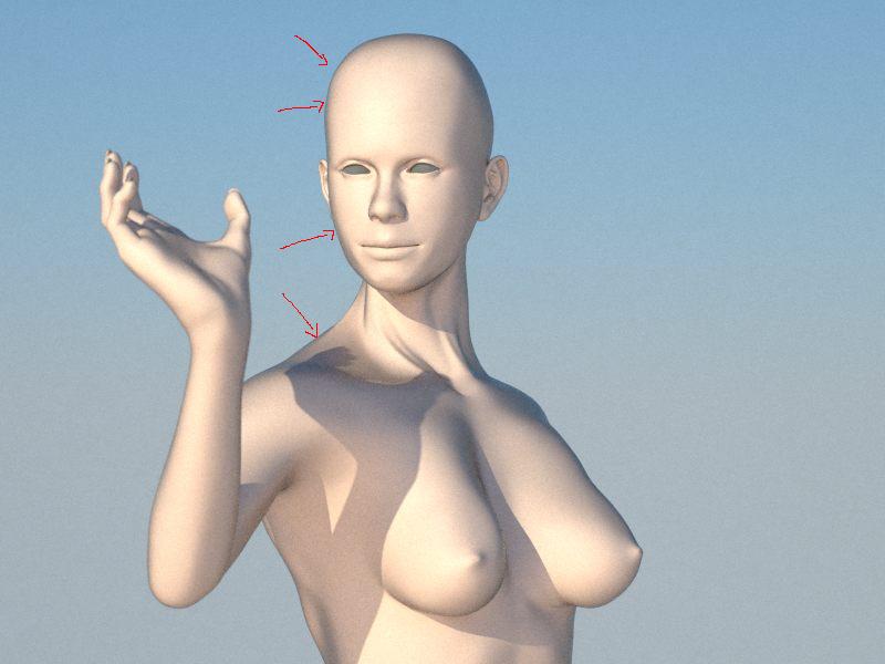

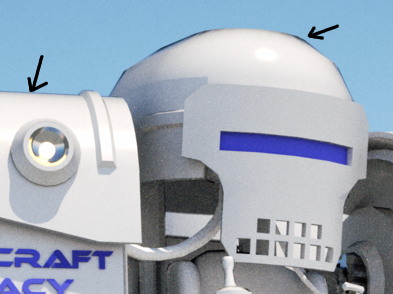

IOR 1.2, exponent 500. sky turbidity 1.9
SmartDen
Posts: 999
Location: Canary Islands
Post by SmartDen » Fri Feb 29, 2008 3:22 am
muody wrote:IOR 1.2, exponent 500. sky turbidity 1.9
you have typically normal smoothing problem. consult the exporter writer for your software
Post by BbB » Fri Feb 29, 2008 3:28 am
muody
Some of this may be normal smoothing errors, I think. The mesh I rendered, however, was highly subdivided so this can't be the problem...
Post by OnoSendai » Fri Feb 29, 2008 3:36 am
Yes.. the two problems are related, but not quite the same.
