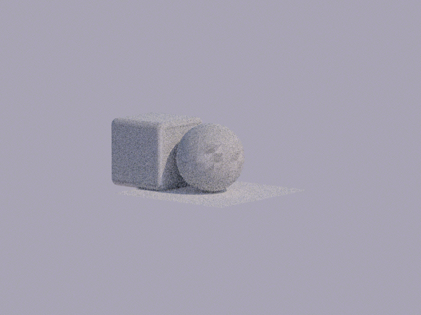

WOW my first success ! :-D
Looks pretty interesting yet ;-)
an one more question:
which parameter do I have to change to remove that "rauschen" in the picture ?
Regards
Alain

Post by SmartDen » Fri Aug 24, 2007 3:29 am
to remove noise from the picture you just have wait longer ;)

Post by Kram1032 » Fri Aug 24, 2007 3:52 am
Home Page wrote: Welcome to indigorenderer.com
Indigo is a free, actively developed, physically-based unbiased render engine.
Employing advanced features such as Metropolis Light Transport, Spectral light calculus, a virtual camera model, physical sky and more, Indigo can achieve much more realistic results than traditional GI raytracers.
Indigo does not need any render parameters like GI samples, AO samples, AA samples, Soft shadows, etc, and complicated lightning setups to achieve realistic results.
Indigo is free for non- and commercial use, but as of writing is not open-source.
Want to know more ? Read the Indigo FAQ in our documentation section.
To get a feel of indigo's possibilities, visit our Artwork Gallery, or head over to the Main Download Page.
For some reason, the line with "progressive" is gone...
Anyway:
Indigo is a progressive renderer.
That means
it slowly builds up the picture, getting more and more clean and noisefree ;)

Post by SmartDen » Fri Aug 24, 2007 4:31 am
Alain wrote:@SamrtDen and ZomB
LOL, ok, I see, I coudnt imagine that rendering can be so simpel ;-)
It means the longer I wait the better the result, is it an endless loop ?
Exactly!
