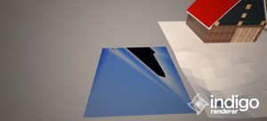

Post by Darshan » Thu Apr 10, 2014 3:35 am
good news>>> shaders are running in 3.8.1 beta
bad news>>>> shaders are not working properly... when i added the displace shader for the water as shown in "how to make pool tutorial" it rendered like this very badly... :cry: :cry: :cry:
water is looking like metal...
displace shader used is
def eval() real :
fbm(posOS() * 2.0, 2) * 0.02
