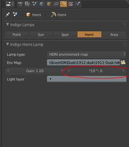

Here is the settings for the environment lamp on blender. It just behaves like gain/power.
And yes, the gamma in indigo texture setting is greyed out.

Post by William » Mon May 13, 2013 6:50 pm
Does not appear available for environment texture in blender :wink: (see screenshot of setting above)
Re: [REQ] hdr environment - gamma control
Post by Zom-B » Mon May 13, 2013 7:29 pm
William wrote:Does not appear available for environment texture in blender :wink: (see screenshot of setting above)
Ah ok, got it :)
Blendigo doesn't use a Material for EnvMap but a direct link to a texture instead. That is different in C4D exporter for example...
