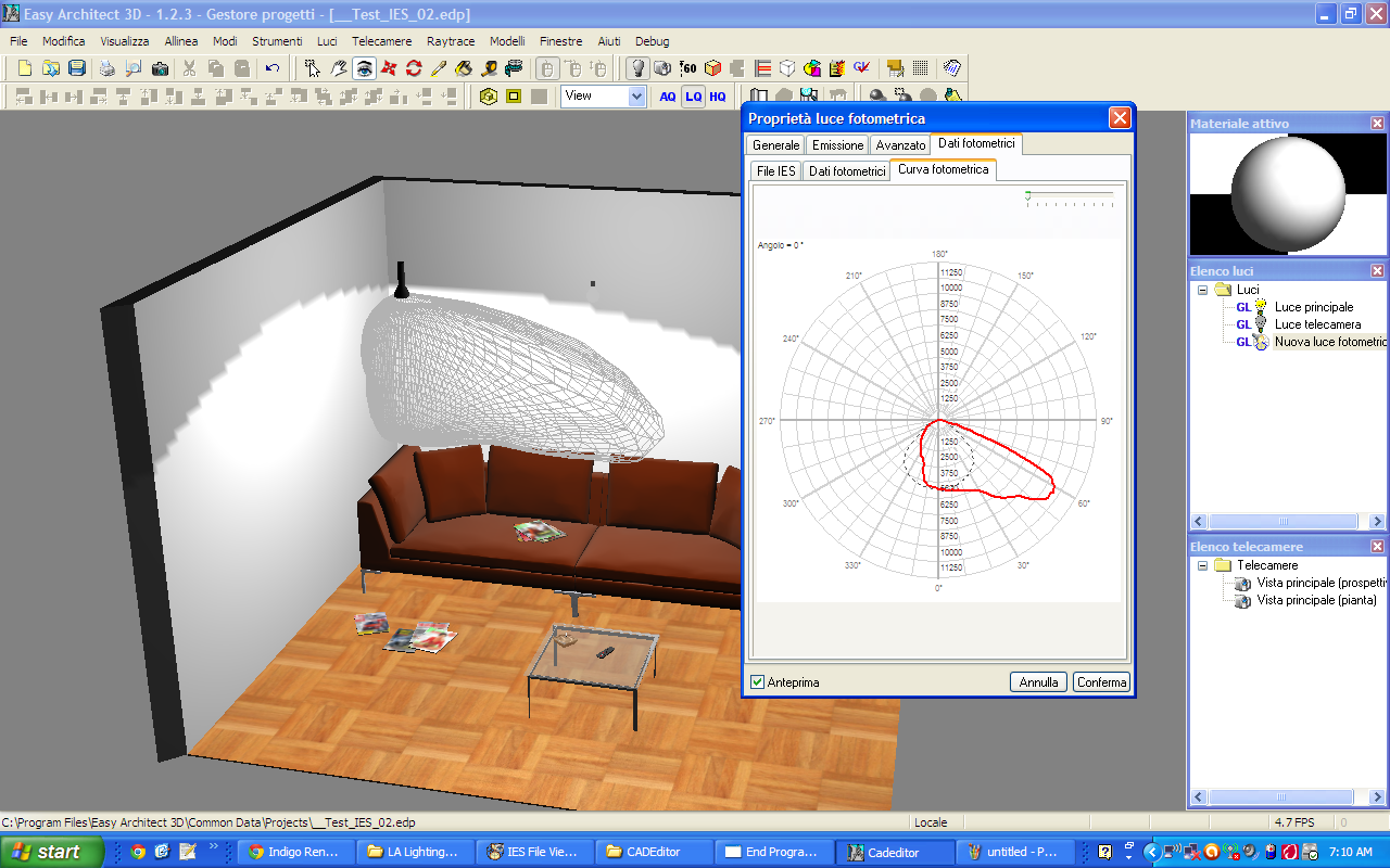

Ono I have the source code to complete process IES Lights, asymmetric light too :wink:
It even manages light with partial angles (eg. 0,45,90 or 0 to 90 and 270 to 360), it calculates missing values using Splines.
At the end of the processing it return the complete angles (0 to 360)
If you send me a PM with an e-mail I will send you the source code (C language).
Bye
Delle
Asymmetric IES Light example
Re: IES light bug
Post by OnoSendai » Fri Nov 02, 2012 3:48 am
Hi Delle,
Thanks for the offer.
Indigo supports asymmetric IES profiles.
delle
Posts: 175
Location: Italy
Re: IES light bug
Post by delle » Fri Nov 02, 2012 5:45 am
Ooops I miss it :oops:
Edit: Which is the minimum Indigo version that supports them? E.g. starting from version.... (to configure my exporter)
Bye
