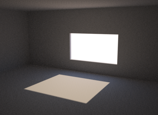

And here's a scene of the issue (dropbox link). This scene also shows another bug, where when two identical lights sitting next to each other, one won't emit light for some strange reason. Weird.
ARGLEBARGLE
Anyways, after removing the lights, the scene renders as this:
WTFBBQ
Exceedingly frustrating issue. I've checked everything I could think of to make sure I'm not messing up some obscure setting. I'm actually ready to blame it on time traveling neutrinos.

Are you using Reinhard? not sure why else the sky would magically appear when you remove the artificial lights.

Whaat wrote:Are you using Reinhard? not sure why else the sky would magically appear when you remove the artificial lights.
It is using reinhard, but camera mode suffers the same issue. The problem is that the interior lights really are just waaaaay too bright. I need an ISO of 1 and an exposure of -9 to avoid overexposure, and that's in combination with turning down the brightness of their light layer. Either way, it doesn't function as intended.
