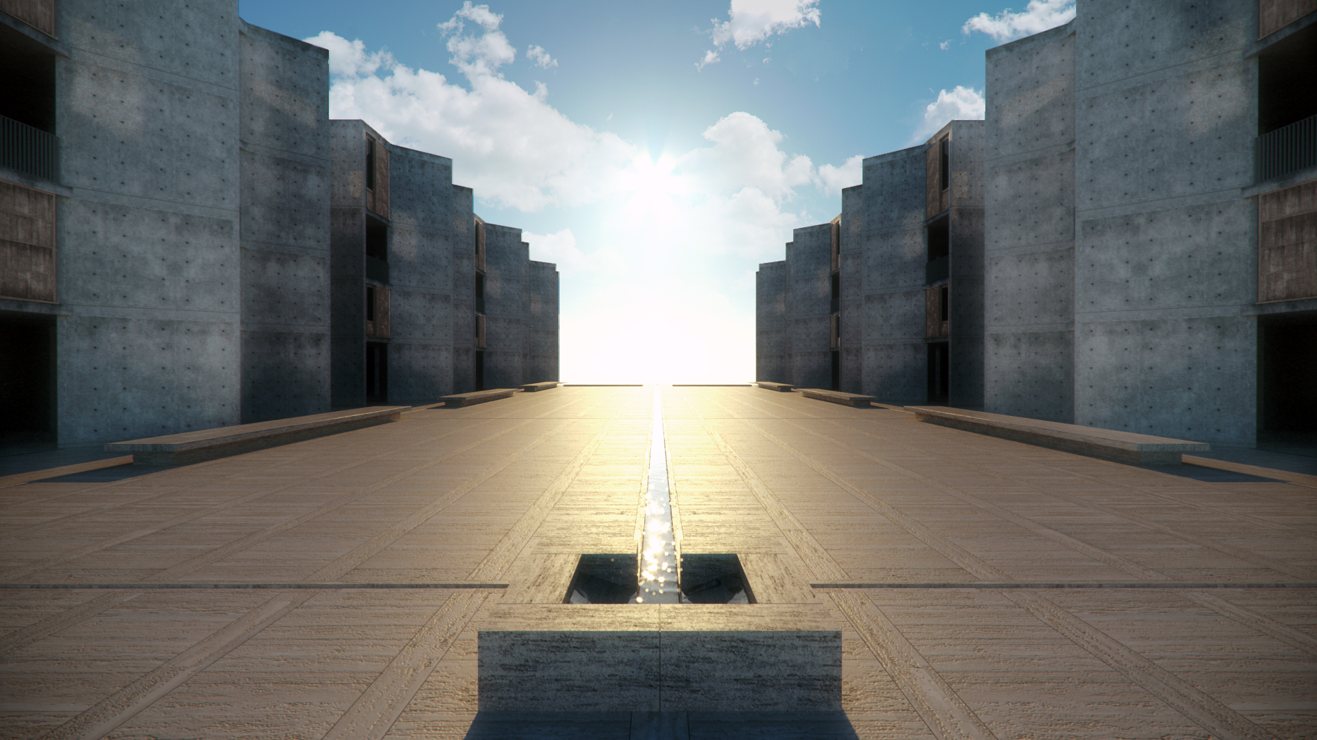

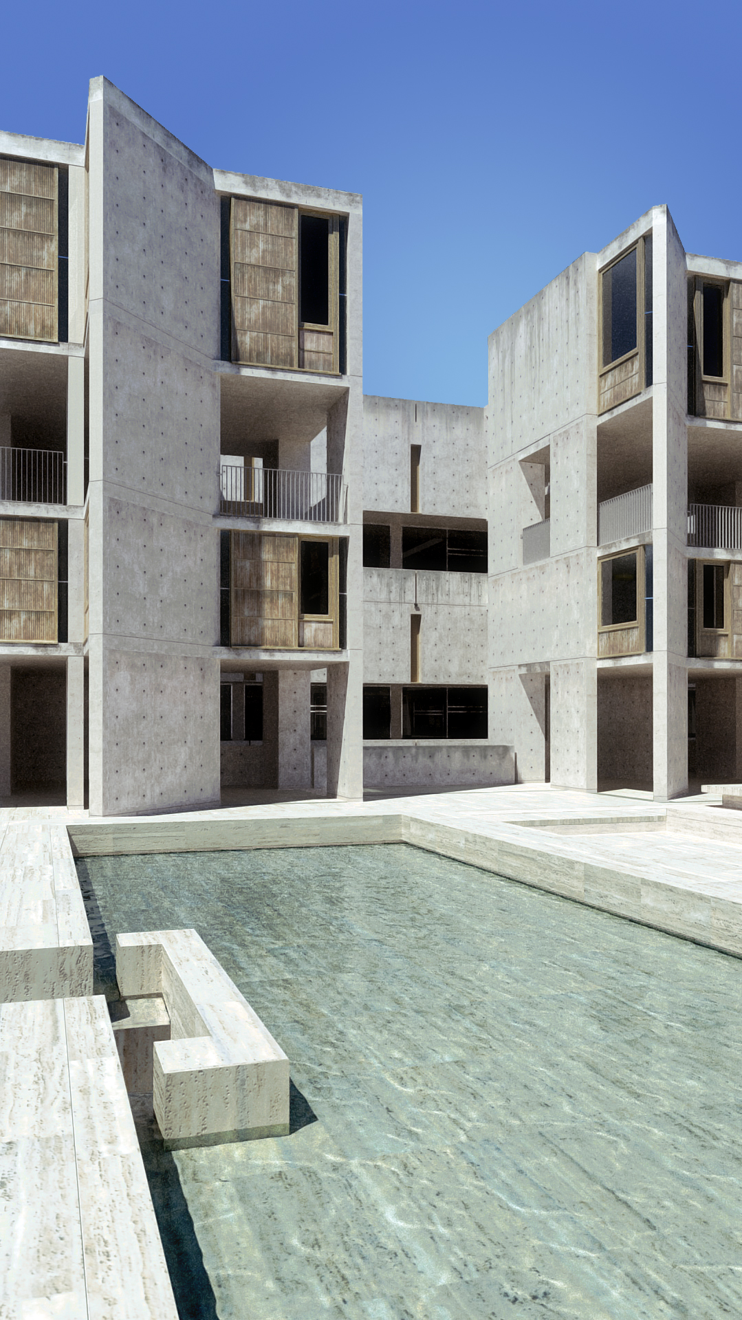

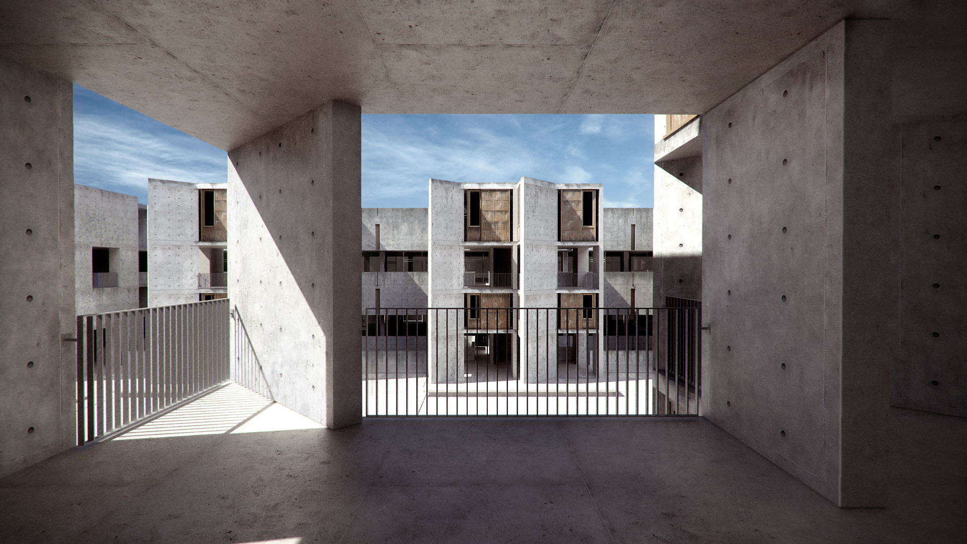

I threatened to try this a while ago, (some of you may recognize one of these from the WIP thread) and finally found myself with a bit of free time.
Used more of a 'teach myself Indigo' exercise than anything else, but as a complete amateur i'm really pleased with the results.
Everything modeled from scratch in SketchUP and I think (from memory) all the textures are custom from images.
Comments & advise always welcome!
Bubs

wlf_alex
Posts: 99
Re: Slak Institute
Post by wlf_alex » Mon May 06, 2013 11:15 am
I like it! Good job. And it is not worse than here:

bubs
Posts: 620
Location: UK
Re: Slak Institute
Post by bubs » Mon May 06, 2013 7:56 pm
Thanks. That evermotion video was everywhere a while ago, and served as my main source of inspiration for quality. It seemed every site / blog I looked at about 3d viz had examples of great work using 3ds max and v-ray.... Since I own neither, (and am not likely to) and I was sure indigo could produce results with the same sort of quality, so I thought I'd have a go! A LOT of trial and error (especially on the water!) But I have to say I enjoyed the process, and I'm loving indigo even more for it! Now to try so.e original work!

Post by Headroom » Mon May 06, 2013 10:29 pm
Very nice renders and not amateurish at all!
It's just that it takes us often longer to get to these results! Only we know, however, what time we spent working on a given project ;-)

Post by CTZn » Tue May 07, 2013 9:28 pm
Great scenery !

Post by Zom-B » Tue May 07, 2013 9:50 pm
bubs wrote:A LOT of trial and error (especially on the water!) But I have to say I enjoyed the process, and I'm loving indigo even more for it! Now to try so.e original work!
Learning stuff the hard way takes time, but the knowledge about the render engine and materials etc. you gain are priceless! Nowadays most people are asking in Forums if problems appear instead of taking a few minutes and trying to solve them by them self...
So kudos for coming that far on this bumpy road :)

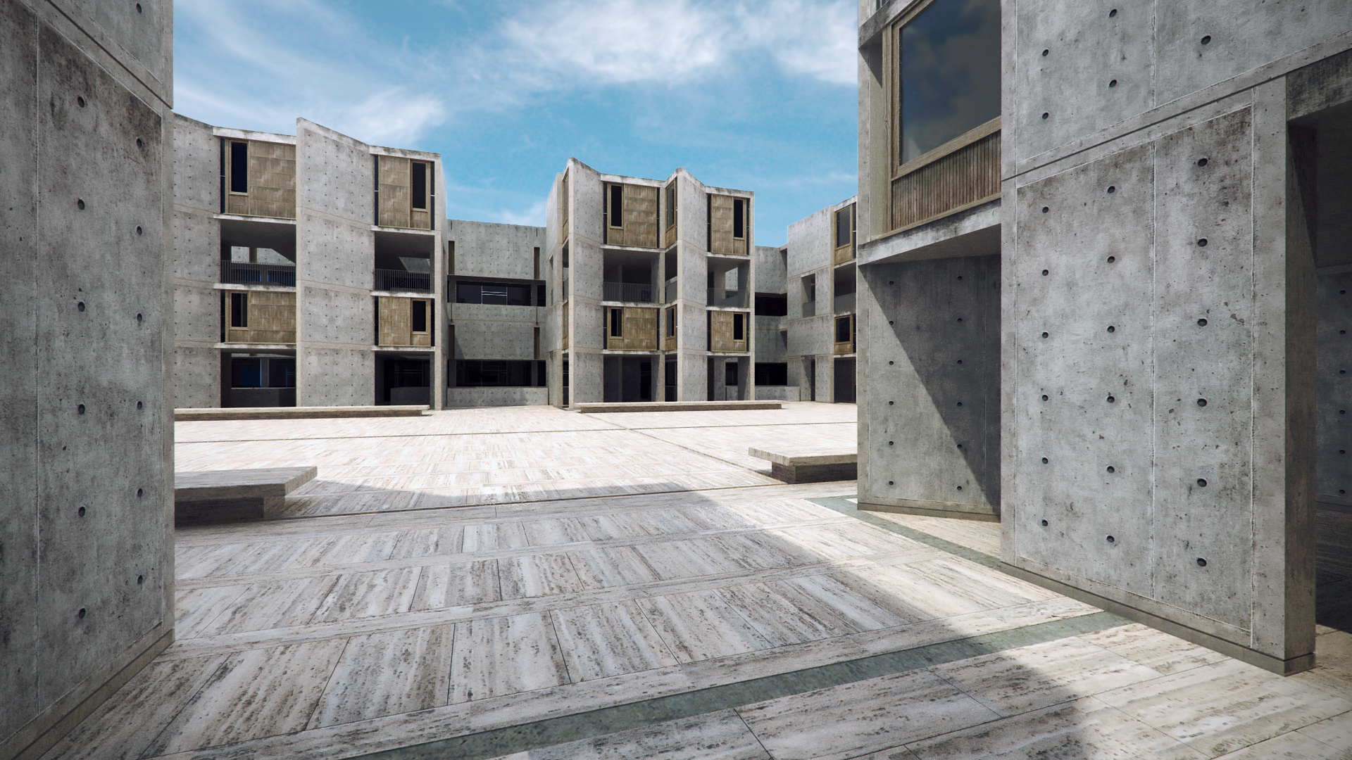

Regarding your scene I like the results a lot.But to push the output even further here two tipps:
- Best to see in "Scene 4.jpg" your floor is very bumpy, but seems to have same reflections inside scratched and damaged areas. To improve this look use a (high contrast) exponent map based on your bump map, to reduce reflection inside this scratches. Aply that texture to exponent channel and maybe also to fresnel scale channel. Another good approach is to use it a a blend texture between a reflective phong material (with very light or no bump mapping) and a diffuse material (that has all the bumpmapping).
That technique will also enhance your other rough but still reflective materials :)
- your sky replacement is quite obvious, like in "Scene 7.jpg" you clearly see aliased edges! Give Indigos alpha render mode a try, combined with some Aperture Diffraction you maybe can push the look even further. (AD glow gets recognized and saved properly by Indigos alpha rendering too !)

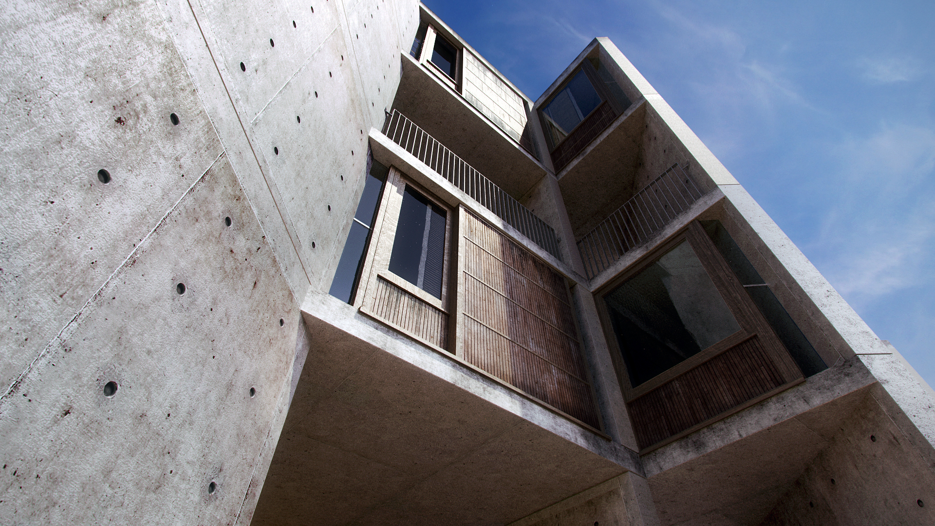

Post by OnoSendai » Tue May 07, 2013 10:09 pm
Looks good.
The biggest problem for me is that the holes in the concrete slabs (bolt holes?) aren't modelled, so the lighting on them is wrong,

Post by StompinTom » Wed May 08, 2013 1:56 am
OnoSendai wrote:(bolt holes?)
Tie holes ;)
Sweet renderings! Overall nice atmosphere, though it would be nice if it were inhabited a bit more (more details in furnishings, material junctions, etc.)

Post by Pibuz » Wed May 08, 2013 8:07 am
I really appreciate the images! Excellent work on the textures (I can't see any seam: very good!), some more work to do on the materials, like Zom-B said.
But please..PLEASE: correct the topic name! You're re-killing Louis Kahn! :lol:
