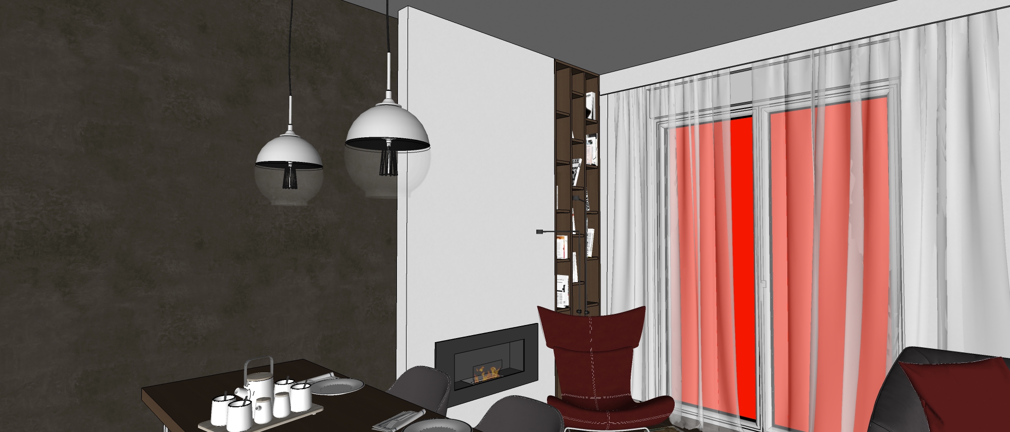

As for your questions. First of all regarding the color, I am using Camera tonemapping and usually agfapan-apx400CD or agfapan-apx100CD cameras.
Smooth shadows come by detailed mesh of the models and geometry of the source of light (not that much though), also out from Env Map.

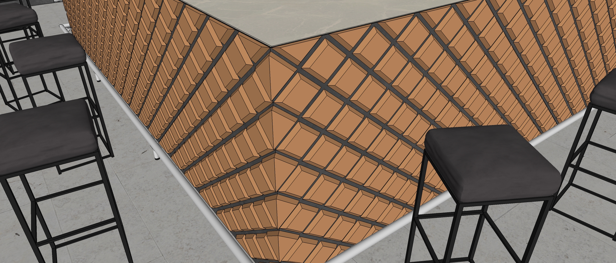

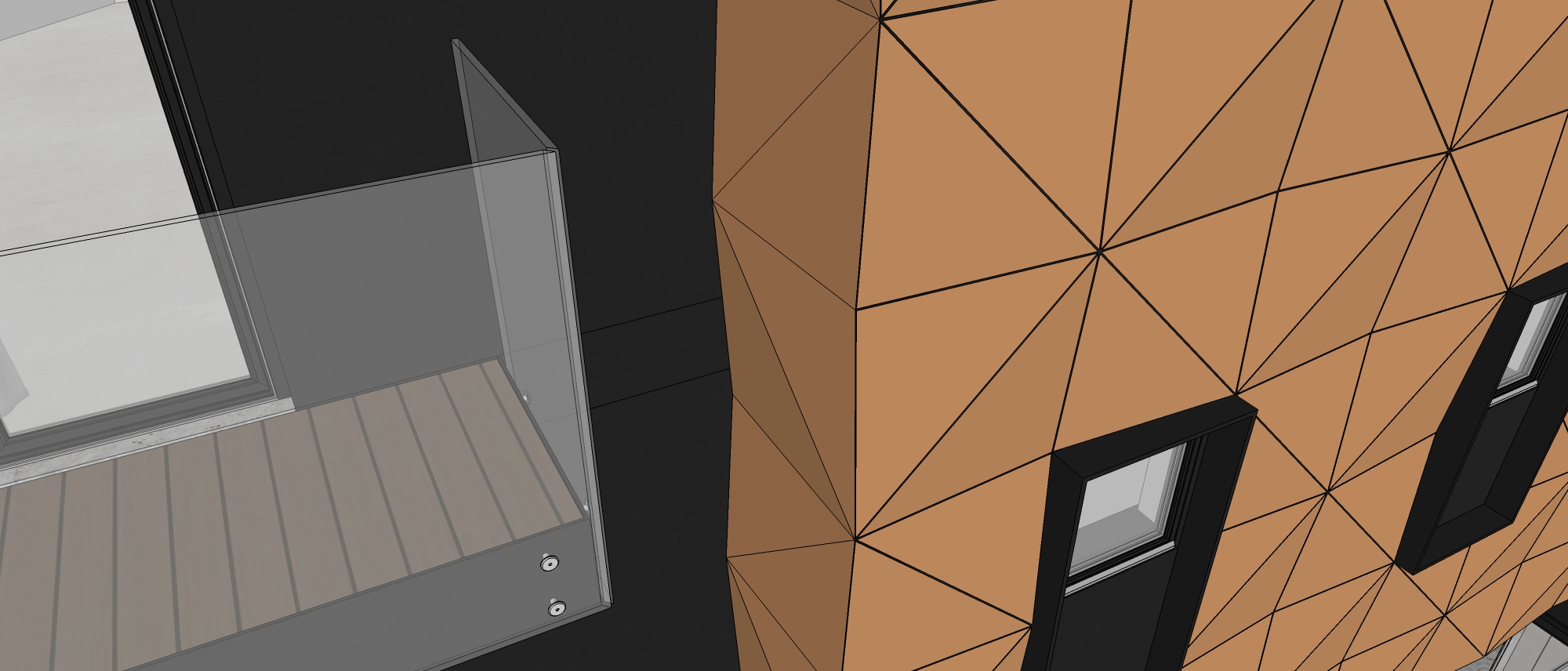

3D panels are simple, in order to see edges visible as in my hotel exterior renders, I made a little gaps between each panel, like 1-2mm.
All in all, it is mostly up to a detailed and good/precise model as for your questions. But good old rule of CGI quality is 30% detailed model, 30% good textures, 30% render settings and 10% is post production. I always skip last 10% simply because I am not skilled with Photoshop nor I want to spend time on it.

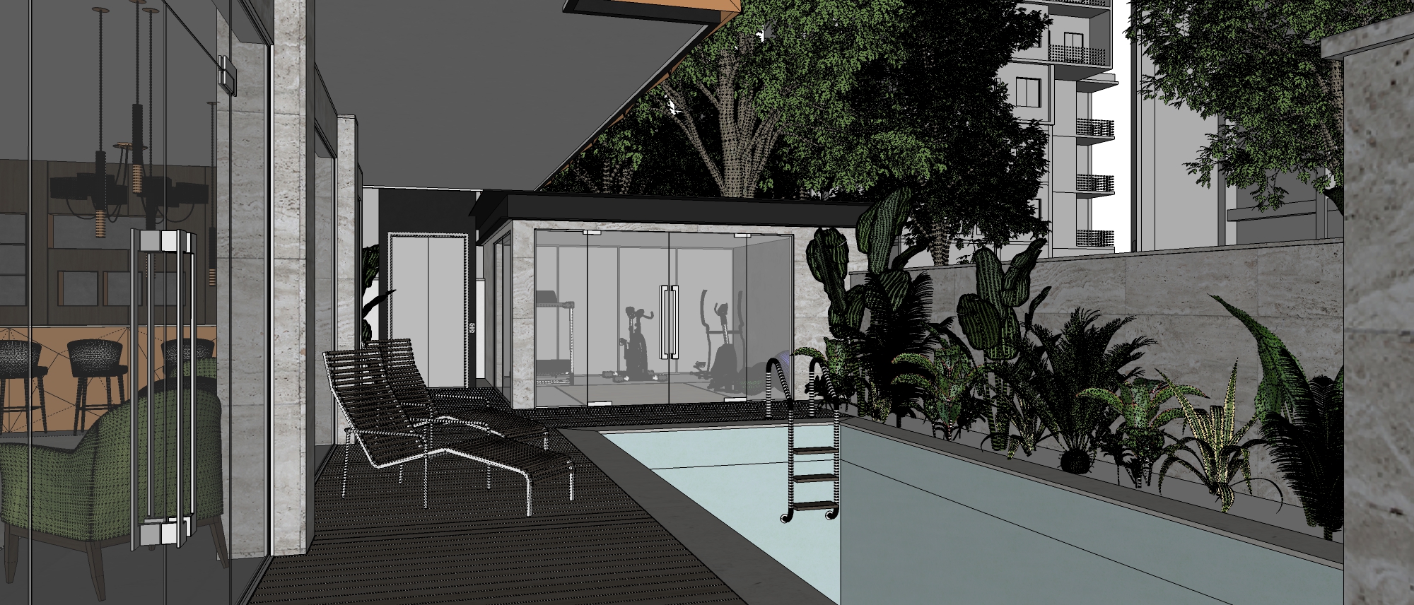

As for my steps, they go as following:
1. Create the model of walls, slabs and roof of main exterior/interior (depending what I am designing) model.
2. Create all openings such as doors, windows as well as fences/railing.
3. Create ground and streets/sidewalks.
4. Make main materials of exterior or interior such as wood/metal material for panels, stucco, concrete, asphalt etc.
5. Put in furniture models and carefully map them when create materials for them.
6. Put in, render preready, plants and trees.
7. Fill in details such as cars, drinks, books etc.
8. Set up rendering settings.
9. Wait till the render is noiseless as possible.

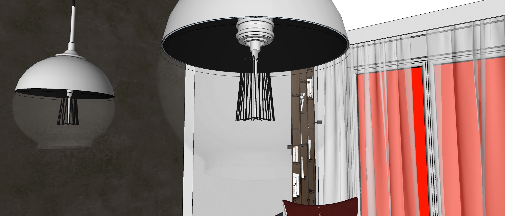

NOTE: it is very important to use layers when creating complex models in SketchUp. Such as "trees", "cars", "details", "furniture" etc.

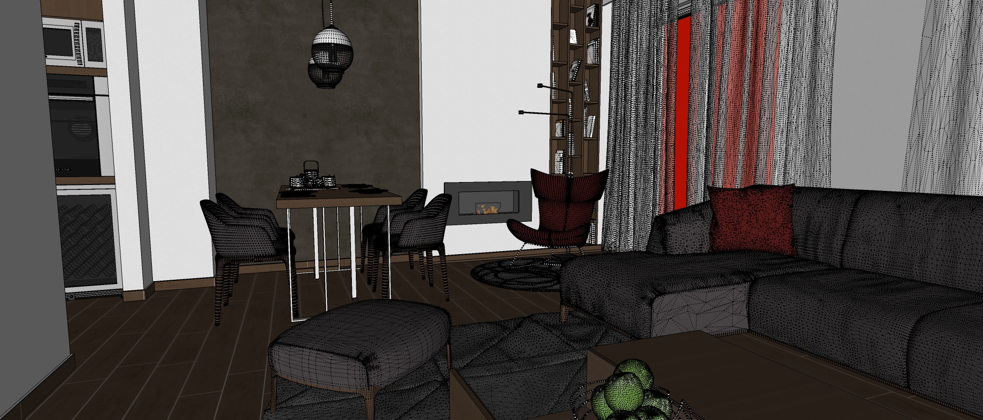

Check out the print screens below.

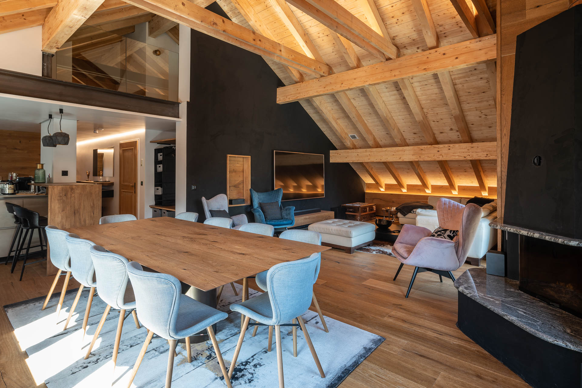

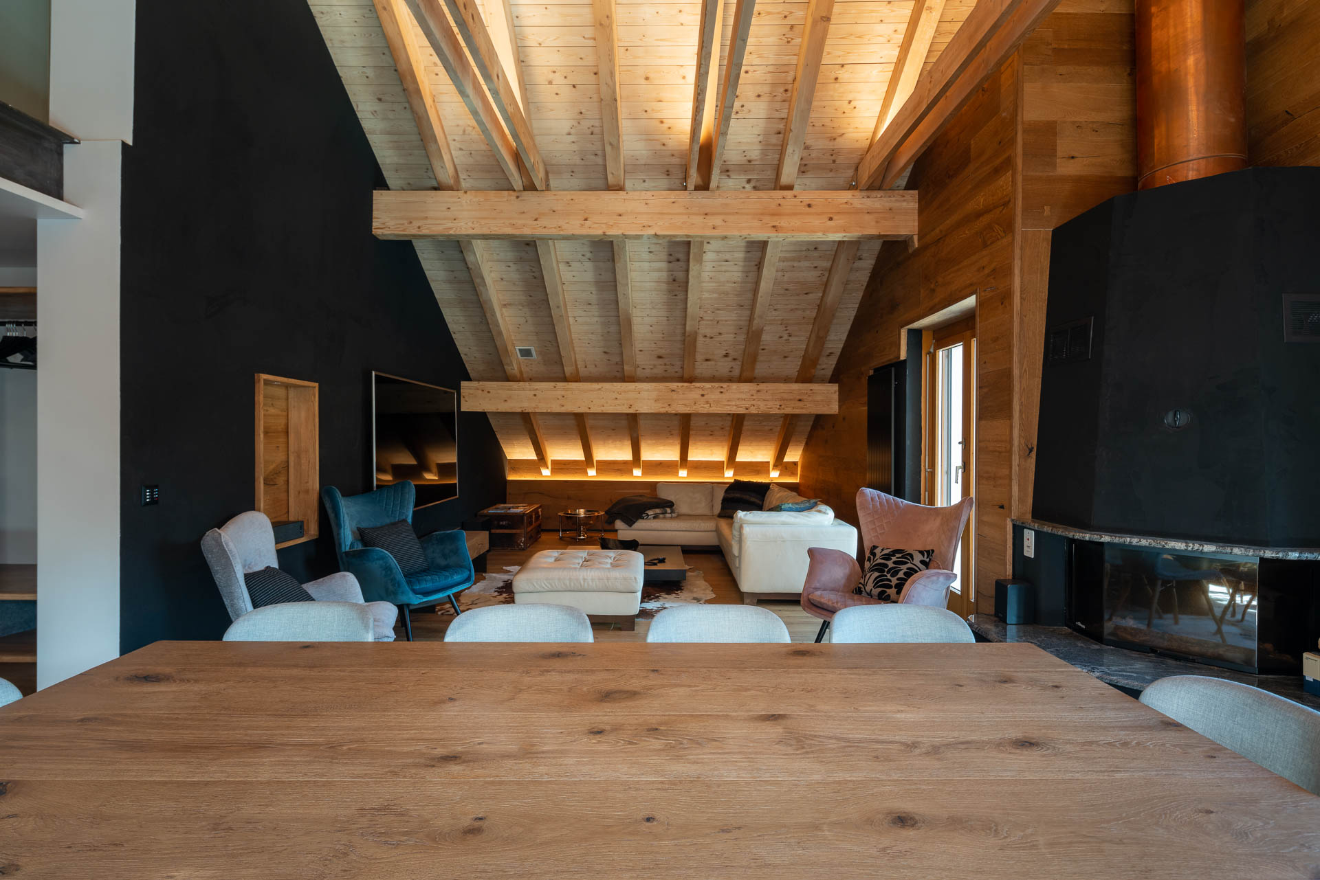

Related to project posted above:
Photos of executed project, just recently forwarded to me by client.
Re: Pikadili89's projects
Always great to see before and afters of the projects. Thanks for these. You did a great job!

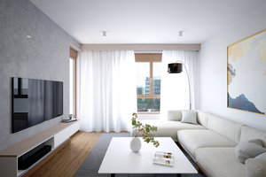

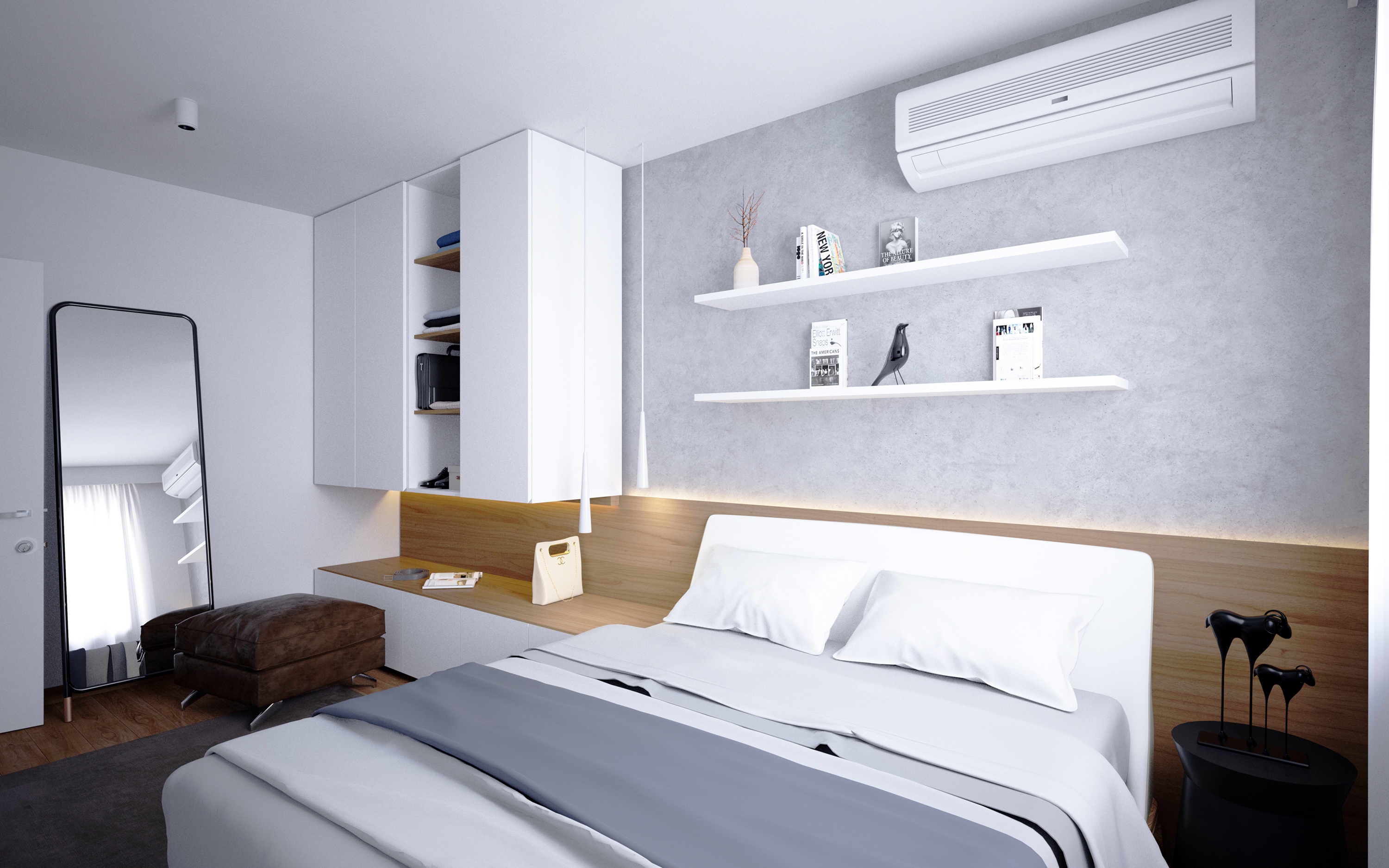

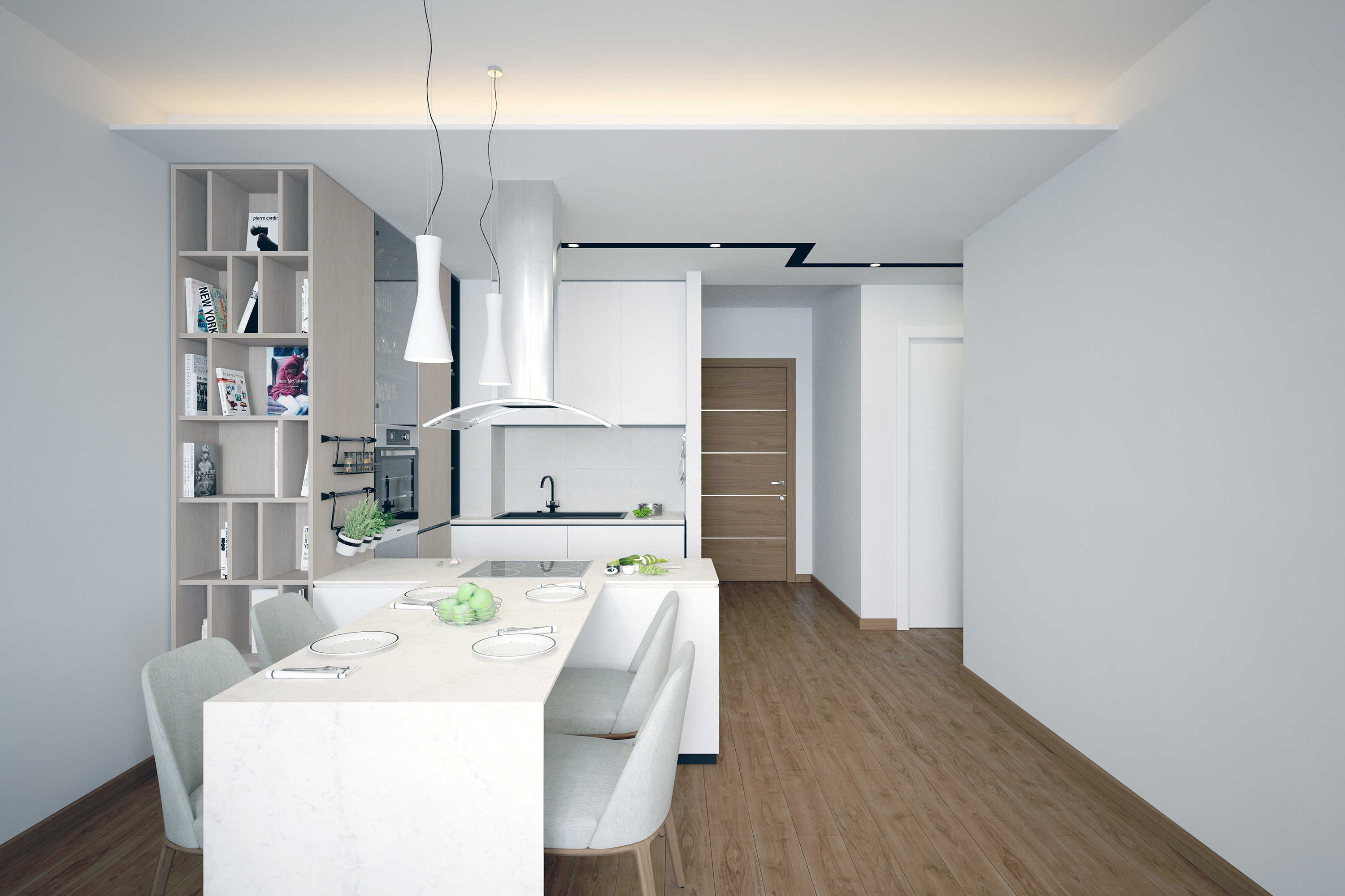

This year's project. Interior design for small apartment in Belgrade, Serbia. Looking forward hearing some critics and advises! Enjoy!
- Oscar J
- Posts: 2204
- 3D Software: Blender
Cool shots! Not entirely convinced by that bed though, looks a bit low poly and maybe you could have used the new fabric material type?
The colour balance in some of the shots is slightly on the cool side. Is that intended?

Hi Oscar,
Ye some shots are on the cool side a bit and no, it was not intended, it was autocolor in Photoshop. For post production knowledge, it goes like this: me < knows nothing guy < noob < average < ....
As for the bed, ye it was before fabric material was introduced, therefor it looks way to plain and not convincing.
Thanks for comments, I appreciate it!

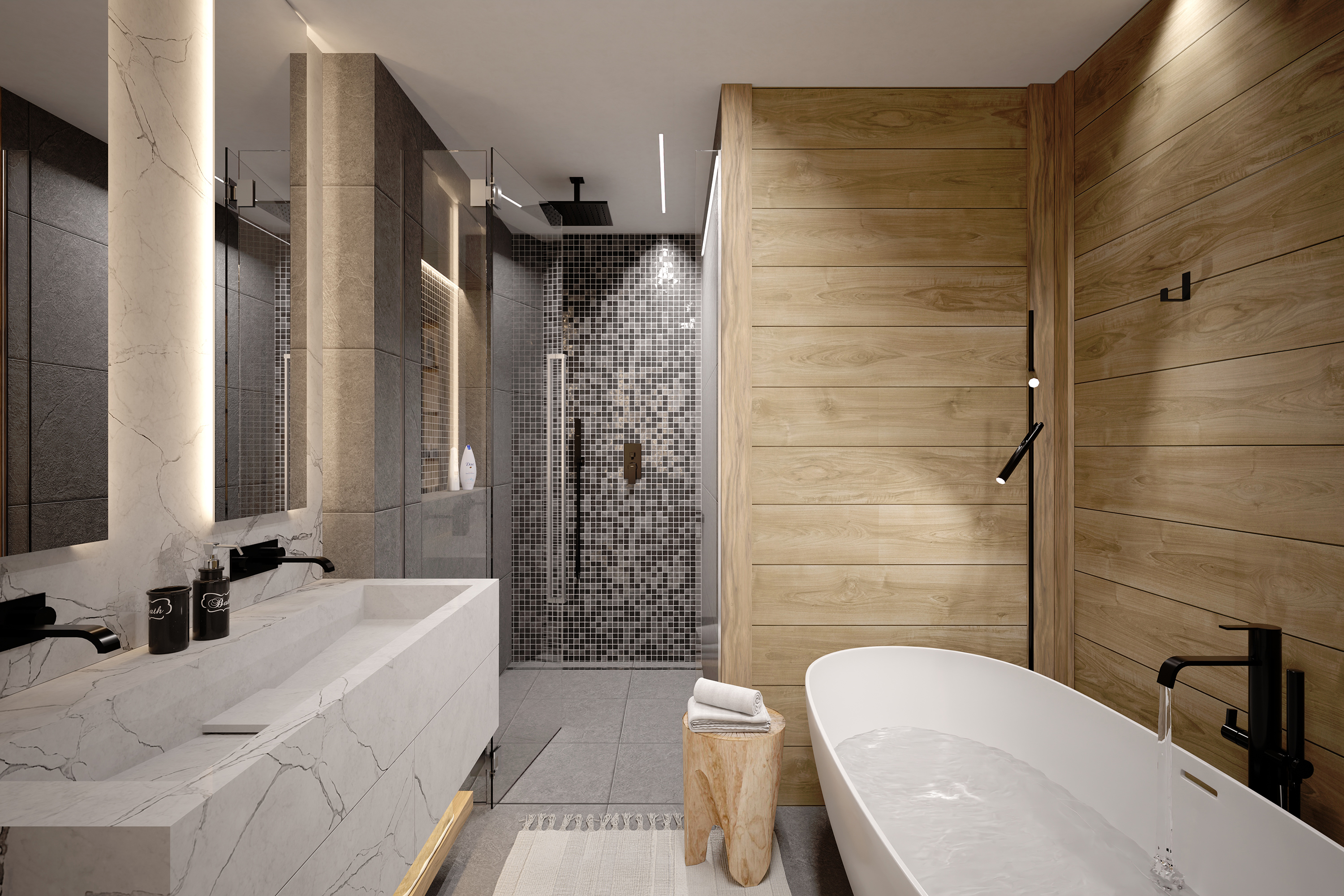

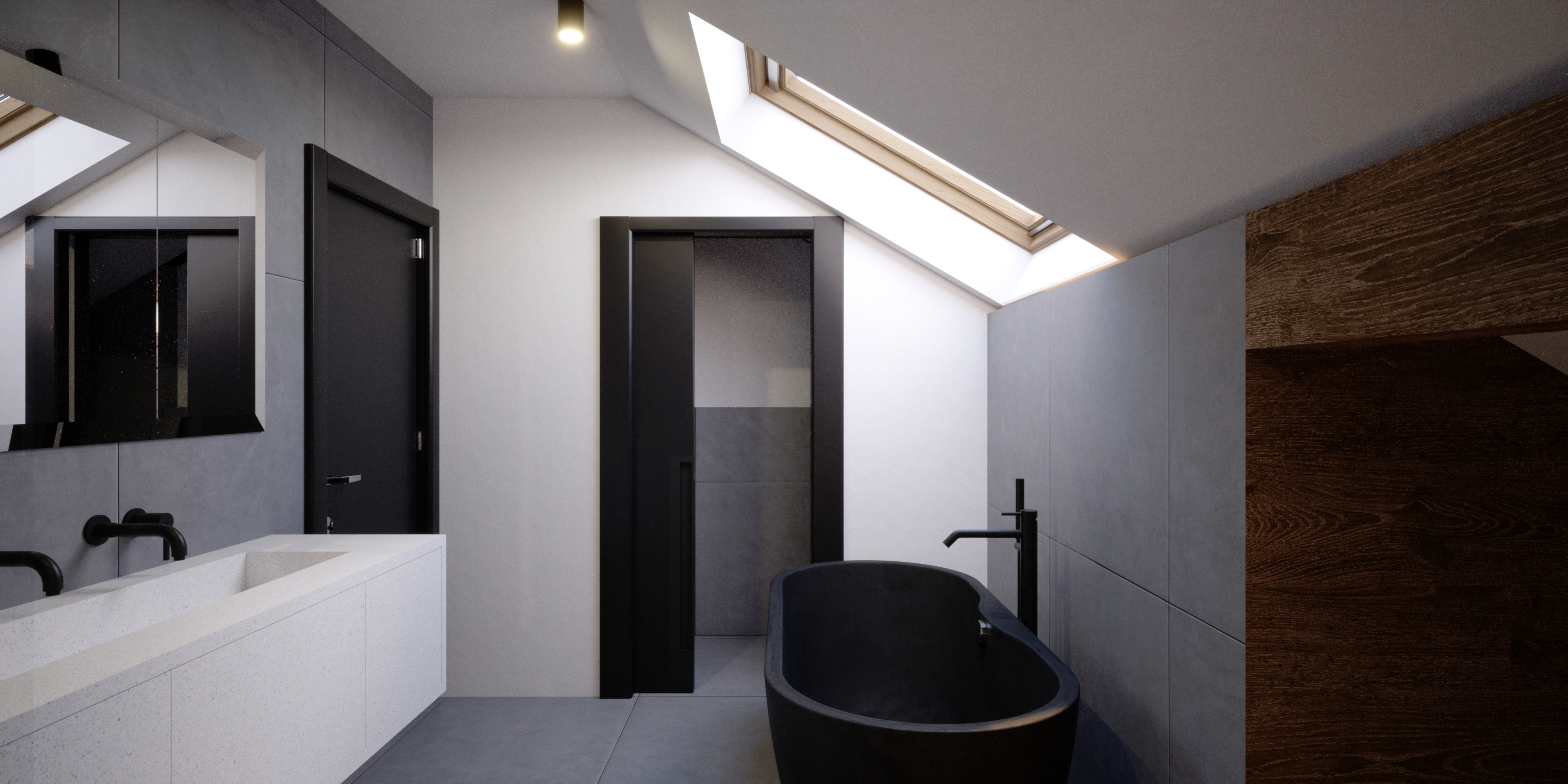

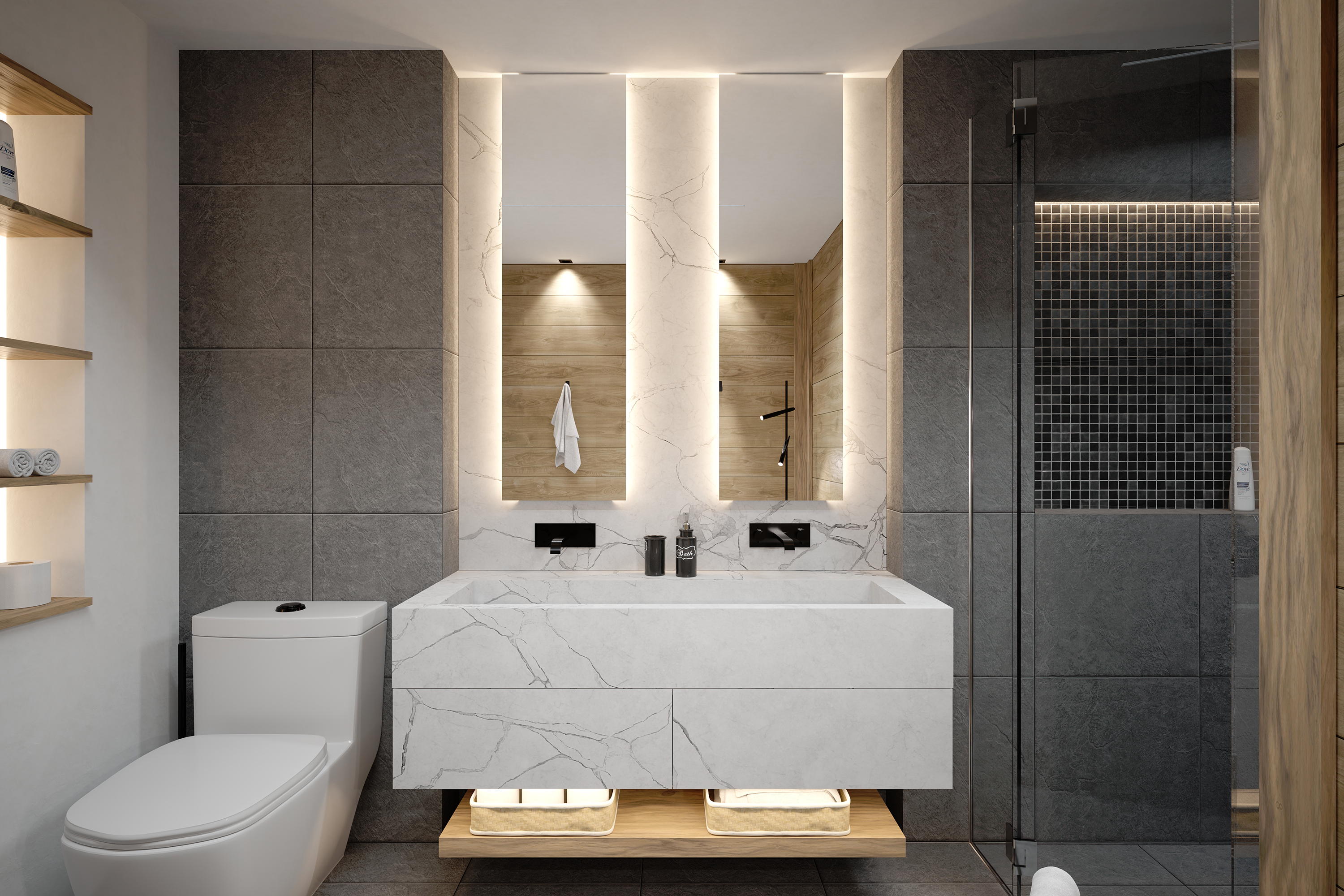

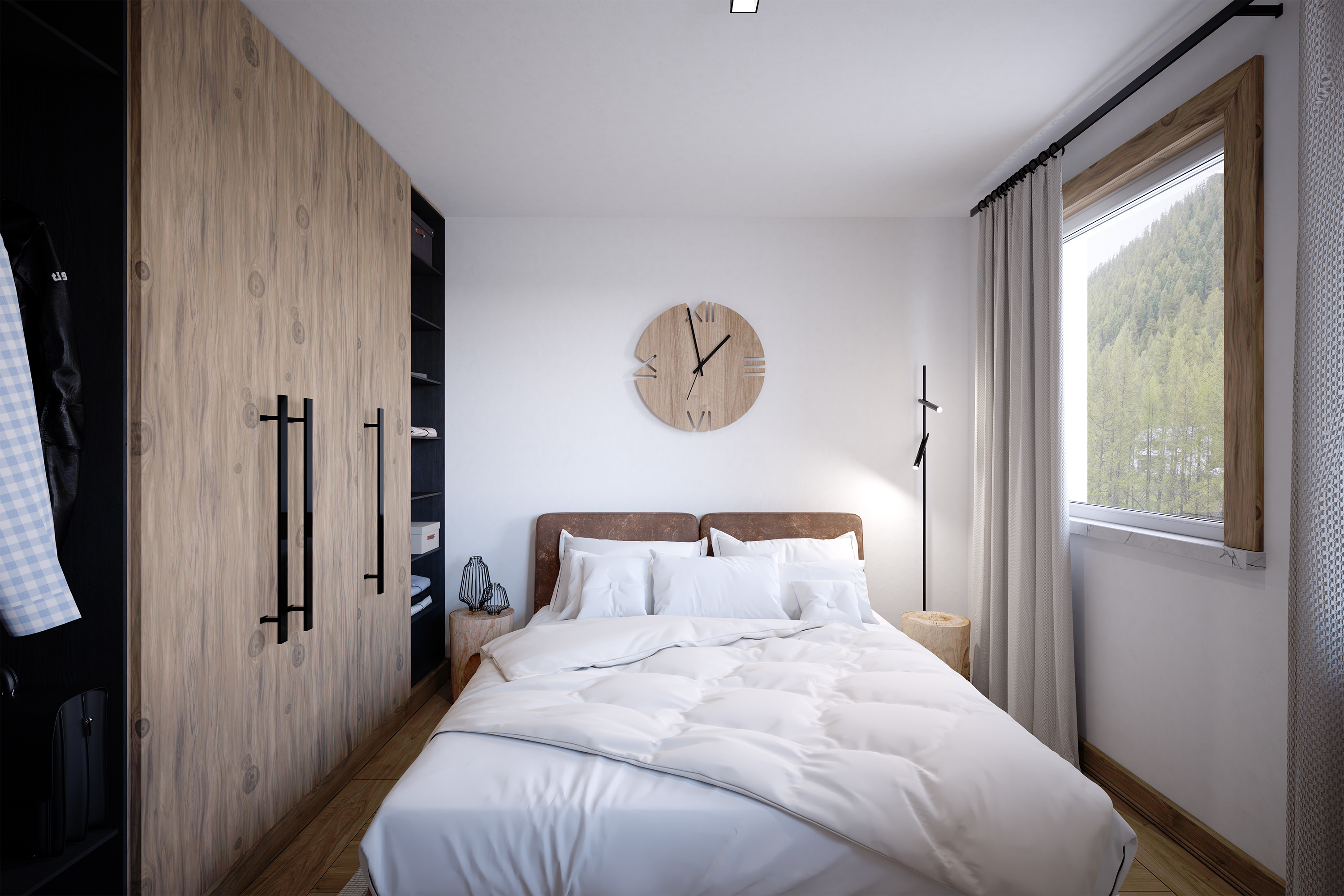

Latest project. Design schematic and design development project of interior design of apartment in Sankt Moritz, Switzerland. Project task was to come up with contemporary chalet style for renting apartment. Looking forward hearing your thoughts. Cheers!

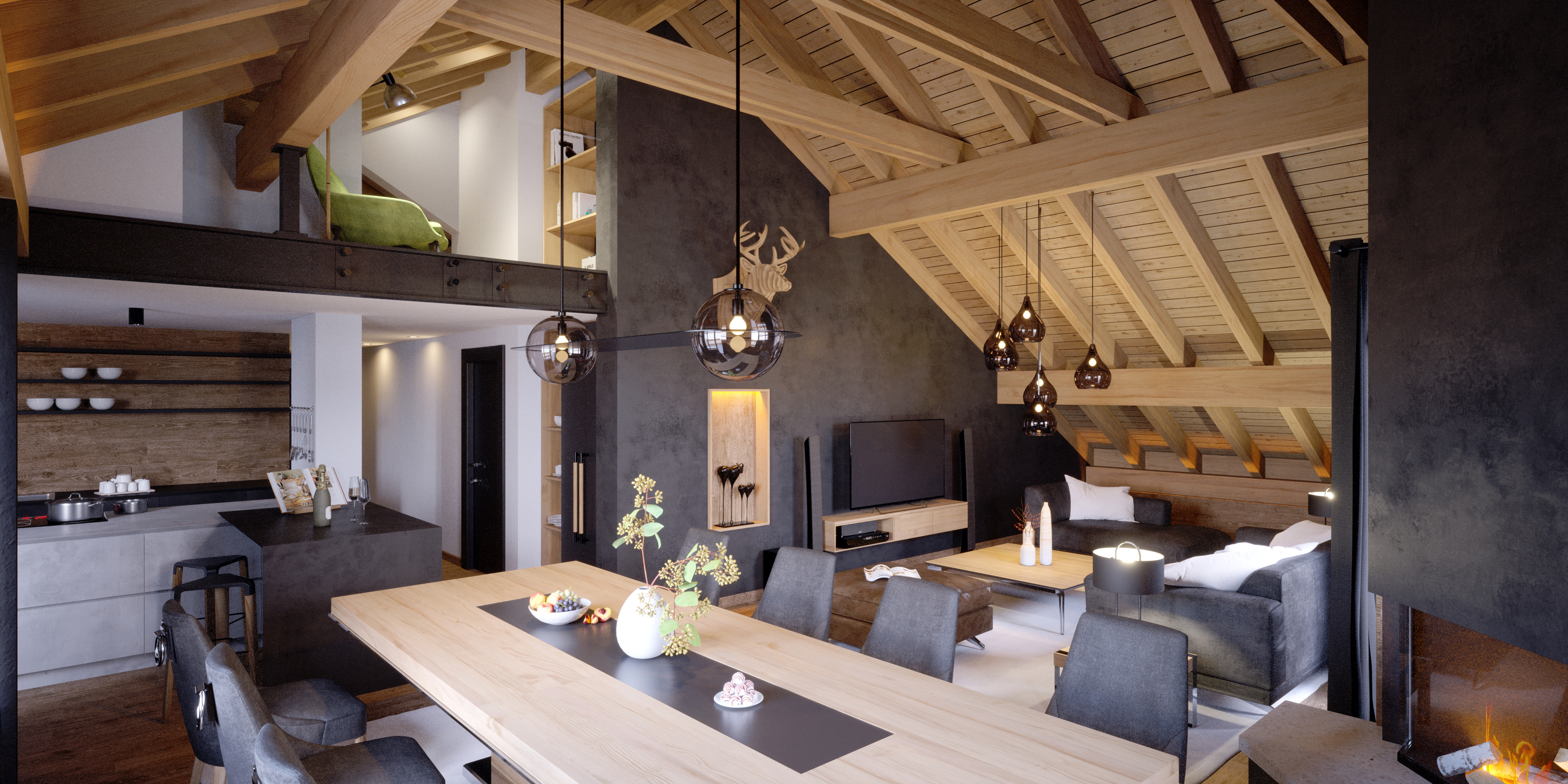

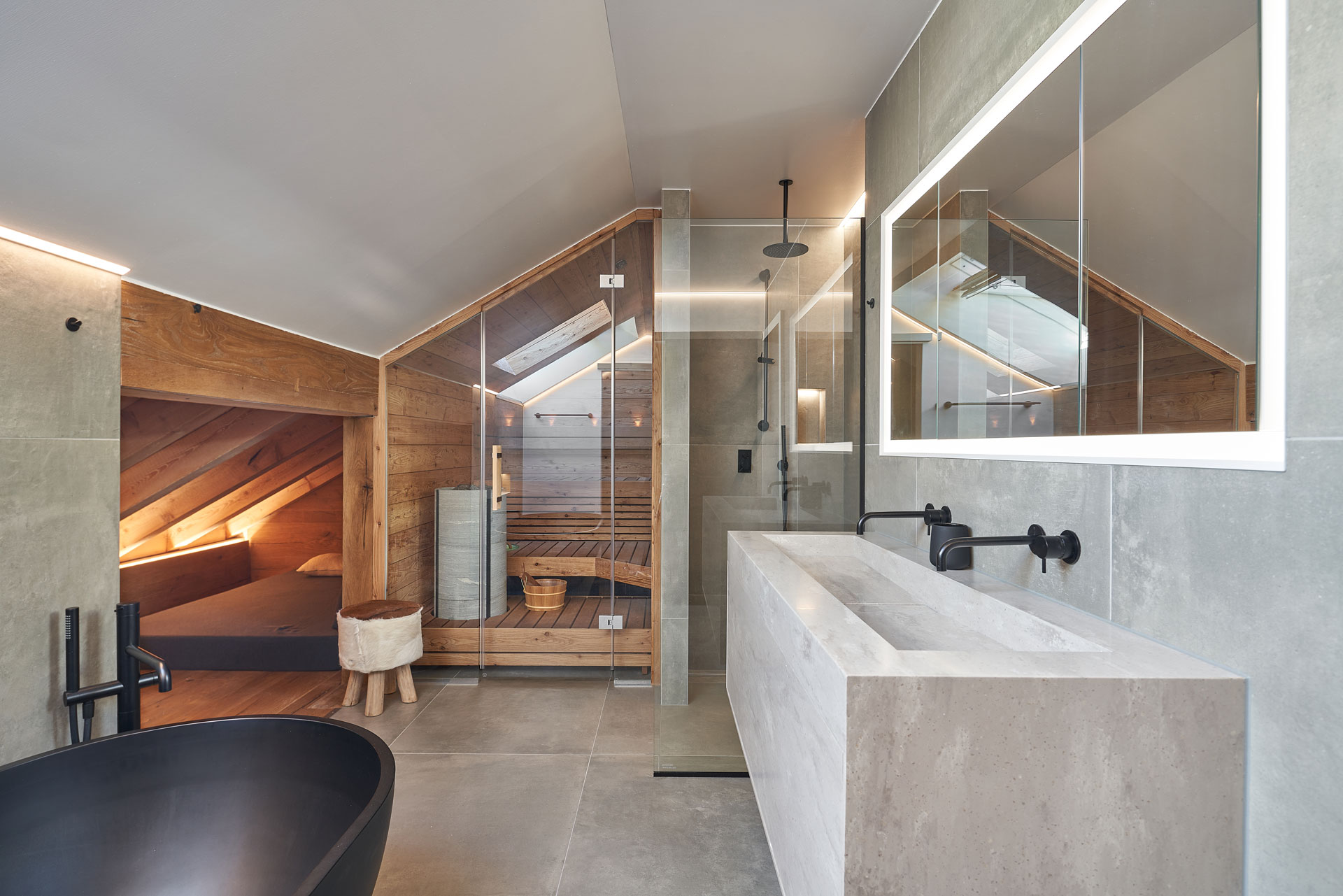

Very nice renders!
The only question I have is about the fire, it looks like it's in a piece of glass, is that intentional?
