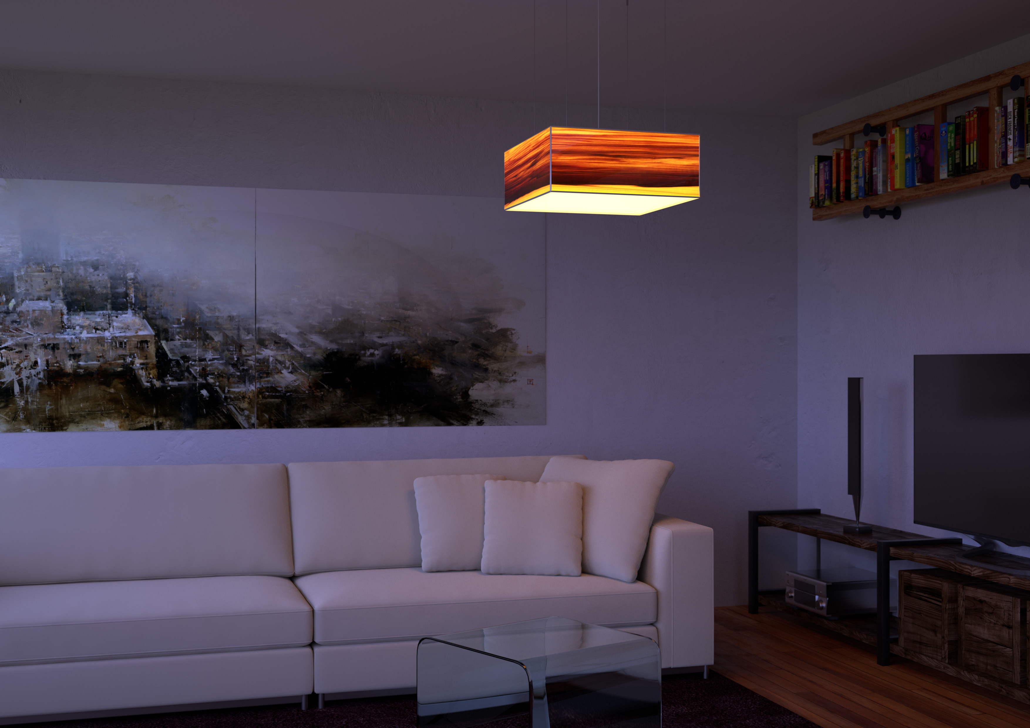

These are great, but they don't look correctly tonemapped. You really need to tonemap these renders!
I see so many potentially great architectural renders that would look much better (not to mention correct) if they were appropriately tonemapped!
- Polinalkrimizei
- Posts: 649
Re: WOODEN product visualisations
Thanks for the comment!
This is indeed one of the many things I simply don't really know about. I usually use the standard camera response functions, preferably the high contrast ones for the lamps.
Do you have an example? Which of the images is the most odd, and how to fix it? Is that something that can be done in post pro?

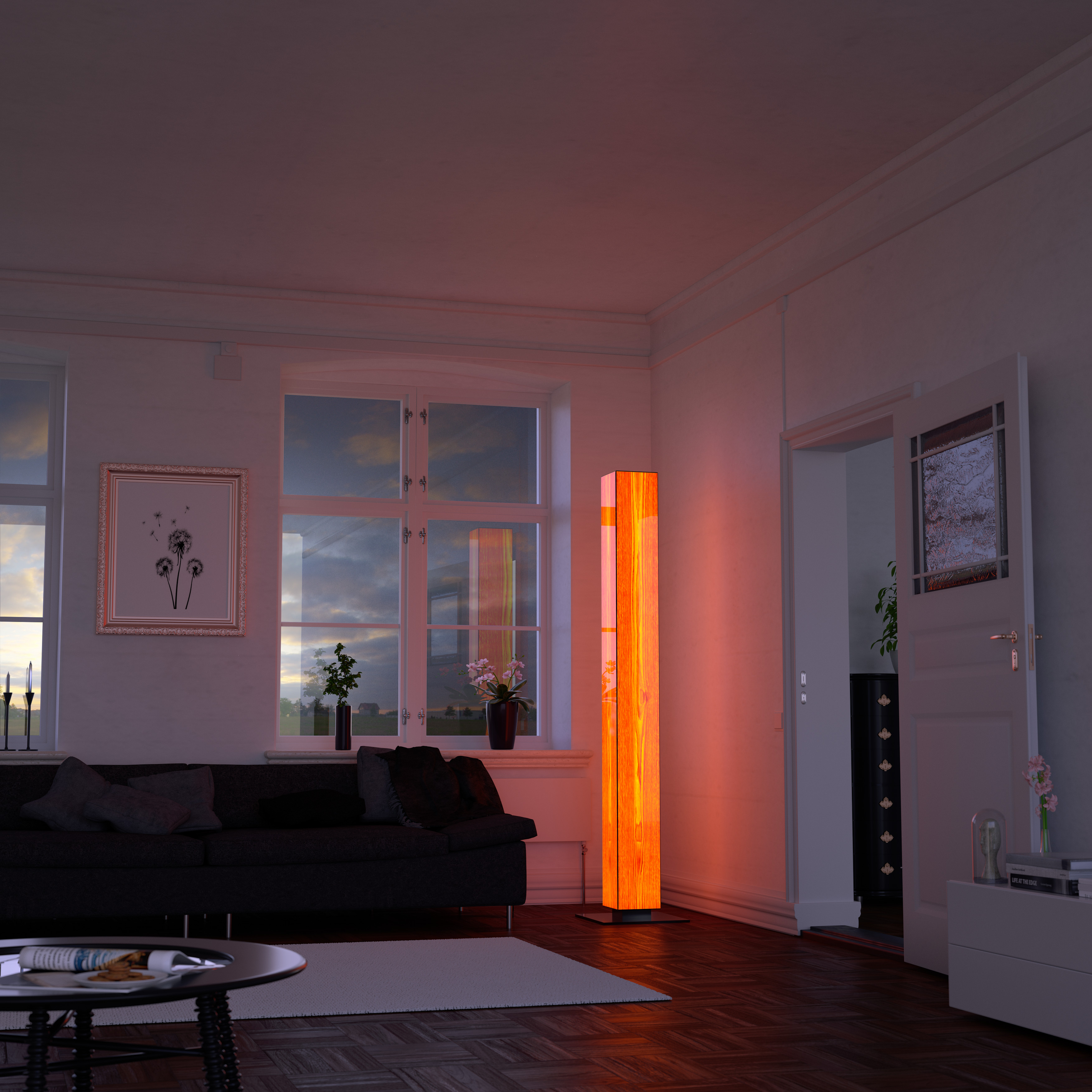

In this one the light seems very unnatural.
http://www.indigorenderer.com/forum/dow ... &mode=view
Also in the daytime version the vase is burning out very unnaturally .
I am not an Indigo user (I came here via BlenderNation...) but in my day job I use Softimage/Houdini/Redshift/Arnold for commercials. The way we work is that we use a lookup table (LUT) while working from the outset. The only way you can be sure of a correct result is by building and tweaking your shaders and lights while viewing through the LUT. You render out linear (as EXRs for example) and do you compositing while looking thought the LUT also. Only for final output is the LUT and the colorspace conversion actually applied to the image.
The key thing to take away here is that you would not be able to take one of your renders and just apply a LUT and expect it to look correct. You need to have been developing your shaders and lighting while viewing through the LUT.

- Polinalkrimizei
- Posts: 649
Hi Fluckrat, that helps a lot, thanks for your info! Will definitely take a longer look into it.
Indeed we used the built in camera response functions for tonemapping, which were modified for the first pictures, to replicate the heavy red tint we found on our early photos. We then realized that the reason for that was a crappy camera
So one reason the tonemapping is bad is crap reference material. Another reason is me being an amateur without professional workflow in this regard. So again, your hints help a lot, thanks for taking the time!

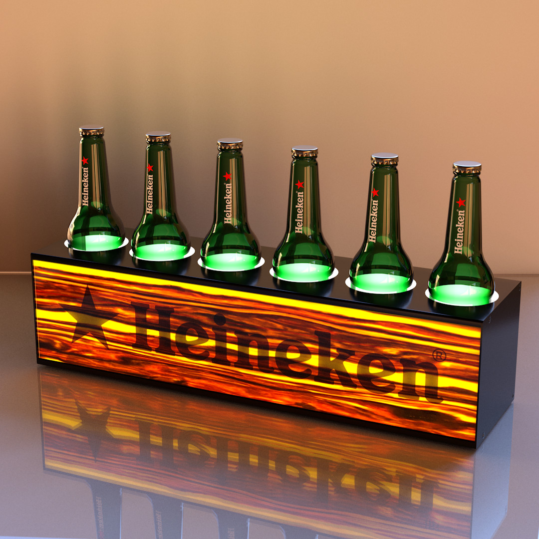

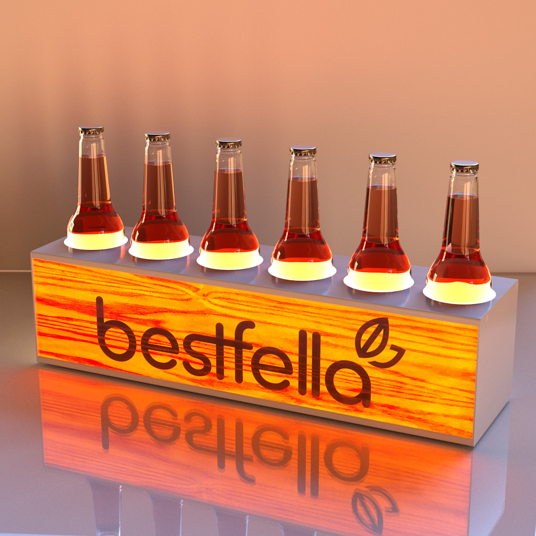

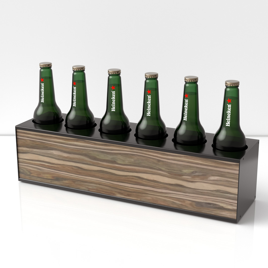

Just to show some action here, these are simple product renders of presentations for beers, juices, etc. involving wood. It's more about the wood, so the bottles are not quite realistic. As a gimmick, the logo just shows up when the light is turned on.
Nice concept! Beer might get a bit warm tho!

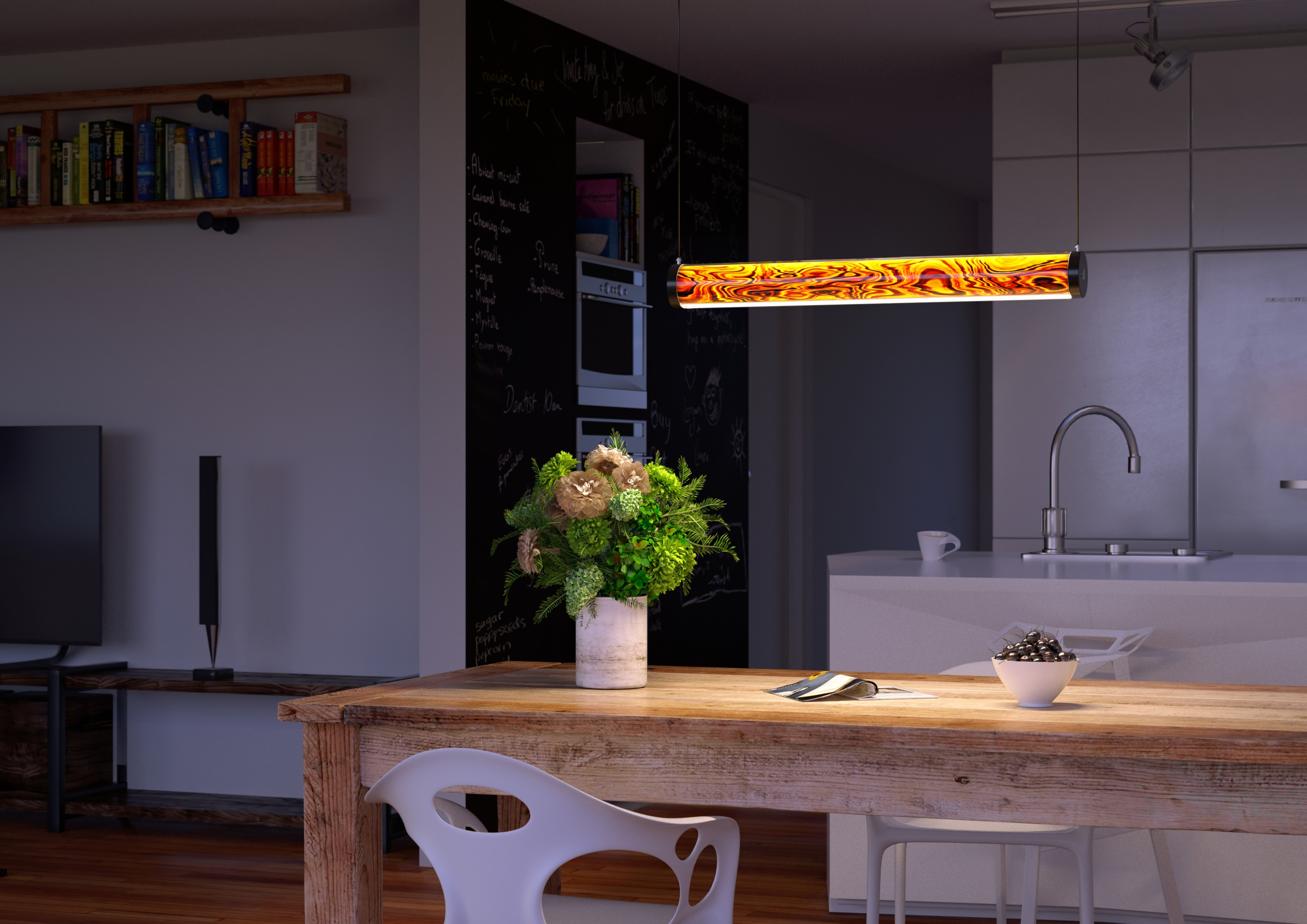

Hello, nothing really new to show off here, but I dug up some old scenes and put in new lamps. The TUBE lamp itself was shown before, but we reworked the cooling system, so new mood pics were needed.
Greetz!

I love lamps! And the renders!
First one's lovely.

The last one looks greatPolinalkrimizei wrote:Just to show some action here, these are simple product renders of presentations for beers, juices, etc. involving wood. It's more about the wood, so the bottles are not quite realistic. As a gimmick, the logo just shows up when the light is turned on.
