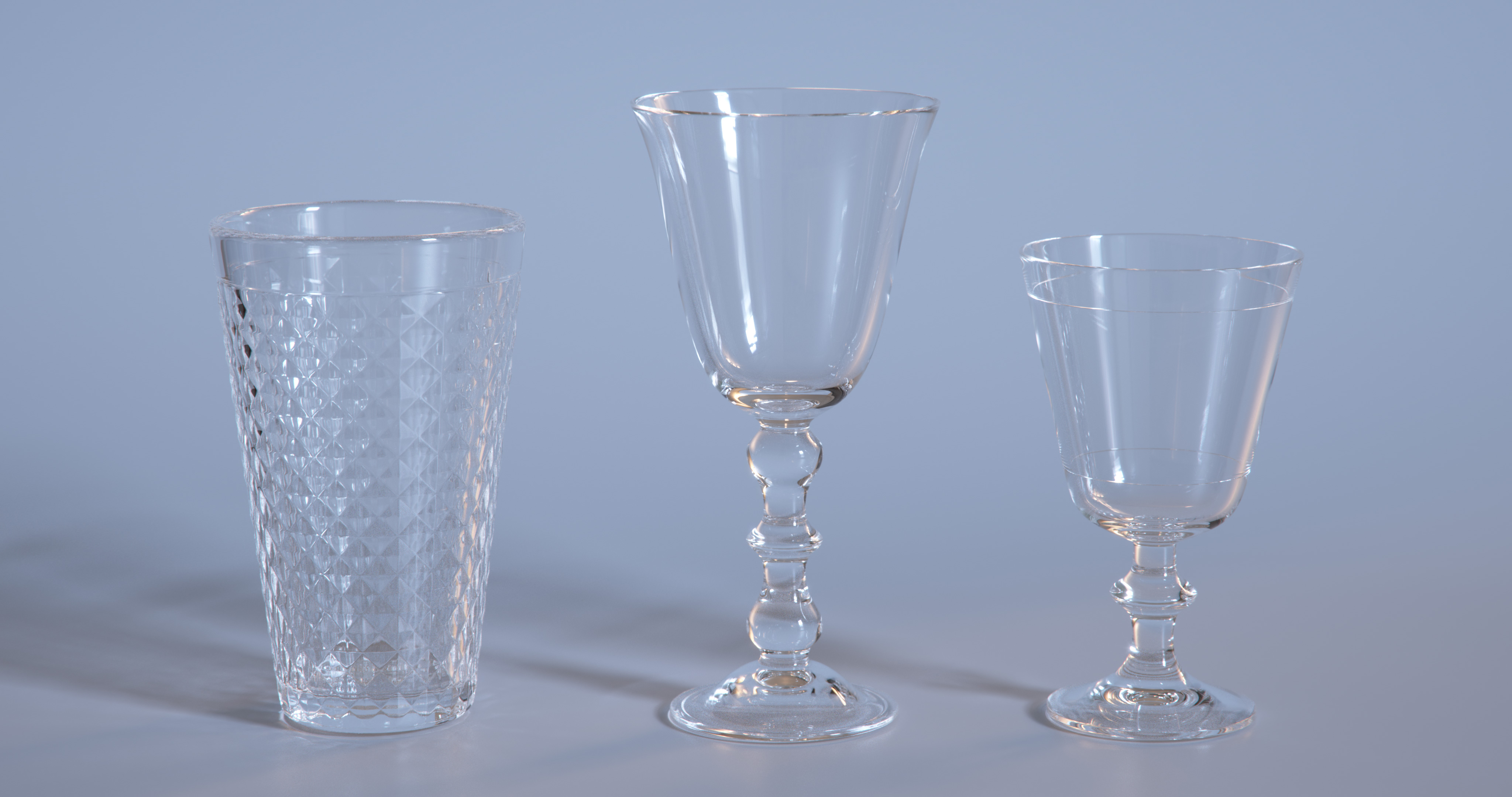

Post by Silverwing » Wed Sep 02, 2015 11:33 am
I still find is fascinating how great simple objects (especially glass) can look with indigo.
Really sexy :-)
As always small color and contrast corrections in AfterEffects.
Cheers,
Raphael
Render Method: MLT BiDir
Resolution: 4096x2160 px
Rendertime: 4h
Worth Mentioning: Lit with a single HDRI, Saved as a untonemapped EXR
You don´t dream in cryo.
