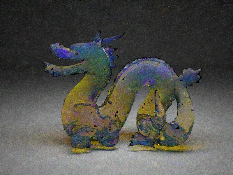

My material code is this:
	<medium>
		<name>DragonMaterial</name>
		<precedence>10</precedence>
		<basic>
			<ior>1.2</ior>
			<absorption_coefficient_spectrum>
				<rgb>
					<rgb>0 4.5 5</rgb>
				</rgb>
			</absorption_coefficient_spectrum>
			<subsurface_scattering>
				<scattering_coefficient_spectrum>
					<rgb>
						<rgb>4 20 200</rgb>
					</rgb>
				</scattering_coefficient_spectrum>
				<phase_function>
					<uniform/>
				</phase_function>
			</subsurface_scattering>
		</basic>
	</medium>
	<material>
		<specular>
			<transparent>true</transparent>
			<internal_medium_name>DragonMaterial</internal_medium_name>
		</specular>
	</material>
Seems almost the same to me, doesn't it? The result, however, looks nothing like the original post:
What am I doing wrong?
