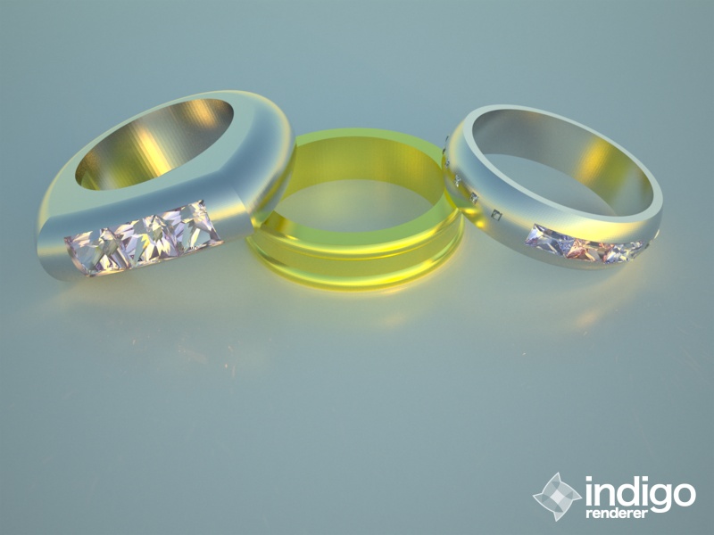

This is probably the first thing I have actually made with indigo + blender.

Post by Pibuz » Wed Jan 13, 2010 1:57 am
Hi andynerd, welcome to the forum!
I guess you need to look for some reference renders in order to achieve more realistic results. Here is only a start, but don't drop it: there's always something more to learn. Object visualisations are usually done with a black environment, setting sort of a studio scene, with light panels and stuff.
Try some other light studies and come back! I bet it will be a nice work.

Thanks for the response, yes I know that there is a lot to learn still. I think there is a lot more I could do with it but I used this as my grade 11 tech final so I was proud of it and posted it here. There are a lot more things I wish to do with indigo. Overall I have just found a large lack of beginner tutorials. Everything I did there I learned myself without any tutorials.

andynerd wrote:Thanks for the response, yes I know that there is a lot to learn still. I think there is a lot more I could do with it but I used this as my grade 11 tech final so I was proud of it and posted it here. There are a lot more things I wish to do with indigo. Overall I have just found a large lack of beginner tutorials. Everything I did there I learned myself without any tutorials.
There is a lot of useful information at this forum and you can always ask. As for the info, I can recommend dmn's thread a lot.
As for the render, maybe these tips would be useful for you:
- for the gold use Au.nk and for silver - Ag.nk accordingly. It will greatly improve the appearance of the rings.
- use studio setup (something like here), not the sun/sky
- real world scale is very needed, so check
- use bevels (actually minibevels :wink: ) so the corners are not so perfect
- make the inner part of the ring smooth
- use tiny bump or scratches, so the surface is not so perfect
- play with composition
That's my 2 cents. Great start, by the way. :)
