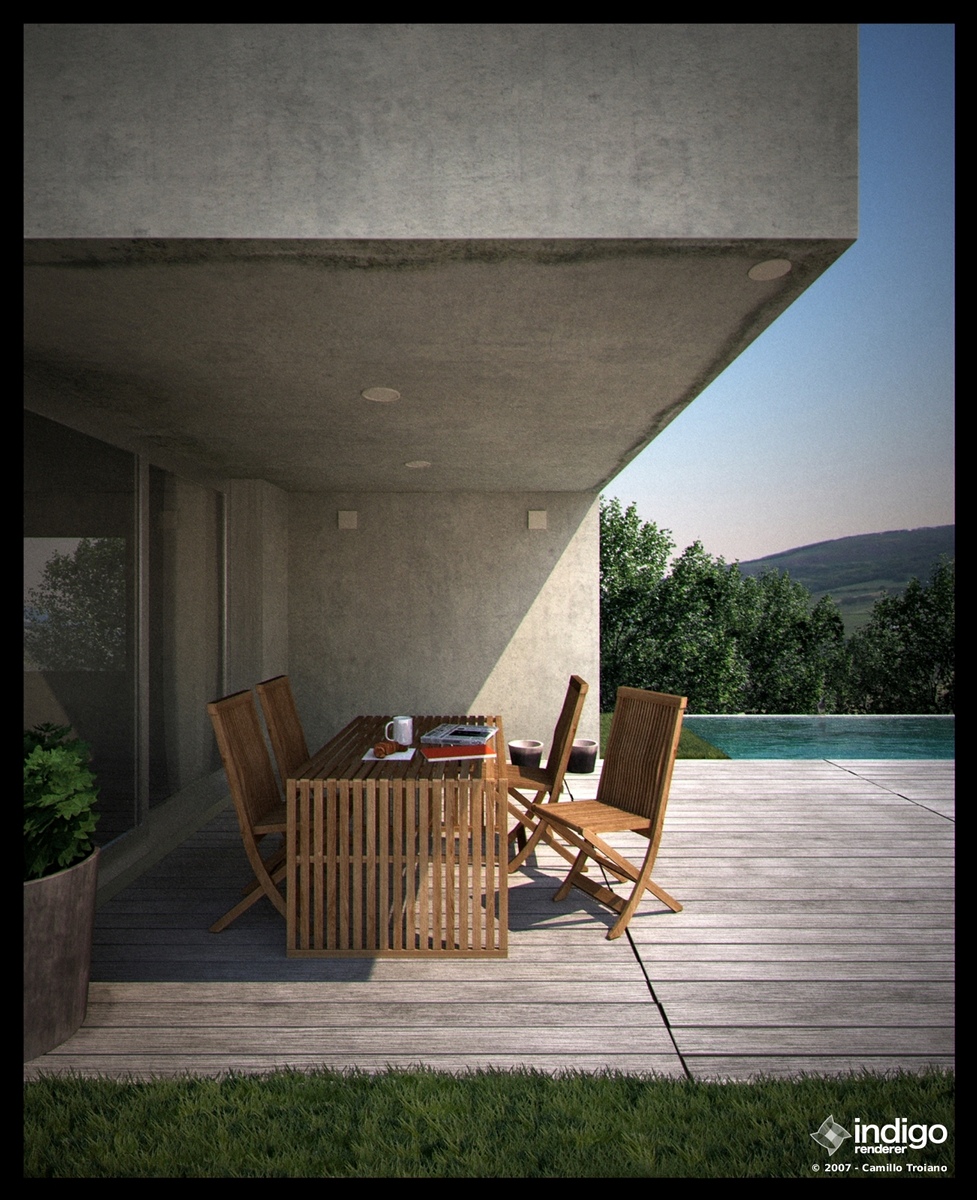

Hi all,
the final version (for now, maybe :wink: ) of my last work.
Hope you like it.
Bye bye
drBouvierLeduc

That is really good !
Everything's top notch, except maybe the wood floor wich looks a little flat.
I'd really like to know how you did get that camera angle ? I mean, there should be some distortion because of the perspective.

it's simply the blender camera pointing at y direction with 16mm lenses.

@kram -> I thought you had to use some shift function, or something. 16mm, pointing at y direction ? good to know, will try that

ok, don't tell lies - this is a photo, right?
top notch. :)

A little question for technicians: why there's a vignetting effect in the rendering (it's not a postpro effect)...maybe it's the camera tonemapping...maybe not, because the untonemapped exr has this effect too... don't understand... :?:

'cause it's realistic and Indigo is there, for realism ;)
It's a physically correct simulation of a camera with the settings, you used ;) (16mm)

nice!!!!
some bloom may help the overall quality....play with violet a little..... :wink:

then, the external tone mapping falls aside, though...
you should try bloom'n'glare and then, either see, which one looks better, or maybe, you're able to add the effect in the other pic, too, by making a difference map and filter it... dunno, if that works in any way :?

needs to be rendered for far longer IMO, the sky isn't fully smooth yet
2000 samples minimum!

great render !
how did you texture the concrete ?? i want to make s'thing similar but texturing is a pain in the ...
did you make the texture yourself ? all tips would com in handy :)

Very nice work. Impressive in all respects.
Adding to Kram's post, I also think the vignetting is a function of using such a wide angle. That would produce strong vignetting in real life.
I wouldn't bother about rendering it longer. It can't really get any cleaner than that.
