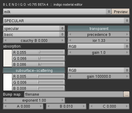

Can you give some material tips? I tested the milk material from the other thread, but for some reason i cant douplicate it. What's the scale of your scene? Do you use glossy transparency?
Suvakas
[edit] Can you confirm that you are using glossy? I turned on glossy and it seemed to do the thrick. 8)

Well, suvakas, my glasses are about 11cm high. And my material settings are...

and in blendigo:
My milk settings in blendigo...

Ok. You are not using glossy, but your scattering coef. is 100 times higher than what i have. I'll test it right away. Thanks!
Suvakas
[edit] Yep, it's working. :wink:

DaveC:
while there are glasses with that high absorption, most normal clear glasses would have much less absorption, as Suvakas said.

Yes, the glasses do look a bit dark, don't they. I don't know why. The absorption was minimal. C'est la vie. Thanks for the nice comments. :D

What's the cauchy_b for glasses?

suvakas wrote:What's the cauchy_b for glasses?
Cauchy B for glass SHOULD be 0.003-ish. But for some reason, I used zero in these scenes. :o
