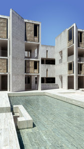

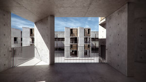

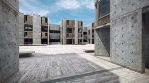

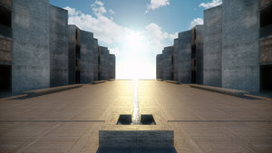

I threatened to try this a while ago, (some of you may recognize one of these from the WIP thread) and finally found myself with a bit of free time.
Used more of a 'teach myself Indigo' exercise than anything else, but as a complete amateur i'm really pleased with the results.
Everything modeled from scratch in SketchUP and I think (from memory) all the textures are custom from images.
Comments & advise always welcome!
Bubs

Very nice renders and not amateurish at all!
It's just that it takes us often longer to get to these results! Only we know, however, what time we spent working on a given project ;-)

Regarding your scene I like the results a lot.But to push the output even further here two tipps:
- Best to see in "Scene 4.jpg" your floor is very bumpy, but seems to have same reflections inside scratched and damaged areas. To improve this look use a (high contrast) exponent map based on your bump map, to reduce reflection inside this scratches. Aply that texture to exponent channel and maybe also to fresnel scale channel. Another good approach is to use it a a blend texture between a reflective phong material (with very light or no bump mapping) and a diffuse material (that has all the bumpmapping).
That technique will also enhance your other rough but still reflective materials :)
- your sky replacement is quite obvious, like in "Scene 7.jpg" you clearly see aliased edges! Give Indigos alpha render mode a try, combined with some Aperture Diffraction you maybe can push the look even further. (AD glow gets recognized and saved properly by Indigos alpha rendering too !)

Looks good.
The biggest problem for me is that the holes in the concrete slabs (bolt holes?) aren't modelled, so the lighting on them is wrong,

Tie holes ;)
Sweet renderings! Overall nice atmosphere, though it would be nice if it were inhabited a bit more (more details in furnishings, material junctions, etc.)

I really appreciate the images! Excellent work on the textures (I can't see any seam: very good!), some more work to do on the materials, like Zom-B said.
