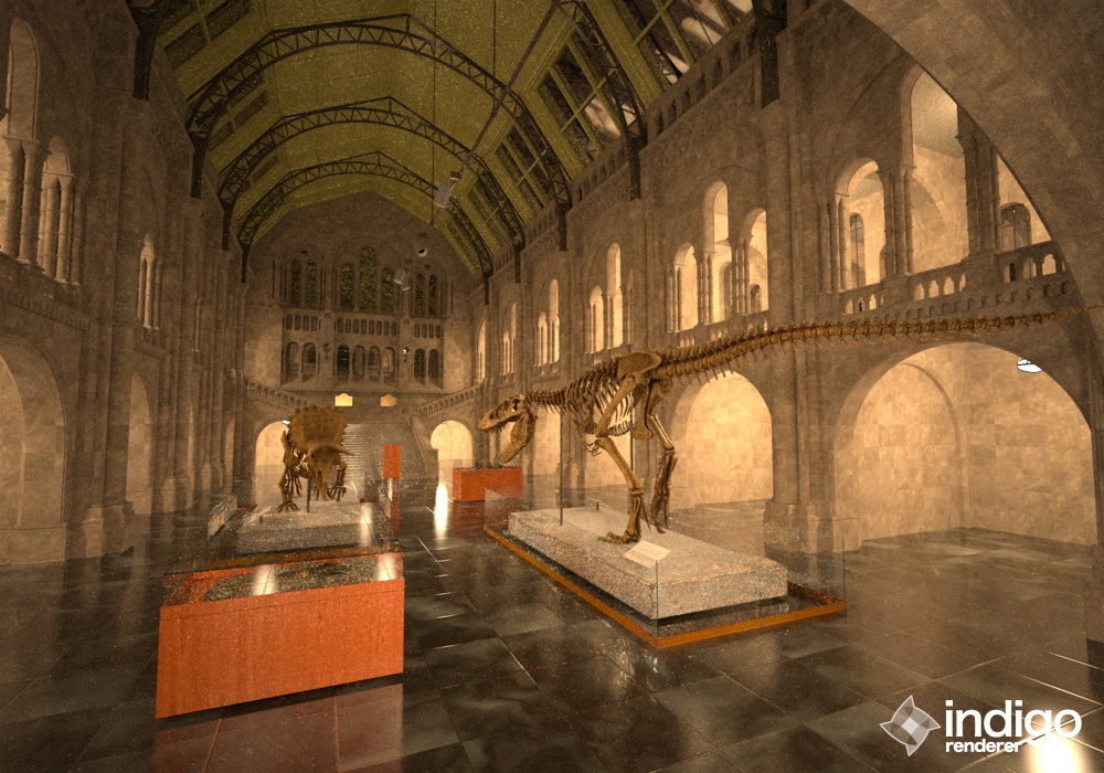

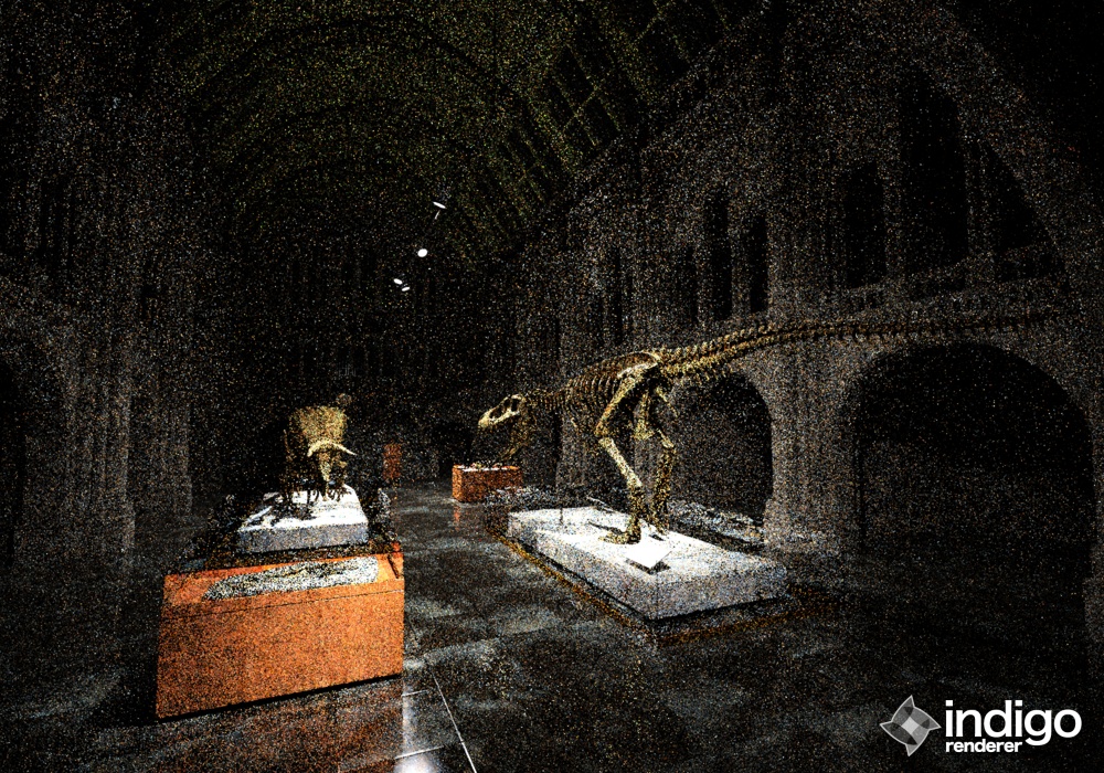

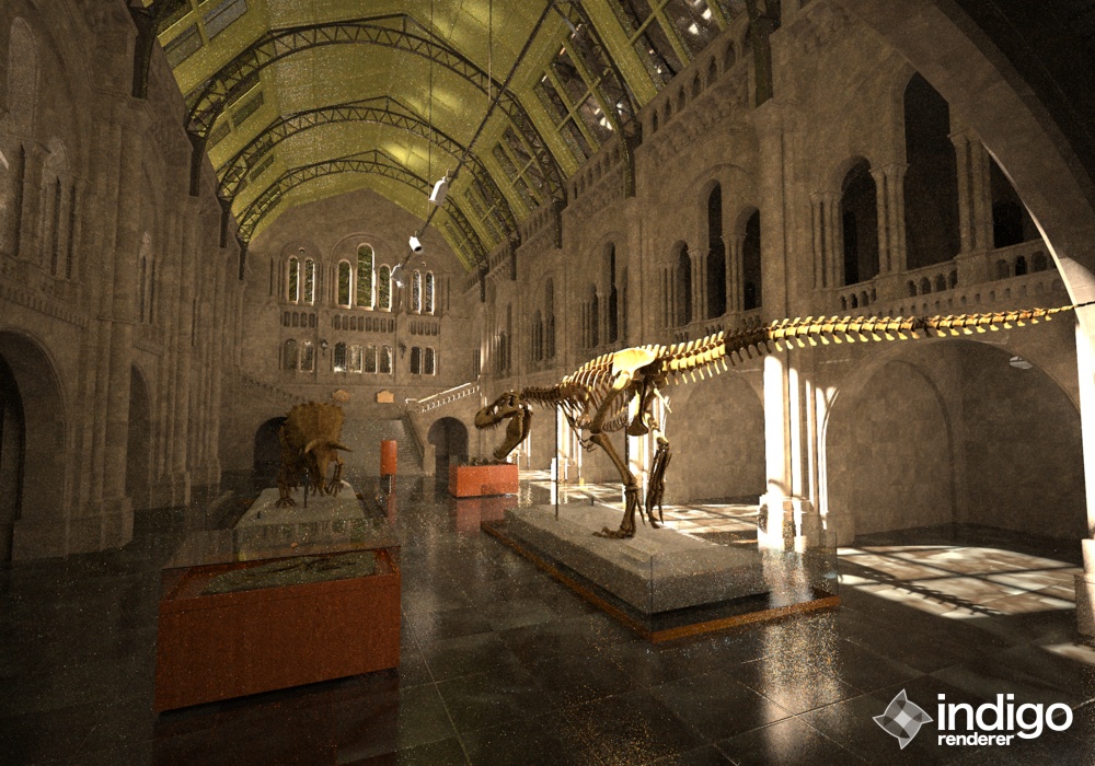

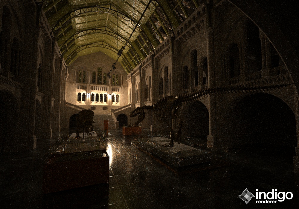

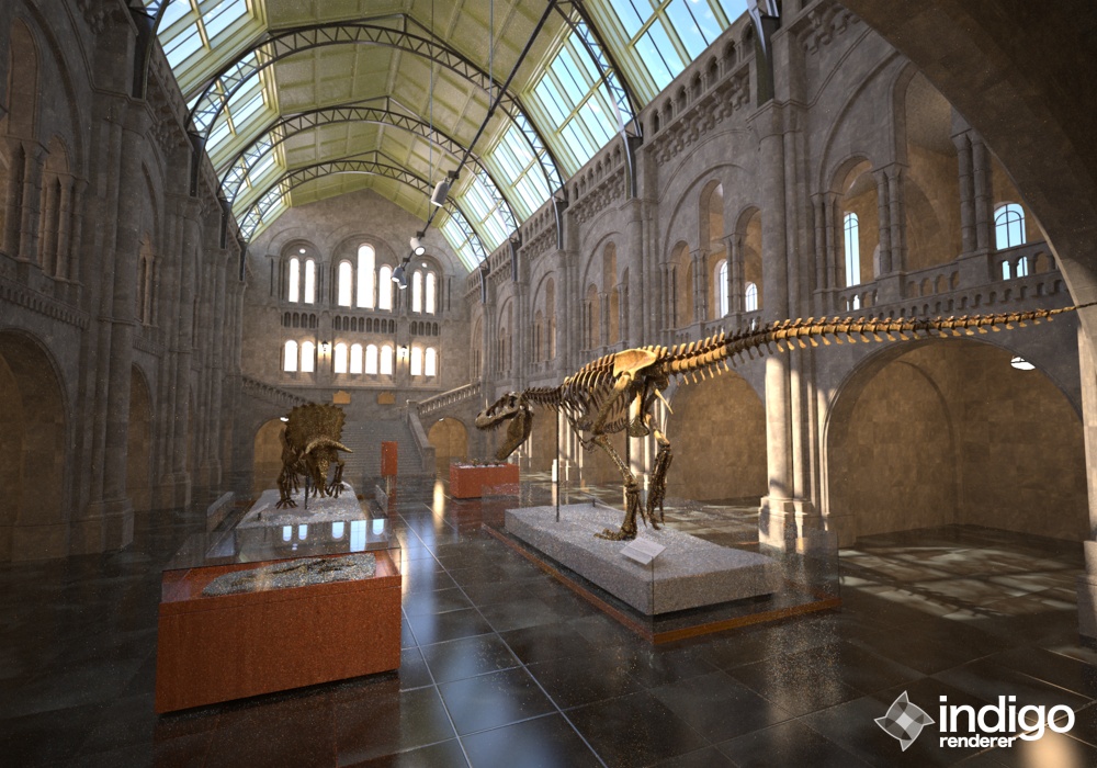

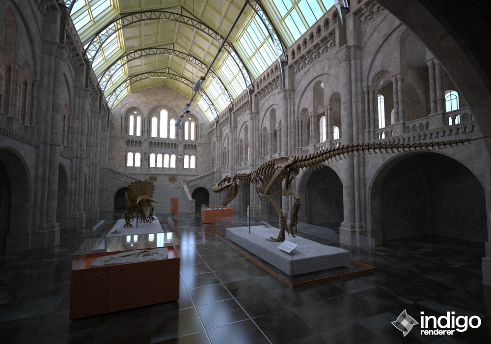

Alright, alright. I'm going to post several images to illustrate what I'm on about. I didn't model this scene - it's from 3dRender.com, one of their lighting challenges. I merely textured and lit the scene:Pibuz wrote:HEY FORGE!
WHY THE HELL DON'T YOU POST AN IMAGE?!?!
..guessing is becoming way to difficult to me..
First of all, these images are after 37 hours of rendering, SPP of 21496 (so far). The sky light layer is the largest contributor of light to the scene, and has rendered the most completely of all the light layers. Note that the interior of the display case on the left foreground is clearly rendered with no dots, and the reflections on the floor are all smooth. The sun light layer is the brightest direct light in the scene. Because the sun itself is a small 'target' for the MLT routine, it has not cleared yet. Note the grainy reflection on the floor on the right side, and some of the direct light is still invisible through the glass of the T-Rex display case. It will eventually appear after a very long time of rendering. The spotlights are small disc area lights with an IES profile, placed partway up into the spotlight cannister. These are very small 'targets' for MLT and don't get very much sampling. Hence, the layer is basically a collection of randomly scattered point samples. This will take a VERY long time to clear. The globe lights are several (I think around 40 or so) small spherical light sources placed inside of transmissive light fixtures. This layer has not cleared completely in the floor reflections (as seen to the left side of the T-Rex display, or inside the display case on the right. The carriage lights are two small cylindrical light sources inside of glassed-in carriage light frames. They are also very small 'targets' for MLT to hit, and have not fully cleared at all. However, they do seem to have sampled better than the spotlights. All of the layers in balance with each other. Overall the image looks fairly clear, mainly due to the clarity of the sky layer. The stippling seen in the display case on the left, or the reflections in the floor on the right, are due to the contributions of the under-sampled spotlight and sun layers mostly.
That's it for this experiment, however. Annoyingly, Indigo crashed out on me as I was saving these images. My next experiment will be to render the spotlights without any other of the light sources and see how long they clear on their own.
