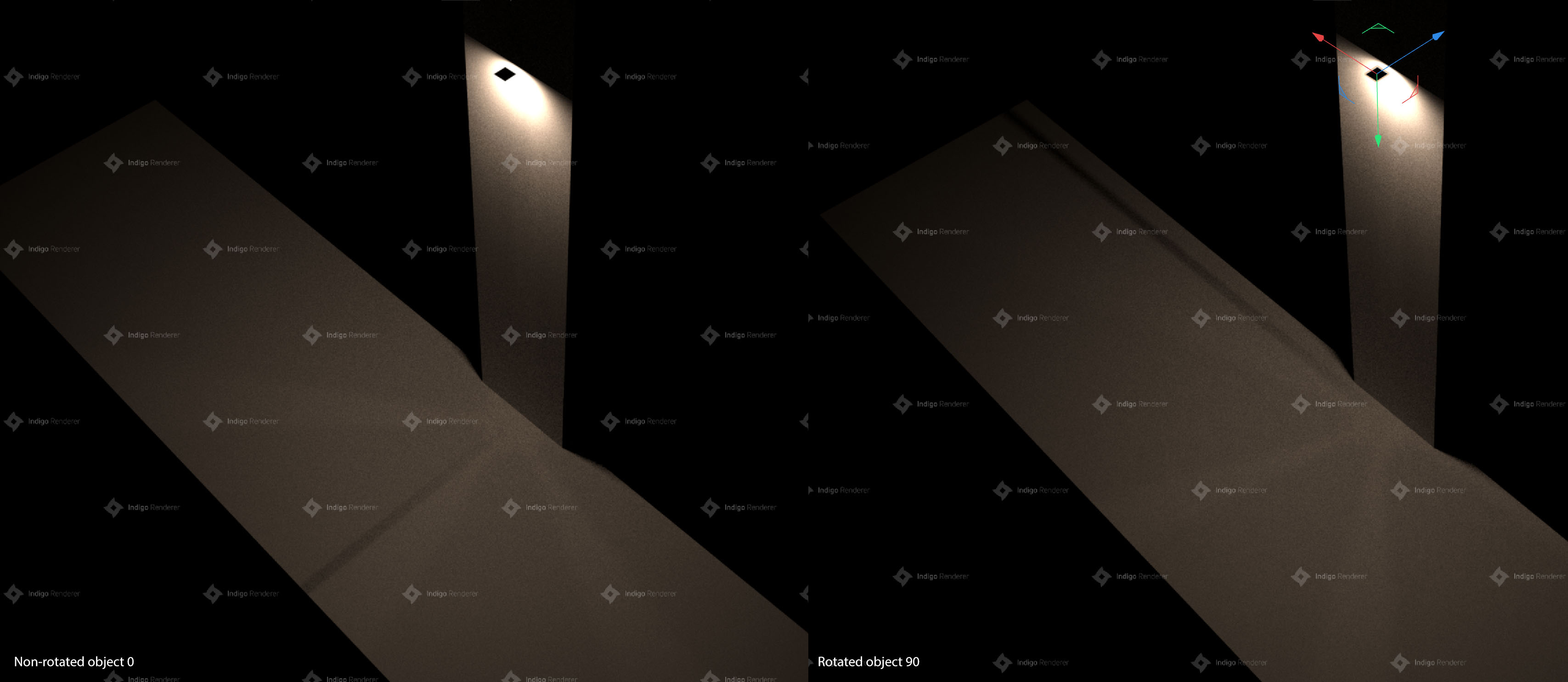

As for the IES profiles, I was able to change the direction of the spread by simply rotating the emitter object. Bear in mind that this way of controlling the direction of the spread only applies to the angels 0 and 90, meaning that you can change the direction only North-South, or East-West, without incremental values in between. I will go ahead and check some other ways of doing this, possibly by using 3rd party software (like IESViewer), but I'm not getting my hopes up.
As for the record, I'm not using 3ds Max, but Cinema 4D, not sure if that makes any difference. Anyway, try rotating your object 90 degrees, not 89, because that's the switching point.

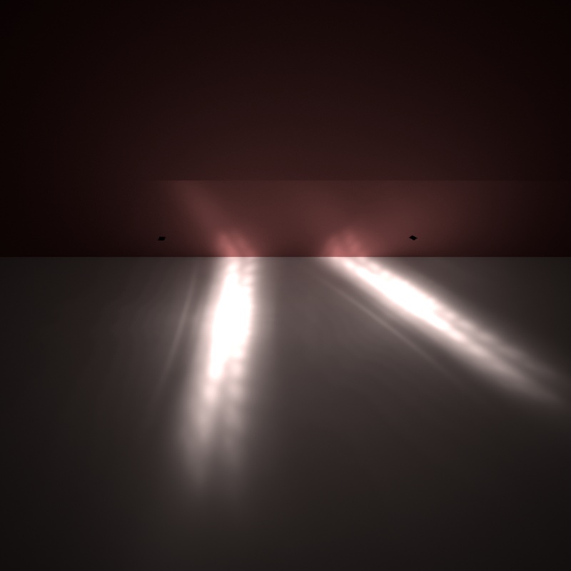

This is a limitation of Indigo, which I'm just working on removing. See attached render. (Note the rotated emitting quads)
In the render below the directional basis for the IES emission is based on the surface normal, and the UV mapping. (e.g. the IES is oriented in the direction of increasing u coordinate)
