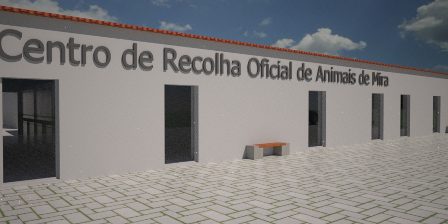

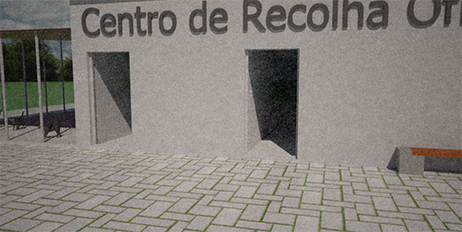

Hi. Thanks everyone for the tips, but still not working.
Here some files

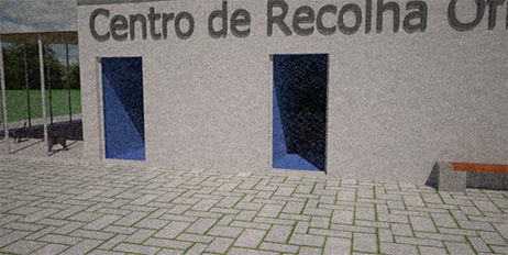

Ok, so here is your fix. You should tick the arch glass and Single face option in the material option. After you do that, change the rendering mode to MLT or anything else, it will "update" the scene and it will render it out correctly. The reason why your window material renders black is because of your model, that has no physical thickness. In future, just model your windows like you would make them in real life, or use the above mentioned option.
I've attached an image to make it easier for you to find it. P.S
You can also use absorption in the medium with that option turned on, but be aware that it might act differently when you model your glass surfaces correctly, and you should use it with care, and caution, for a more subtle effect.

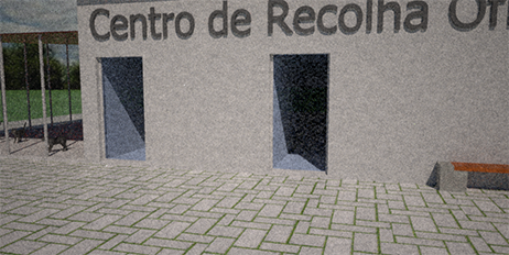

I don't understand, how can you just quit with all these fine advices hanging around...
Just for the demonstration purposes and maybe an inspiration, it can be done, don't give up:
And you can take the .pigs files to dissect it.
https://files.fm/u/htz4r6r3
