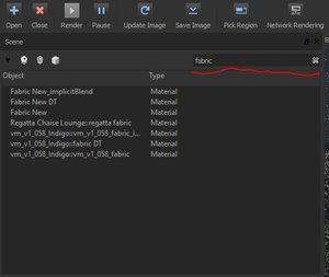

Should be simple enough, but I cannot figure it out.
How to assign a material to the object, which is not directly visible in the scene (it is visible through the mirrored glass only)?
I can roll the camera making it visible, assign and roll it back. Is there a way to assign it directly without rolling the camera?
Using Indigo RT 4.2
Thanks.

easiest will be editing the aplied material from the scene grapth, search for the name on the top :)

Yeah, that is another way of doing it... But I was hopping for a single click :D
And there should be, like selecting existed material (through the search like you have shown), and then ability to open/import a material with immediate replacement.
