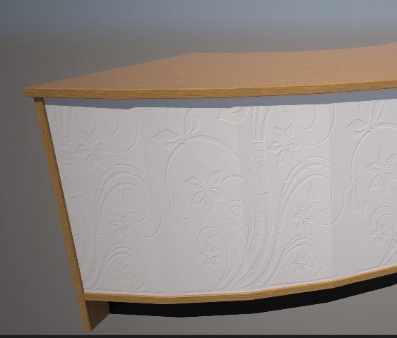

There's probably a simple answer to this, but I can't figure it out.
In the Sketchup exporter, I'm overlaying a bump texture on a simple Phong paint colour. What I want to achieve is an "embossed" effect as in the attached. Question though - how on earth do I change the dimension of the bump texture? Not the depth of the effect - I'm talking about the straightforward XY dimensions. How do I make it "larger"? Some pointers on this would be appreciated.
Once I've figured this out, the next step is the rotation of the map... Any ideas?
Thanks folks

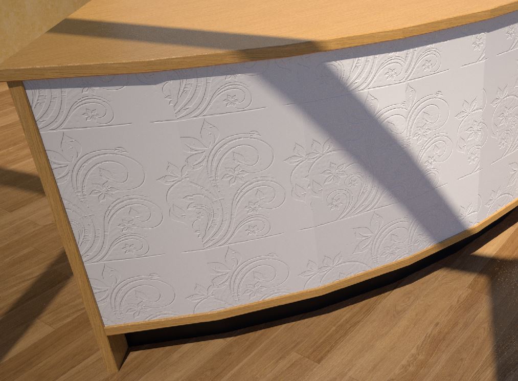

Hi Ono - the issue with Sketchup is that the "colours" don't function as textures, ie you can't scale or rotate them.
Pibuz - many thanks for those instructions, they seem to almost work - I'll have another go and let you know. The bump map doesn't quite follow the re-sized texture, but it does change... A challenge!

Post by nmeau » Thu Sep 21, 2017 9:13 pm
Yup - nailed it, thanks champ.I plan to use this to add subtle defects to plaster walls etc - endless applications :-)
