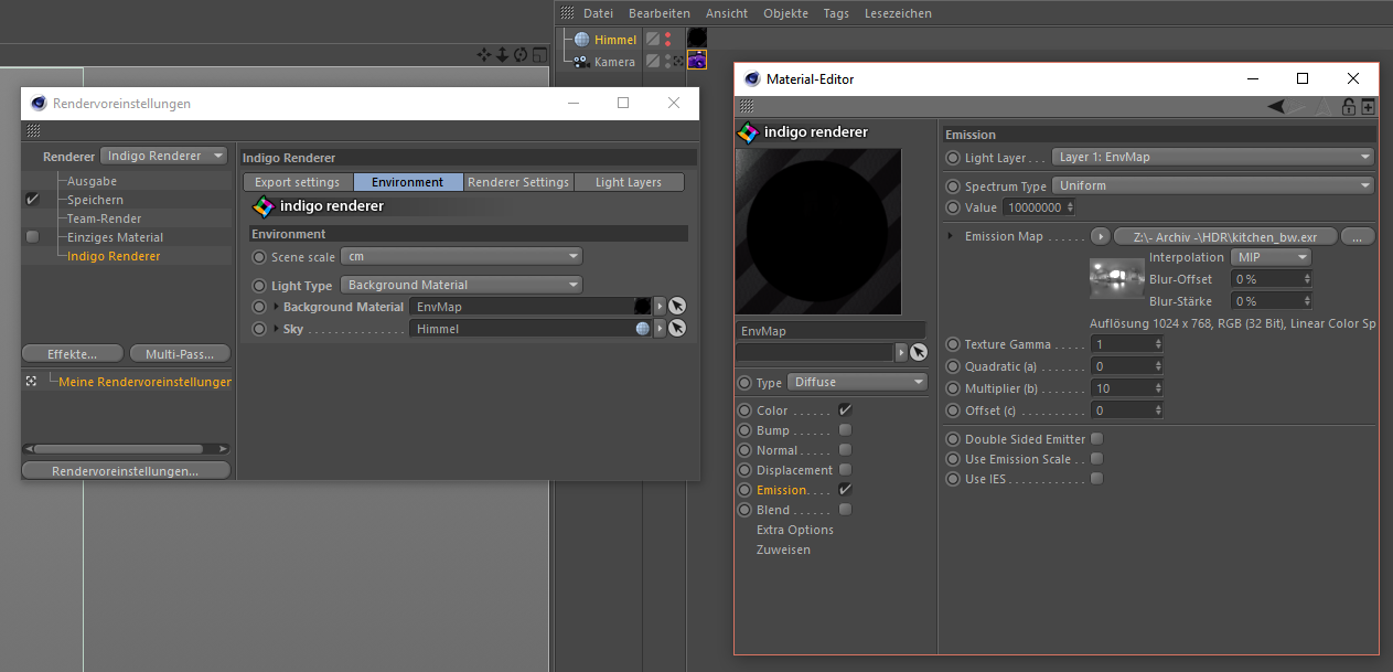

You again used a JPG as a environmental map to light the scene :roll:
Here a example of how to setup HDRI light in C4D for Indigo:
HDRIs need to use a gamma of 1.0 that can be raised slightly for more contrast and harder shadows to lets say 1.2.

Zom-B wrote:You again used a JPG as a environmental map to light the scene :roll:
Okay so no Filters or anything, just the pure .hdr. I had the hdr with a filter because it appeared too bright, now I got only the .hdr in it and it looks fine :)
