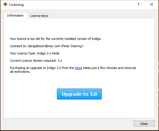

Post by Headroom » Tue Dec 29, 2015 9:24 am
I have figured out part of the problem. The node licenses are Indigo version 2.xx These would need to be updated to Indigo 3.xx
At the moment it looks like that's a paid upgrade and thats not going to happen.

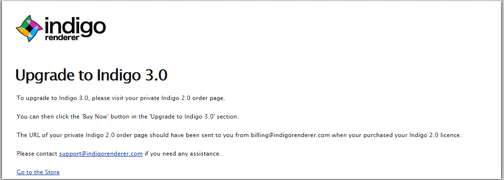

I can only see that the node version needs to be updated on the slave machine. There I can click on the only user interface element, the big blue button labeled "Upgrade to 3.0".
This brings up the browser on the slave machine with a web page that instructs me to visit my private Indigo order page. It says I can then click the "Buy Now" button in the "Upgrade to Indigo 3" section.
Ok, so I walk back to my main machine, search and find the mail agin and click on that link again.
And, indicative of the whole process, there is no "Upgrade to Indigo 3" section, thus there is no "Buy now" button. So I have to admit being a bit irritated at the moment.
