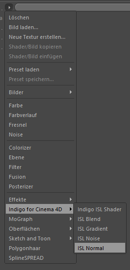

Post by Zom-B » Sun Aug 23, 2015 6:53 am
Check the integrated ISL Normal Shader:

Zom-B wrote:Check the integrated ISL Normal Shader:
Hi Zom-B,
thanks a lot for this hint.
Actually I tried that shader. But it gave ne not the results I was looking for.
At least when using it in the diffuse channel it returned results that did not match the black to white graditent.
I just made a test where I used it in an emitter slot. There it seems to work fine.
P.s. if you are wondering why I have a mirror in the scene. I also check if the effect is right for rays that are not coming directly from the camera. This somethinges is not the case.
Ok as this shader seems to be a good solution for my needs now to the next question:
Can I somehow alter the results... gamma curve them or tweak them?
Also would be nice to see how the code of the ISL normal shader looks like :-)

Silverwing wrote:Actually I tried that shader. But it gave me not the results I was looking for.
At least when using it in the diffuse channel it returned results that did not match the black to white gradient.
Silverwing wrote:P.s. if you are wondering why I have a mirror in the scene. I also check if the effect is right for rays that are not coming directly from the camera. This somethinges is not the case.
Thats the beauty of unbiased raytracing, without limited raybounces (well ok... default limit is 10000) ;)
Silverwing wrote:Can I somehow alter the results... gamma curve them or tweak them?
Sadly not directly in that shader, its just a very basic GUI for some ISL code...
Silverwing wrote:Also would be nice to see how the code of the ISL normal shader looks like :-)
All ISL shaders in C4D get exported as ISL code that can be checked out (and tweaked further) in Indigo:
