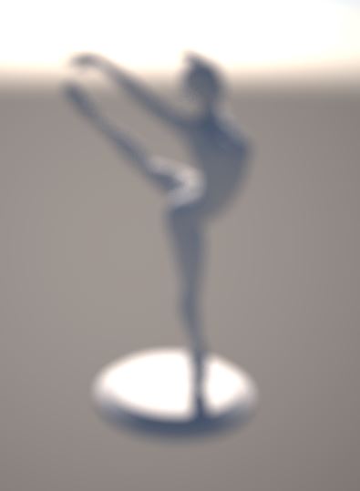

Using Cindigo trying to generate a stupid render of a dancer, I'm sure I'm doing something wrong.
Used C4D material, Pathtracing+GPU acceleration (tested also with MLT with BiDir), Sun light type.
Using Indigo 3.8.26, C4D R16, Win 7 Pro 64 Bit
The result never come to focus, there is no clear convergence waiting more and more, attached an example, any suggestion?

wrong scale?
bad camera setting?
prease share .pigs file
bad camera setting?

I don't think you can, straight from the C4D. But, once exported into Indigo, you can save it there. My guess is that your scale of the scene is too small, double check your project setting, and Indigo Render setting inside C4D. Next stop is your camera setting, if you have one, if you don't have one, Indigo will create one, so check that out too (mainly f-stop, and focus point (turn off automatic, select your figurine). Basically what snorky already said!

As for the focus problem, you should uncheck "autofocus" and pick your focus point where you want the focus to be, and adjust the f-stop to your liking. (8, or 12 would be a good value, it depends on your wishes)

You can check the autofocus in two different places. One is inside C4D, and the other is inside Indigo. In Indigo, on the left side, where your objects, materials, and mediums are listed, you can find Camera object. Click on it, and somewhere in the middle you will find autofocus checkbox. Under that you can manually put in the value of focal distance, or just click on "pick focal distance" and click on your scene where you want it to be. In this scene of yours, it will give a value of 0,1. Inside C4D you need to create a camera object. Then click on it, and add Indigo Camera tag, which can be found in Indigo tags. To set the mentioned focal distance you need to click on the camera and select that arrowy thing and pick the distance, (0.1 value in Indigo, will be 10cm in C4D, if you set cm as your units in the preferences), then click on the newly created indigo camera tag and uncheck "autofocus".

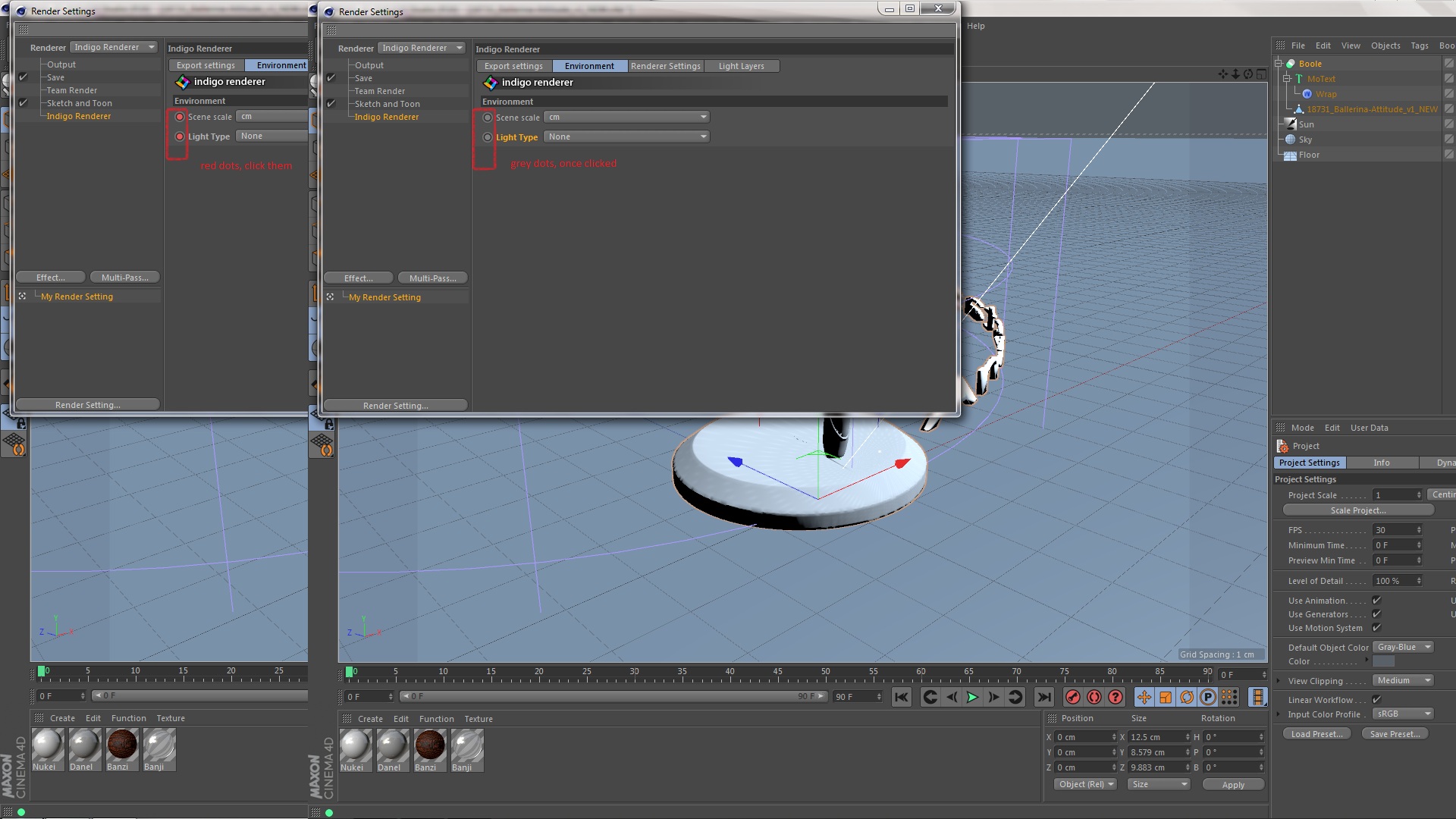

I was just to ask you from where this light source error message was coming
Searching and searching....didn't find where C4D list keyframes.
Not in Timeline or Object Manager....or I0m missing something else?
- thesquirell
- Posts: 428
- Location: Novi Sad, Serbia
Re: Render never focus
I think you just need to click on that red circle until is grey.
Sorry I didn't find any red circle, I was reviewing every single object properties, where exactly did you find them?
- thesquirell
- Posts: 428
Ok that is was I was thinking, confirm I did have all the buttons grayed.
The render still told me ERROR: The scene must contain at least one light source.
This using the Sun or Infinite light.
Using Area light the render start but all is black.
Materials are now all original Indigo.
Standard C4D render produce an output.
