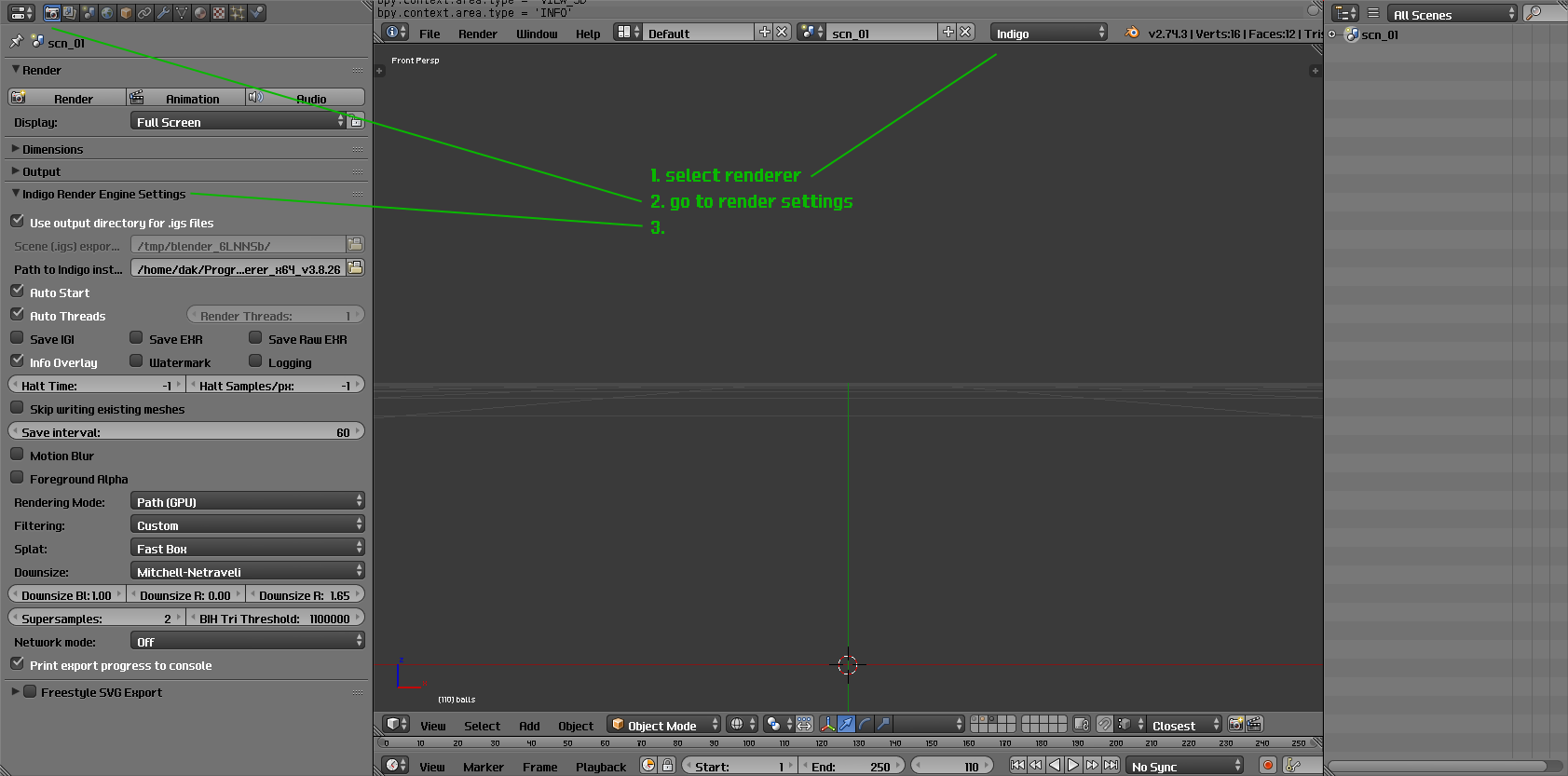

Re: Strange rendering result
davide445 wrote:render options
Found it thanks.
