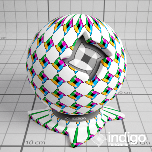

Hi, I think this sort of accomplishes what you are looking for - I have been playing around to get something similar for a while...
http://www.indigorenderer.com/materials/materials/1374
it only wraps the texture nicely around the horizontal circumference and gets more distorted top and bottom (it's basically a cylindrical mapping), but it's a start. it probably works best if you make sure the origin of your object is pretty much centered on its geometry
someone with better understanding of the math can probably make this repeat seamlessly and maybe even project more like spherical coordinates, but I haven't figured those things out yet.

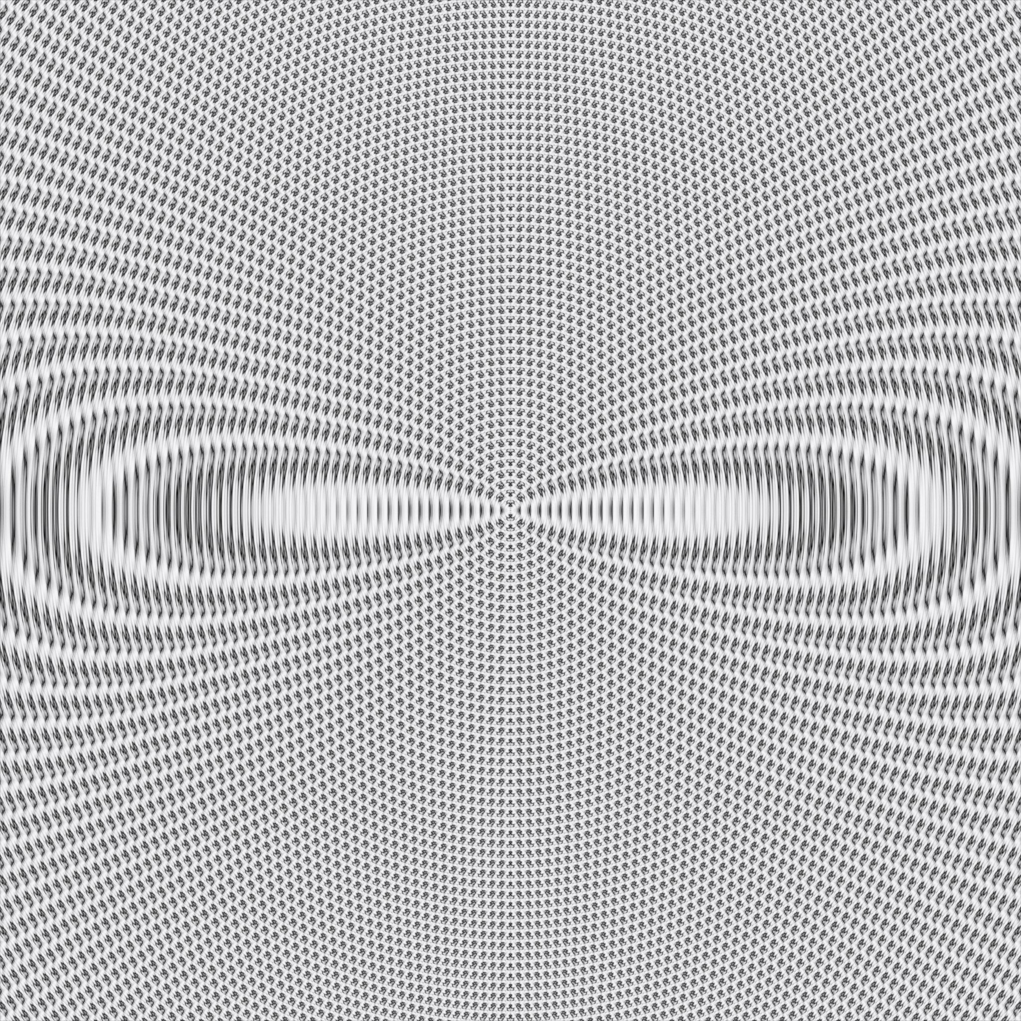

Hey I have been trying to figure out the maths for a radial ramp but I am not familiar enough with the vector tools.
This is about as close as I could get:
