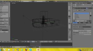

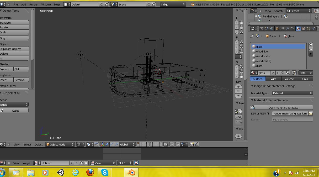

so im creating my dream house, a squrae room with a beautifal half circle end to it, also with a glass rectangle through the roof, holding bamboo on mossy rock,

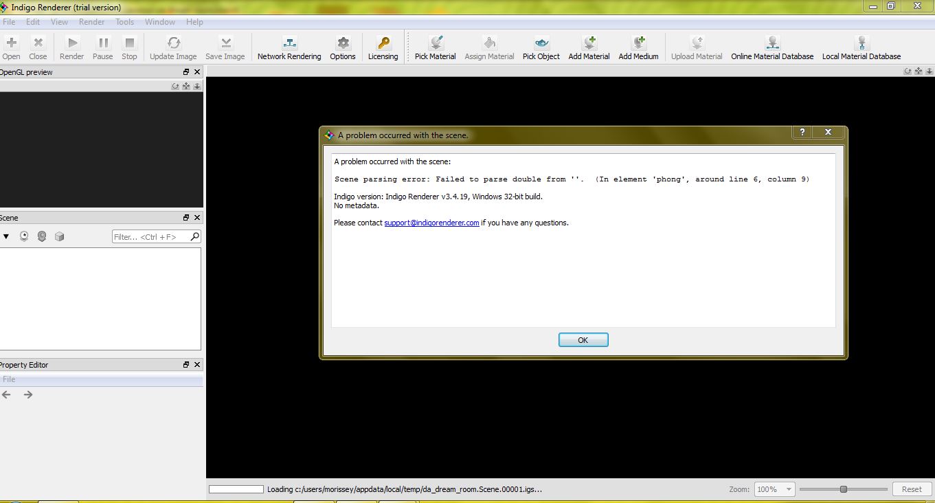

but it wont load the some phong materials, it says failed to parse double (line6 column ffive) or someting lke that
i uvd every mesh, well i uvd the places i had to put materials on

What Blendigo version are you using with which Indigo version ?
Current Indigo beta is 3.6.18 which works with Blendigo 3.6.17.
The Indigo in the screenshot is 3.4.x Stable and you would need the 3.4.(don't know right now) Stable with it.

That would be an incorrect assessment.
The screenshot states that is in element phong, which is a material setting.
If you want help, you'd do well answering questions from users that likely have more experience with Indigo and it's do's and don'ts. Probably more with the dont', thats how you learn

You cannot really use Blendigo 2.4x as that does not exist. So lets start from scratch.
Unless you are a Computer Graphics professional and/or you are already owning an Indigo "3.4.x Stable" license, I would suggest you work with the latest Indigo Beta version 3.6.18 http://www.indigorenderer.com/forum/vie ... =1&t=12491
While they are Beta versions they are incredibly stable IMHO.
To use the Inigo 3.6.18 Beta functionality you need Blendigo 3.6.17
http://www.indigorenderer.com/forum/vie ... 64#p123464
Blendigo 3.6.17 will work with Blender 2.64 or higher. I currently work with Blender 2.65 without problems and would believe when Blender 2.8 comes out soon it will also likely work with it.
