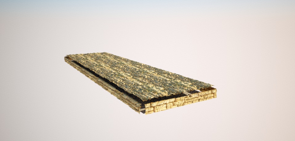

Whenever I try using displacement in 3D objects these gaps between the faces appear. Using 8 subdivisions and a displacement of 0.005m. Any ideas what is causing this issue? Thanks for the help, I'm new to Indigo and to the Forum, and my apologies for any english error.
Re: Displacement Issues
Post by CTZn » Mon Dec 17, 2012 1:43 am
Edges marked as hard will no be sewed during displacement. You must set all edges smooth for that.
Then after you could use the "C" parameter of the displacement texture with a negative value to push back the displaced faces while preserving details. It may be labeled "Offset" depending on the exporter you are using.
Post by galinette » Mon Dec 17, 2012 5:06 am
Yes, non-smoothed vertices are exported as different vertices for each face, even if they have the same position. So when displaced along the normal, they will displaced independently, leading to this

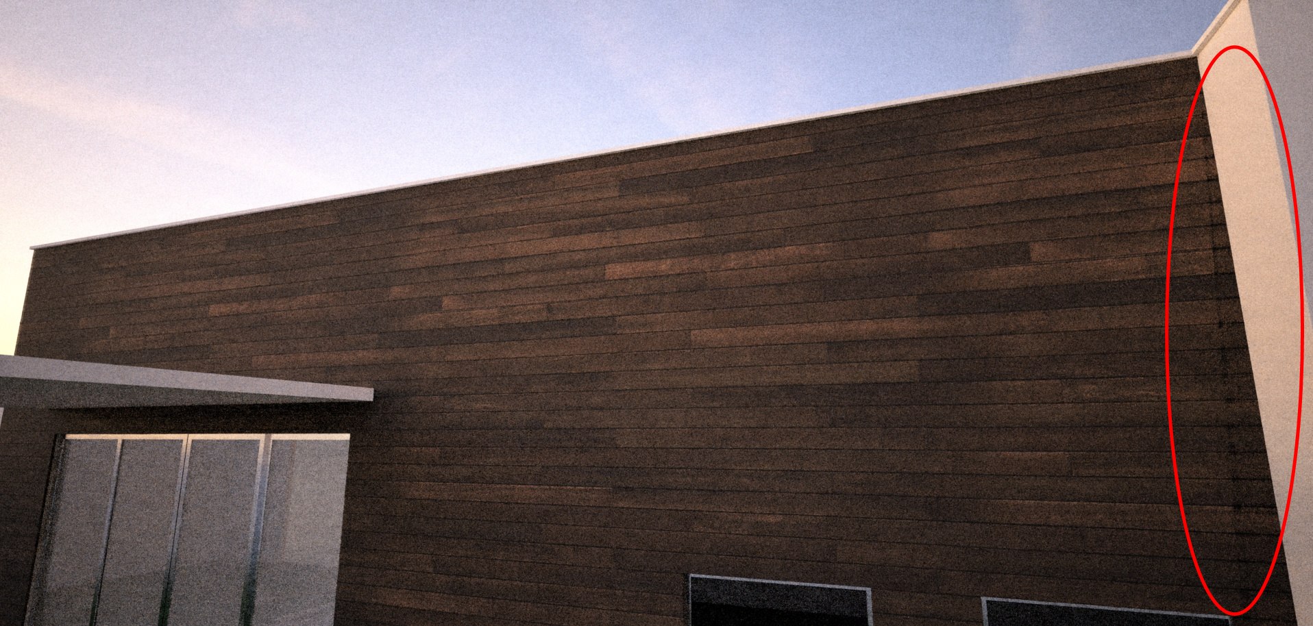

Ok,so I solved the problem with the borders/edges. But another issue appeared.I already checked if all planes got the same texture position and I have already smoothed them (and normals),but there is this another little bug.Any ideas what may be causing this?
CADMonkey
Posts: 22
Joined: Thu Sep 09, 2010 9:45 pm
Location: West Yorkshire
Post by CADMonkey » Mon Dec 17, 2012 4:31 pm
Glad to help.
With regard to the new issue.. It's beyond my knowledge of skindigo at the moment. However. My tip is to only use displacement when you have to. It eats memory. Could you get away with bump for that wall?

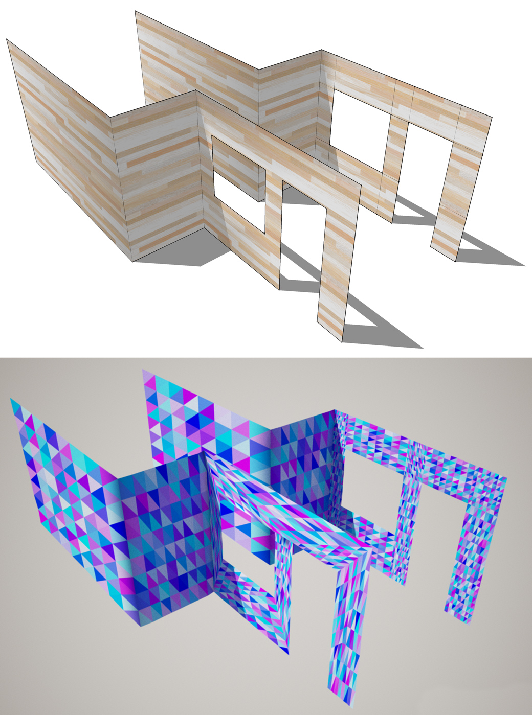

Post by CTZn » Mon Dec 17, 2012 6:35 pm
shiduo wrote:Ok,so I solved the problem with the borders/edges. But another issue appeared.I already checked if all planes got the same texture position and I have already smoothed them (and normals),but there is this another little bug.Any ideas what may be causing this?
It looks like to me that there could be some geometric overlapping happening. Could the wall be folded back over itself (facing backwards) in that region ?
Also check the construcion lines out, Indigo doesn't like thin triangles when it comes to bump or displacement. This behavior was improved but it's worth digging your case. A workaround is to redraw construction lines if I'm making sense, being no SU user.
Post by CTZn » Mon Dec 17, 2012 7:04 pm
Also the diffuse material has an option called "Random Triangles Color", in the Indigo GUI if not from the exporter.
It is usefull to check on triangles.
cotty
Posts: 314
Post by cotty » Mon Dec 17, 2012 7:59 pm
CTZn wrote:Also check the construcion lines out, Indigo doesn't like thin triangles when it comes to bump or displacement. This behavior was improved but it's worth digging your case. A workaround is to redraw construction lines if I'm making sense, being no SU user.
Yes. You can force a better subdivision mesh with some extra lines in SketchUp...
Post by CTZn » Mon Dec 17, 2012 8:34 pm
Thanks Cotty, it's a nice illustration.
You might want to submit the image to Whaat for documentation concerns. Assuming that the issue was not documented already.
PS: I'm amazed on how SU is not accounting the added vertices to the wall wich is back to the light, keeping it with 4 vertices.

Post by shiduo » Tue Dec 18, 2012 2:15 pm
I tried what you told and it solved my problem! I really appreciate all the help you've given me
