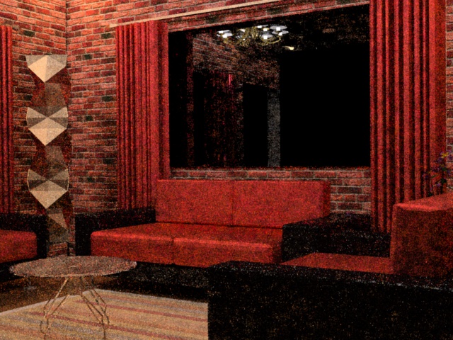

Hi All,
i start to use indigo since two month. i have a rendered image that have lots of red and yellow fireflies and i dont know exactly how to remove them.
i used single color black and path tracing as render mode.
i would like to render the scene in night and light it with mesh lights (bulbs)
the glass in the scene is only a single surface and i used specular shader.

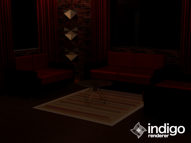

i did another experiment i used camera dscs315_5 and i put iso 600 and EV 5.5.
In Fact i dont know how to use each response funstion?
the photo rendered 15 hours on core 2 quad 2.40ghz, 4GB Ram, nvidia 9600gt
the image look too dark but at least there is no fireflies.
Again i would like to render the scen in the night. So how can i get nice effect for the sky in the night through the winow?
Note: this model from 3d warehouse i download it to make some experiment with the light

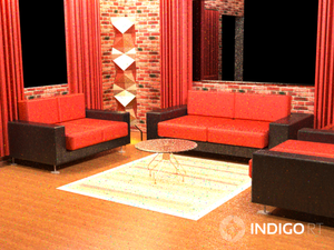

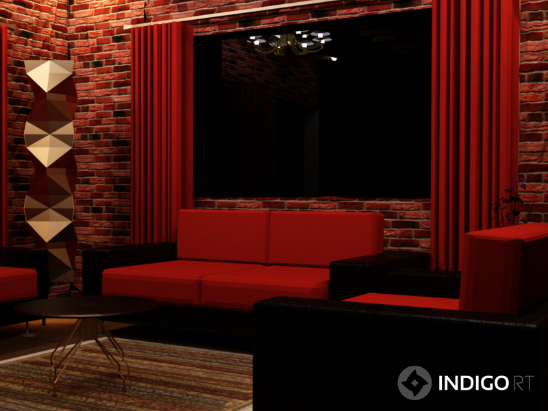

here is a 1min (!!!) rendering of the scene (with changed camera position) after performing the changes above:
Since you seem to be a beginner, check out Indigo Documentation for the material types and play with them.
Instead of just using materials from the MaterialDB, try to generate own materials or edit existing ones to get a feeling for Indigos material system. The knowledge of handling materials is very important... for every render engien.
